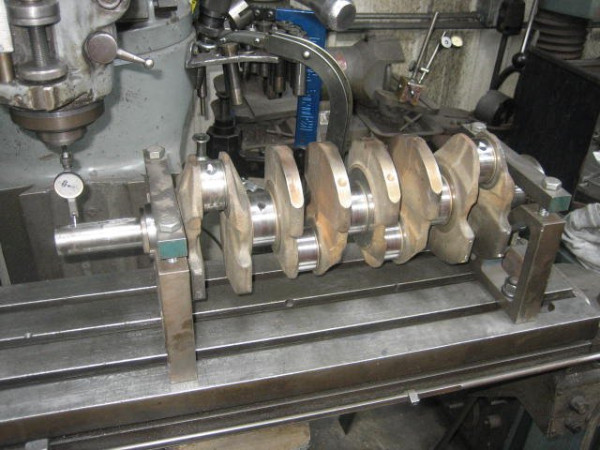

J and M Machine
- Posts: 127
- Joined: Wed Jan 09, 2019 6:46 pm
- Last Name: Gulbankian
- Location: Massachusetts
Re: Milling a woodruff key slot into a crankshaft
Like this. You just have to indicate it.
