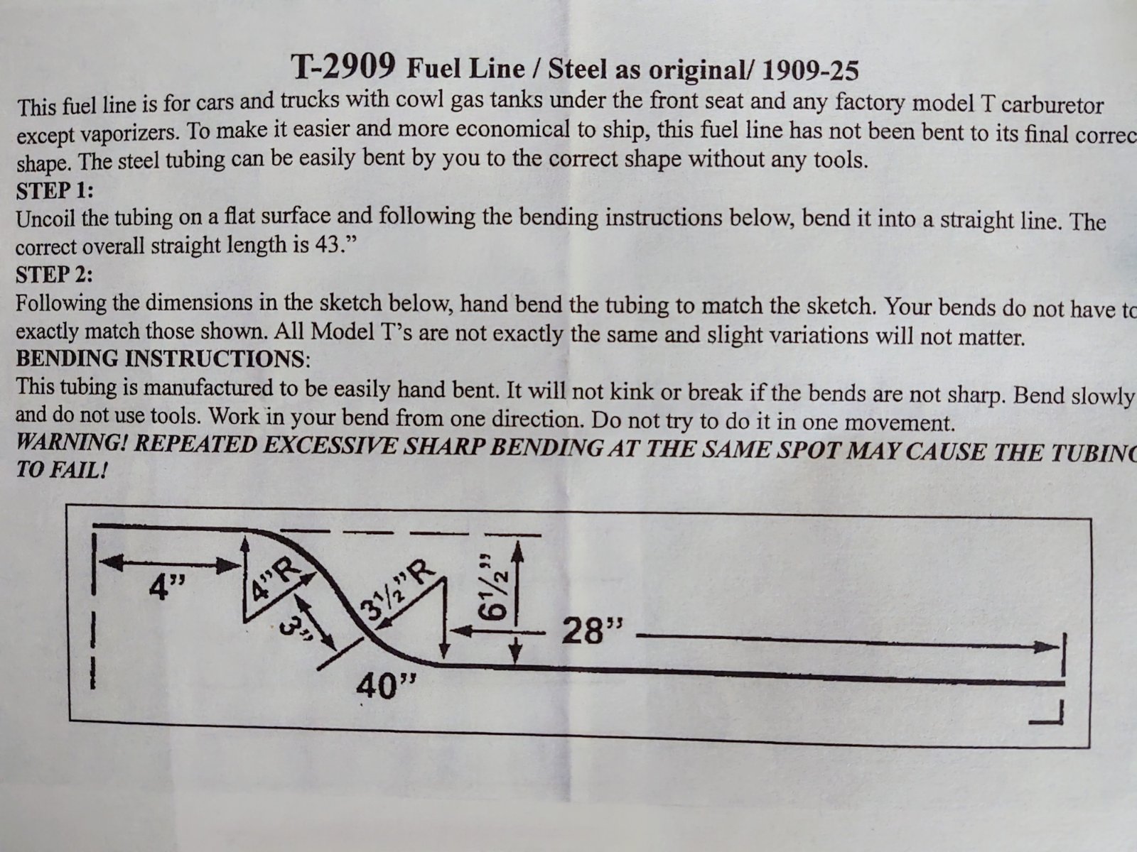

I have made a discovery. As most know, exhaust is hot and copper is good at conducting heat. i looked and the fuel line at one point is only an inch away from the exhaust, so problem spotted. Well a problem, once I get my new belt and I make a heat sheild and insulate the tube as well, I might find more, who knows? Thanks everyone for your replies, but now I think I got the issue

- Posts: 5271
Re: T dieing. Overheating issues.
Your fuel line should be steel. If you use compression fittings on copper, you risk a line shear.
Start over & run a new steel line per factory locations & mounts without high & low spots.

Useful info to replace the gas line from tank to carb.
- Posts: 7305
Even in our summer temperatures in excess of 100 degrees, I have never experienced vapour lock. I do not have experience with the variations in fuel quality you blokes have to deal with though. 1" clearance between the exhaust pipe and fuel line is ample in my experience.
Your fuel line should be steel rather than copper, and it should be fitted with standard T model packing and packnuts. Neither the inlet elbow on the carburetor and the outlet on the under tank fuel bowl are machined to properly form a compression ferule around a copper fuel line.
The diagram posted is helpful, but the route and bends required may well be far different, depending on the orientation of the pumpkin on the tank. If the outlet is further around under the tank, you will need a longer pipe, or you may need to pay attention to the thread on the tank/outlet to change the orientation.
That drawing on how to bend the gas line is confusing to a lot of people.
There is no mention as to which end goes in the sweet potato.
I have always thought it should come straight forward, then bend over in front of the exhaust pipe.
For most year Ts that works fine for me, and you have to cut off about three inches up front.
