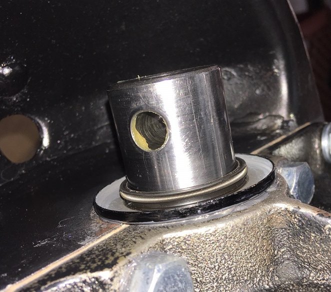

I used a SKF/CR #11777, "backwards" with the lip seal facing forward. With the rim trimmed down to about 1/8" height, it was glued to the front face of the block with Ultra Black and gave just enough clearance from the OEM crank pulley. It can be replaced if necessary, by removing the pulley with no need to remove the pan.

Tom, This improved crank seal Idea that eliminates oil leaks from the front of the engine that drips and blows back covering the rest of the underside was first used and promoted by Orange County and Long Beach T member, Montana 500 Winner Garrett Green!!
There are several different MFG and sizes that will work. It is not required to cut the lip of the seal but you must have clearance. Another way is to use a pair of tin snips and make cuts around the lip and then flatten it out so it looks sort like daisy flower petals. This method provides a very good surface area for the Ultra Black to adhere to the block which sometimes is not perfectly flat.
Chaffins sells a crankshaft modern seal # 3012M. I have used CR seals # 12458 and 11740 among others with No Leaks. I do know one guy that installs this seal inside during engine rebuilds but this makes removing the front cover more difficult and I don't recommend it.
