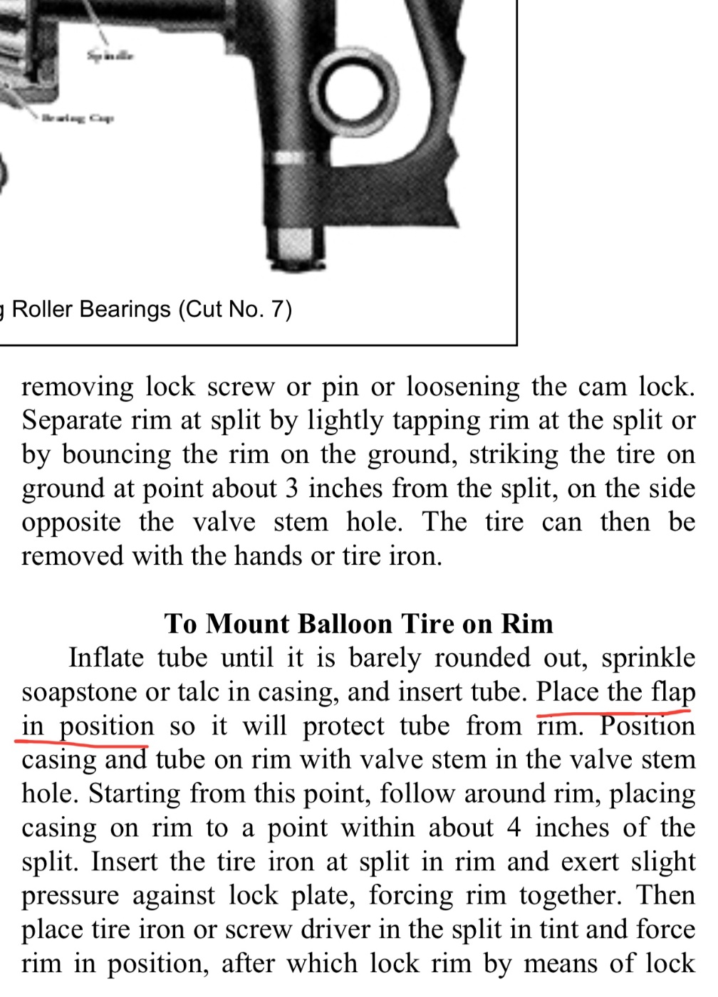

From the 1927 Ford Manual:

Adam's post refers to split rims These do need flaps to protect the tube from damage at the split in the rim.

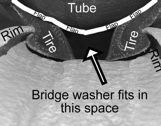

"I also don't like the idea of the tube squeezing down between the edges of the clincher tire from the pressure (60-65 psi) It can't help but wear. The photo shows a cross-section of a clincher tire in a rim. Without the flap I think you'd see the tube bulging down."
I agree and that is why I used flaps (much as I hate them) on my Clinchers. Some old-timers told me the same thing and advised using flaps, even with my new Clincher rims. Flaps can be a bear next time you take the tire off the rim, however. They don't always play nice.

Tim's picture above does a great job of showing why you need flaps (not rim strips) in a clincher tire. Only thing missing in Tim's diagram is what our current tires are shaped like inside- that nice gentle curve in Tim's picture on most new tires is really a sharp 90 degree edge. Those sharp edges will make short work of a tube. You won't know why because the tube will explode once the tire deflates, and the common reaction is to blame the tube.
