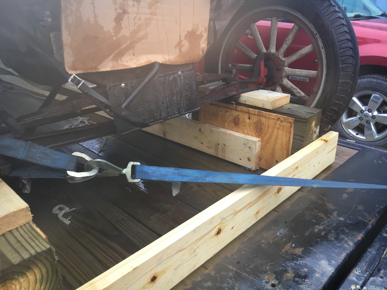

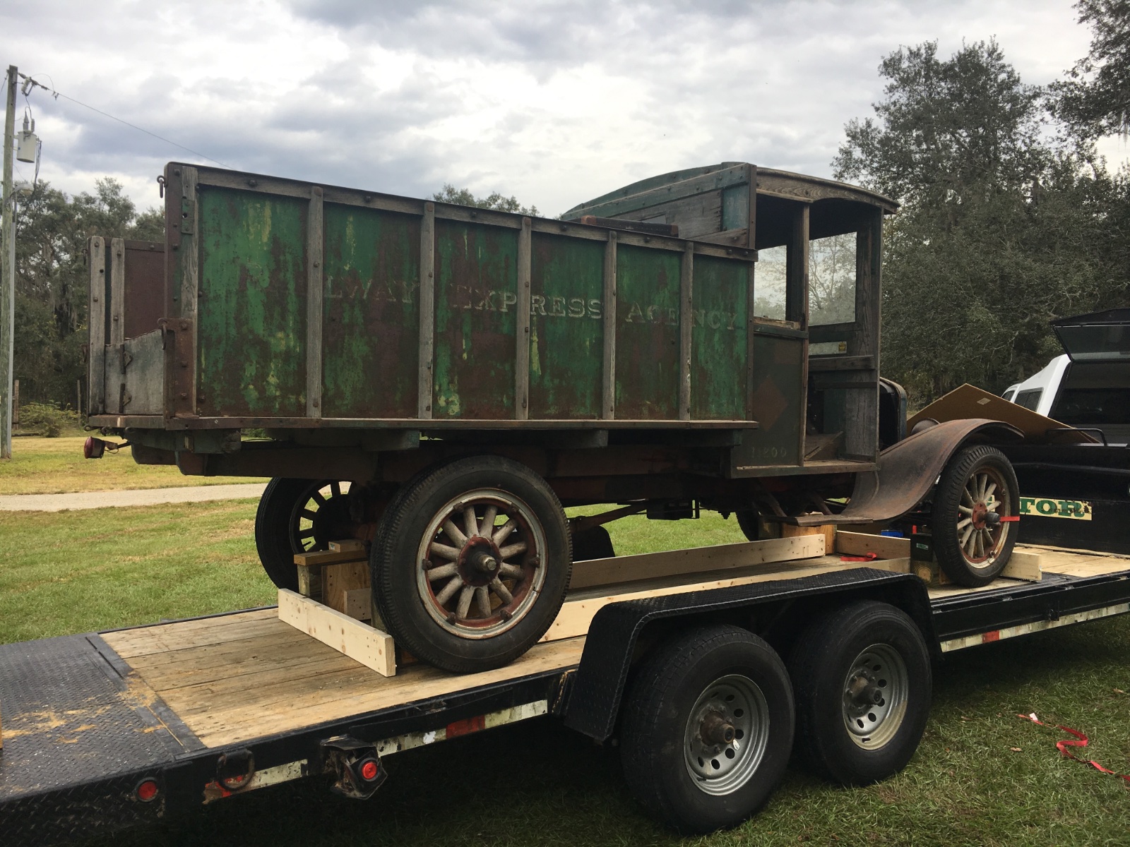

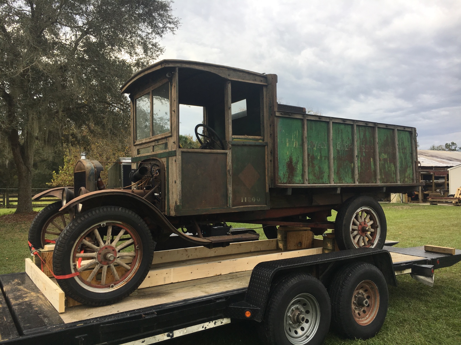

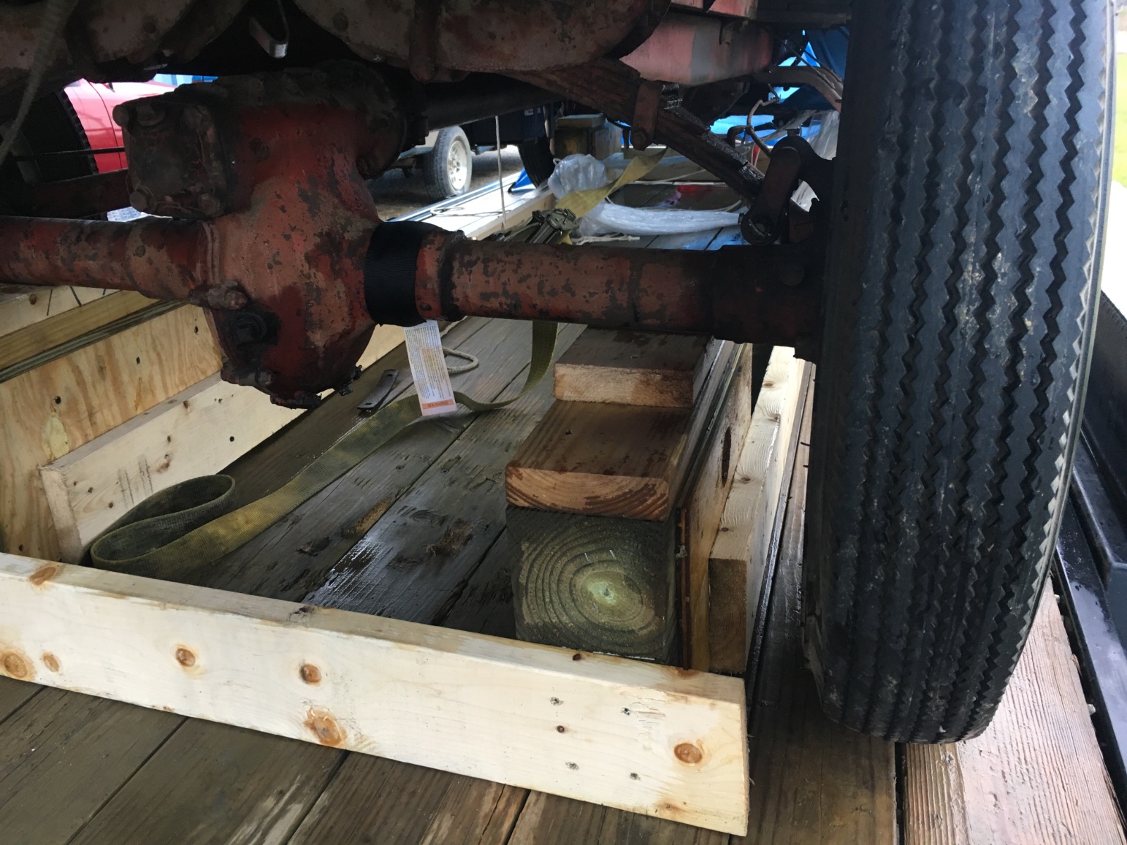

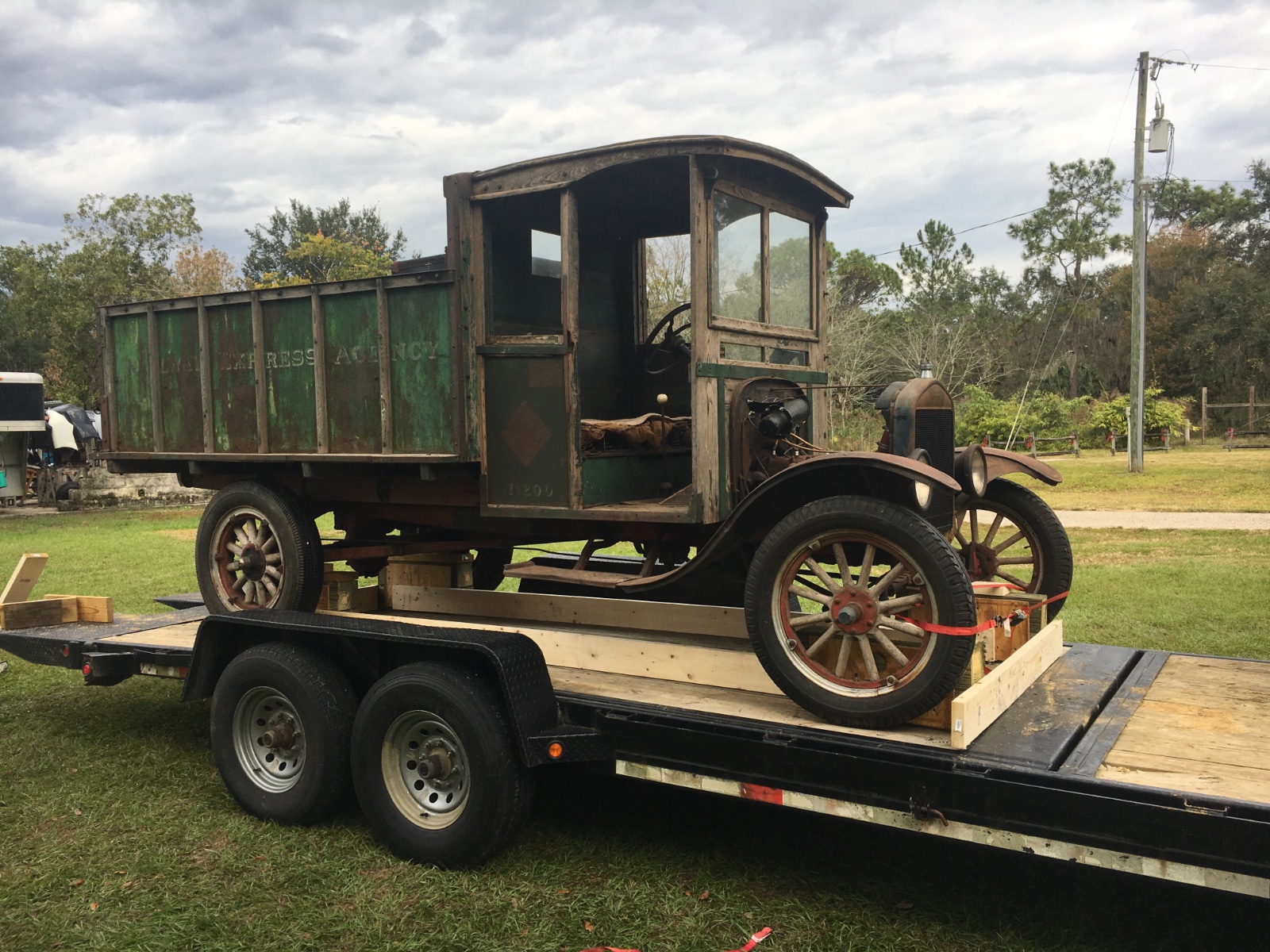

I agree with Brent except I would block it up with cribbing under the axles instead of the frame.

Post by Duane D » Wed Jun 26, 2019 3:22 pm
I hauled mine about 800 miles by cribbing up under the axles. The tires just barely touched the bed of the trailer. We had no problems.
