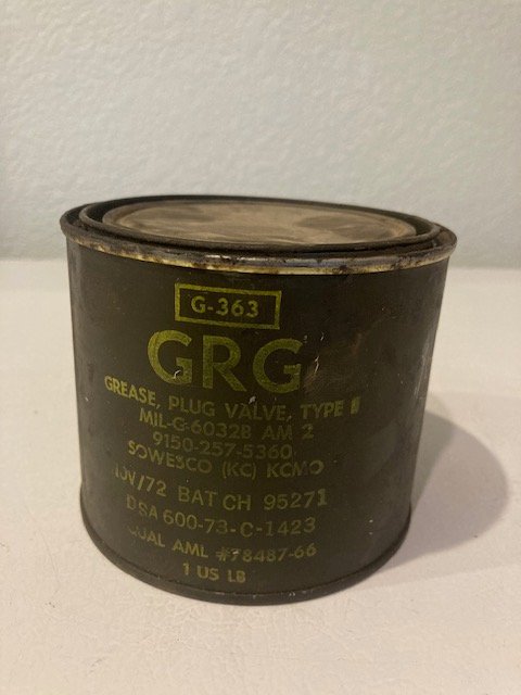

I use timesaver to lap the valve & for lubricant I picked up a can of G-363 military grade plug valve grease. I believe EZ-Turn is the same spec.

I picked up this @ a swap meet it's about 1/3 full I will never use it all up but don't know anyone that repairs valves other than me.
