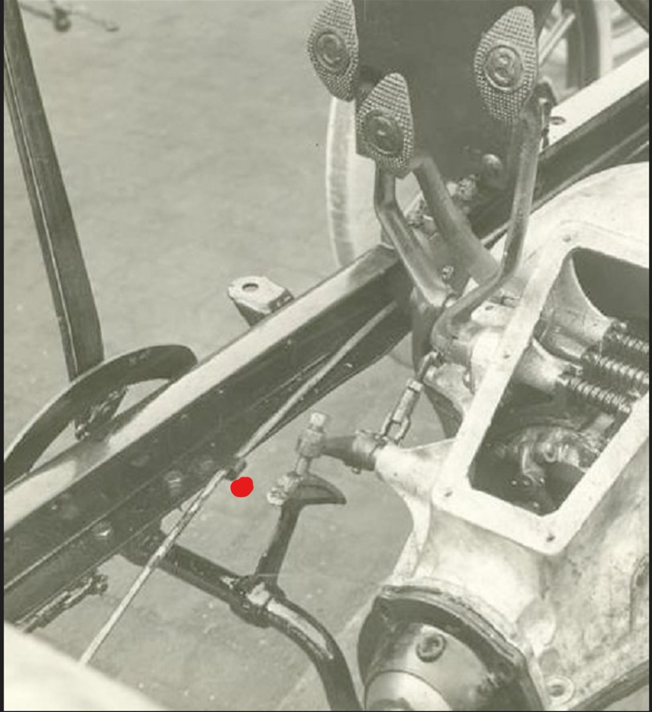

It is called the Rear Gas Line and is 44-inches long. Same size tubing
as radiator cross-over.
Beginning about June/July of 1912, the radiators were supplied
with the crossover piping soldered to the radiator and the brass radiator
shroud punched on each side with a 1/2" hole for the rubber gas hose.
A single clamp is supplied near the rear (red dot) and the tube is placed
inside the left frame rail and pushed through the cut-out of the wood mounting
block forward to near the radiator. Short hose to radiator and hose to generator
or Prest-O-Lite tank. Left splash shields were also 1/2" punched for hose in 1912.

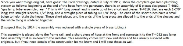

I clipped the discussion we had years ago with RV how the 44-inches was made
up in 1912. I believe I used a 36" piece of tubing from the hardware store with a
sleeve to add 8-inches on my July 1913. My original clamp and cotter pin was still
in the frame rail so I used it.

Re: Gas lind tubing
Rich,
I just looked at my rear gas line and the crankcase support block was notched
on lower inside corner to allow the brass tubing through. The steering block on
mine wasn't notched enough so I just caught it forward of the steering
with the short piece of hose to the radiator piping. Ran it under steering...
Ken

Re: Gas lind tubing
Rich,
Properly positioned (front to back) the 44-inch tube ends about 4" back from
the lower radiator tank so you can connect it with a short piece of hose. It's
set up to be installed from the back.
So after it went through the clamp and the crankcase block into the engine compartment,
I moved it over near the lower edge of the frame rail. Then under and past the steering
bracket several inches toward the radiator along the lower frame rail.
That leaves the rear end in the right position for the hose going through the
splash shield to the generator. Rigid brass so no need for any bends or kinks and
it hasn't moved in many miles of driving.

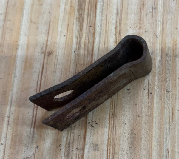

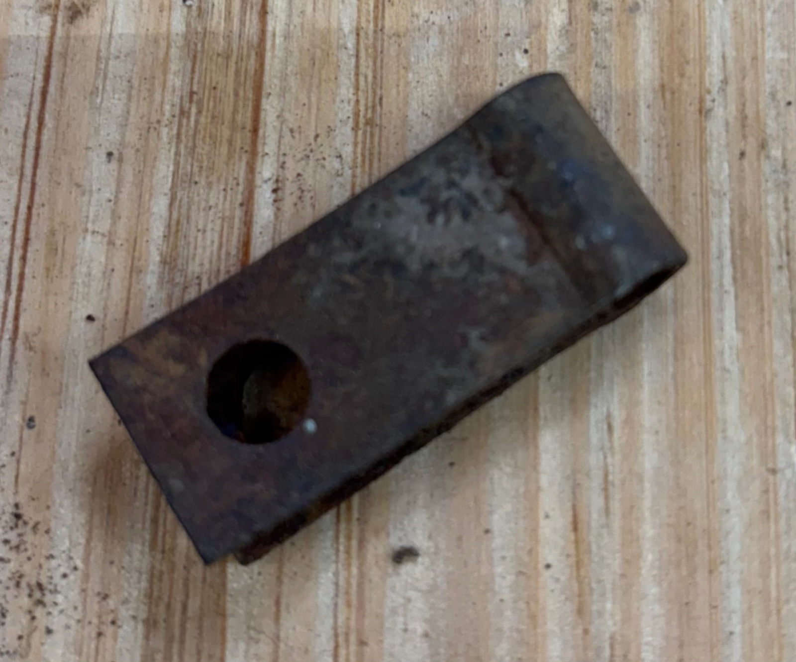

Hey Craig , I have an original gas line clamp if you need one.

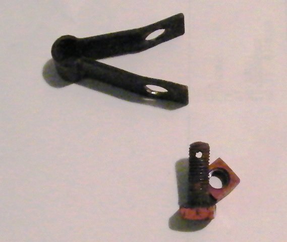

Dennis,
I just made the bracket and the ¼-28 square head drilled bolt and nut. Thank you for the offer.
Craig
Craig
- Posts: 1522
- First Name: Keith
- Last Name: Townsend
- Location: Gresham, Orygun
Re: Gas lind tubing
Craig.
Lessee your bolts and nuts!
