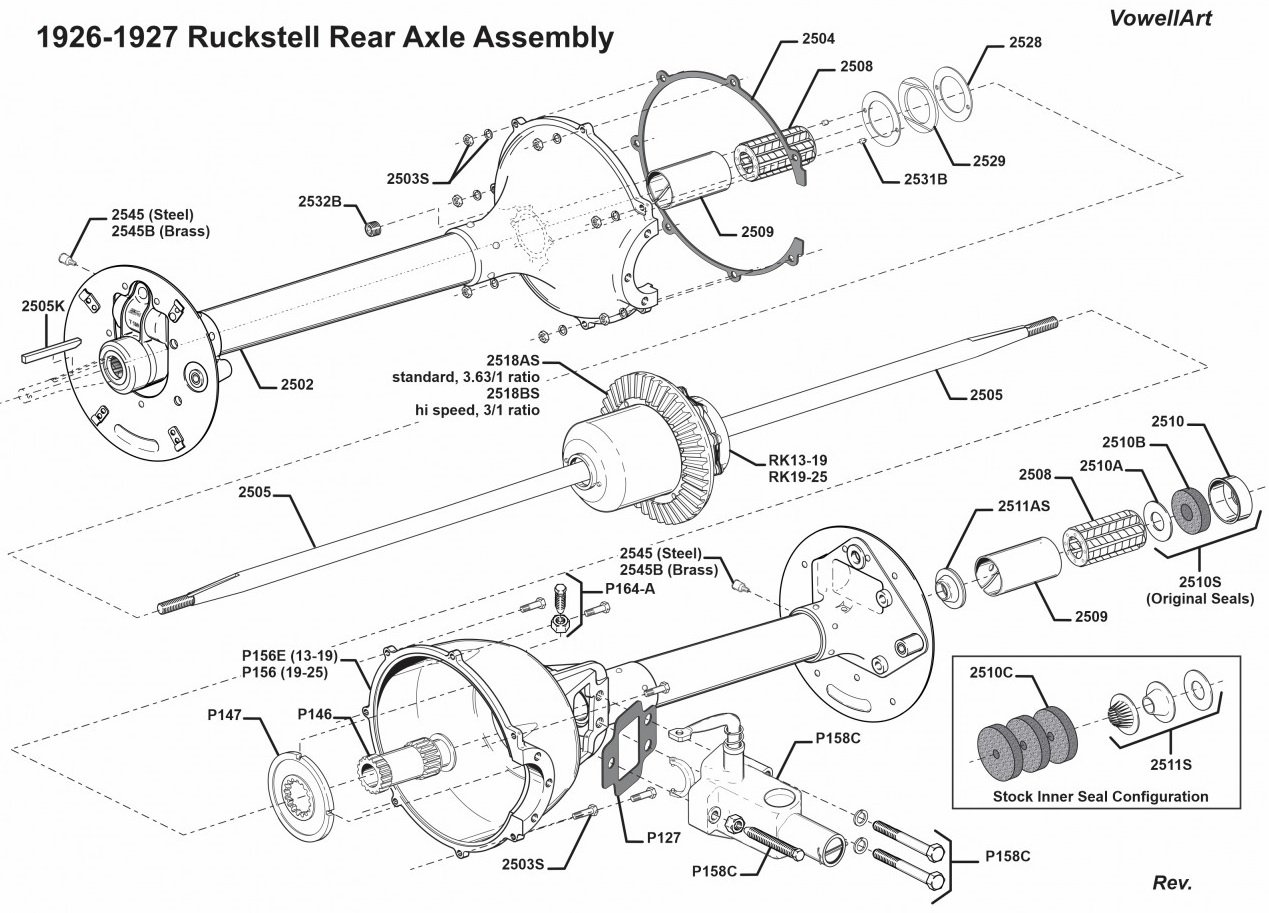

What year Ruxtel? more images here app.php/gallery/album/249
