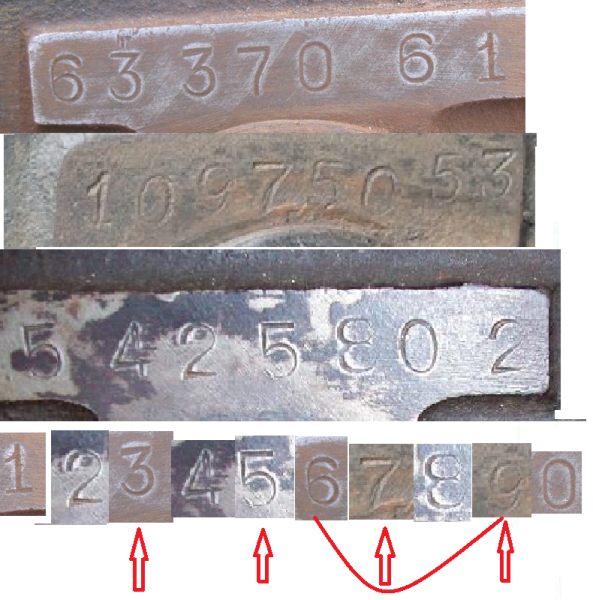

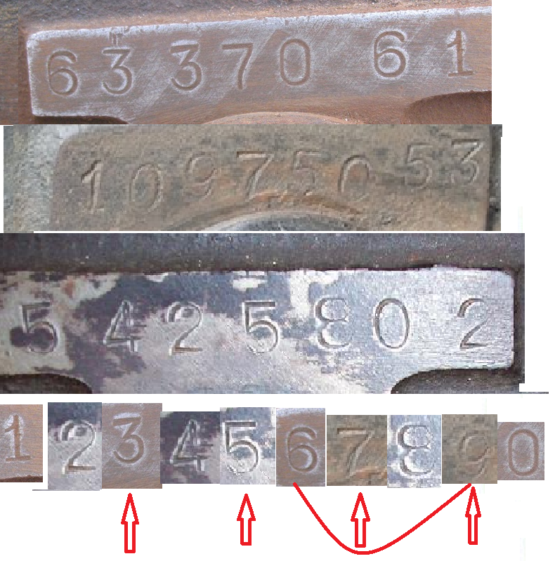

The number style has been discussed. I copied many engine numbers to arrive at a set to match
New number stamps aren't a good match. size maters as well

I have what appears to be the same font ans size punches as shown above. They are close to those stamped on my 26 not nowhere close to those uaed on my 10 and 12. Ive never found anything close.

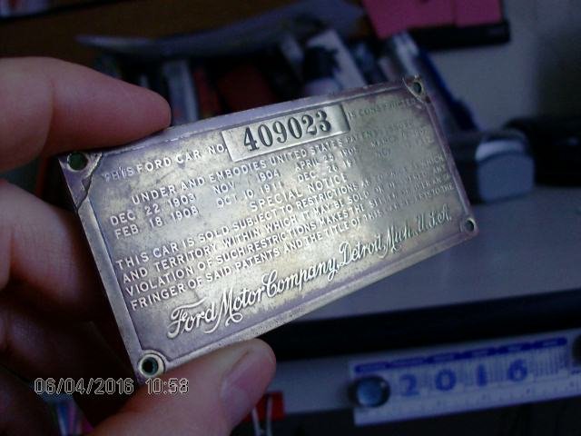

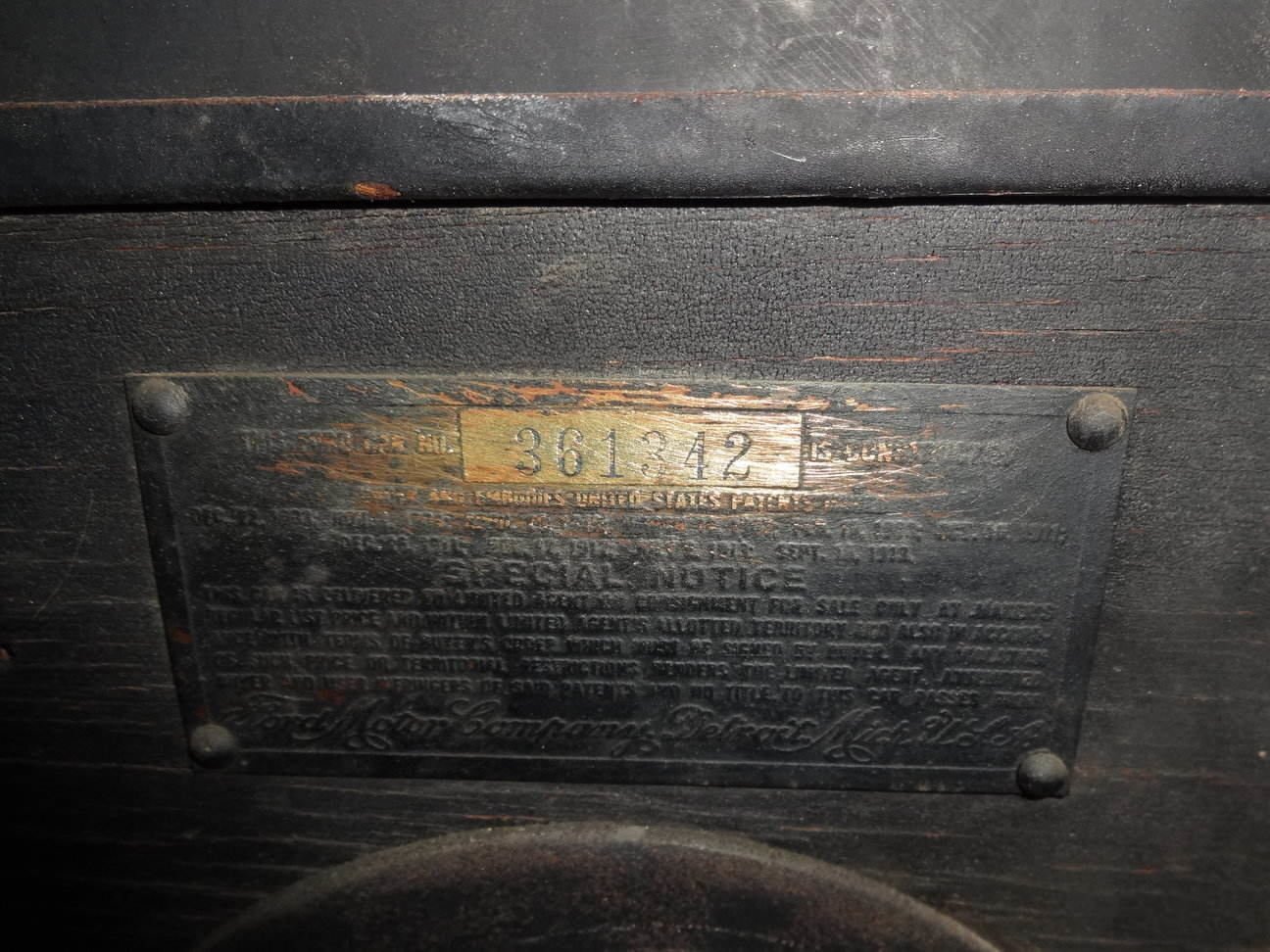

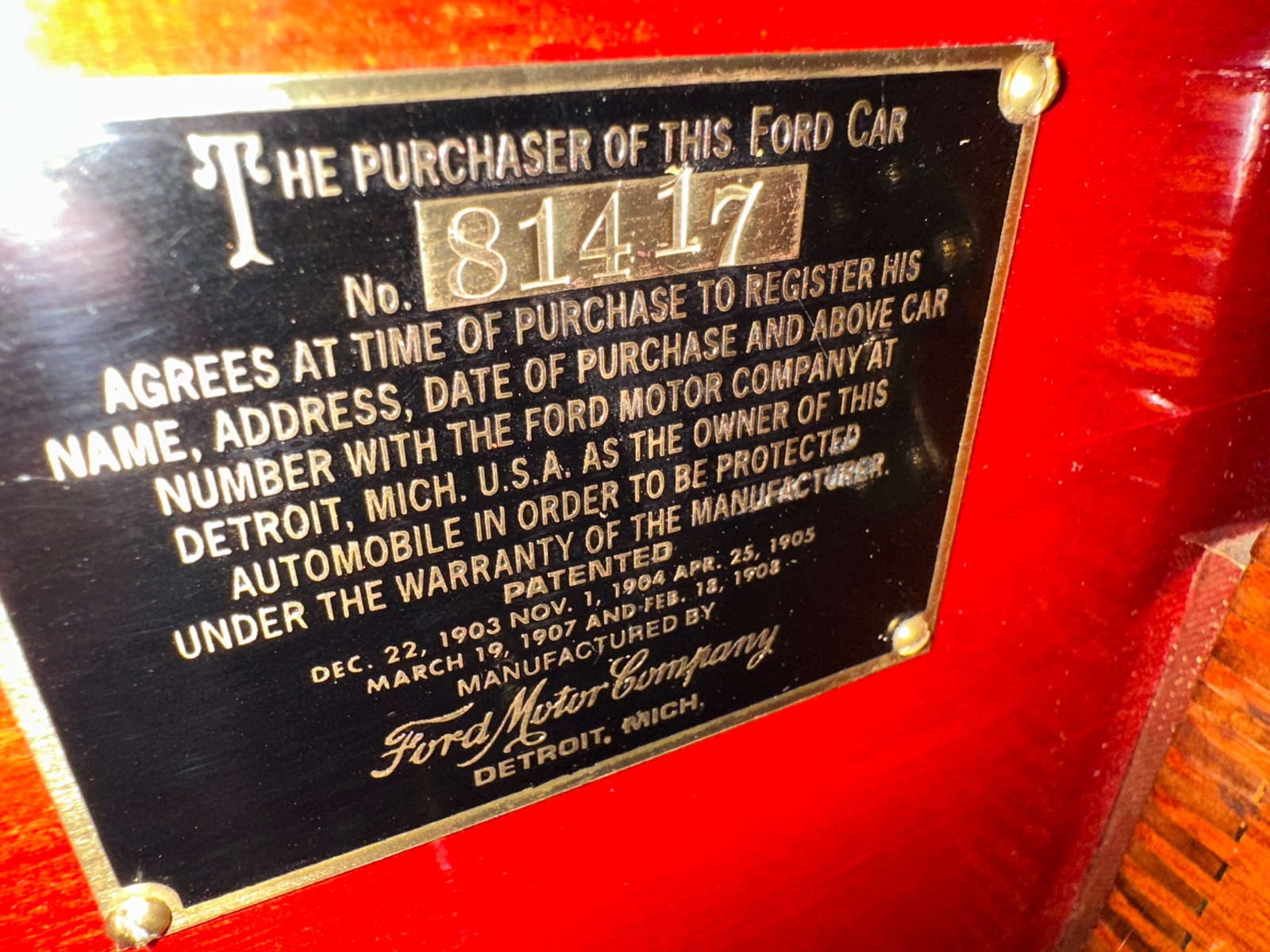

The numbers stamped on the block look nothing like data plate numbers. Here are a couple original data plate pictures from posts on this forum. The new tag is the tag RV Anderson stamped for my 11. Art

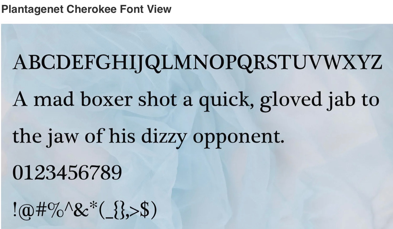

This older post lists a font type numeral that probably is pretty good match for serial numbers on data patent plates.
https://search.app/WN1AkBhS3c12mtLu6
Here is the font type “ Plantagenet Cherokee” for numerals that match closely to original data plates.

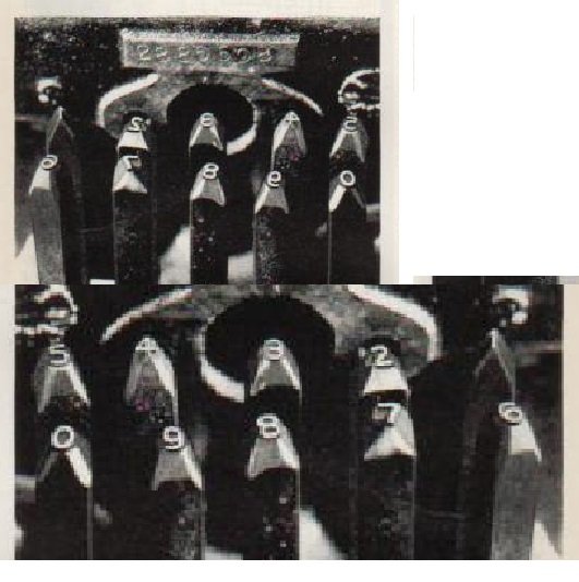

Most original car body plates were brass or aluminium. These are softer and more likely easier to photo etch to "print" the details. It also allows the use of stamps with thicker downstrokes which gives them the old font appearance. Hand stamping numbers rarely have this, especially those used to stamp engine numbers on cast iron. These need a sharp edge to make the impression, not the flat bases as on the ID plates.

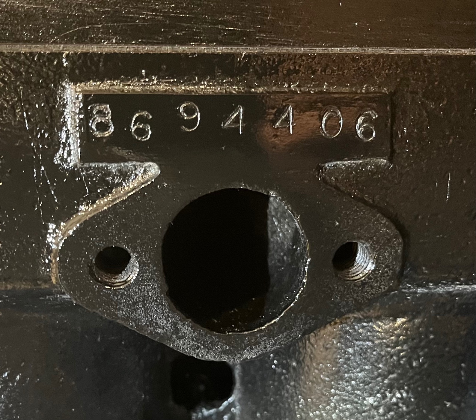

I just received my rebuilt engine with a replacement block. I had to change the cast block serial number to match my old block and title. I purchased these stamps which appear to be the correct style snd size.
https://restostamps.com/collections/for ... odel-a-b-t
New stamped block
New stamped block

Data plate number stamping ended in the mid 1910s. Block stamping and data plate stamping during the years when both were done was different due to the need for cast iron blocks to be cut by sharp fonts. Data plates using thinner and softer materials could use a more blunt font.
Over the years of production, several minor variations of fonts were used.
