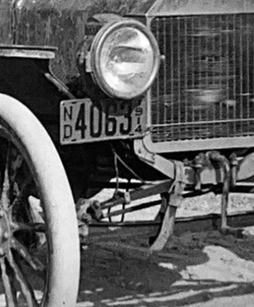

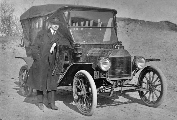

This photo was shared by dollisdad in Friday Flicks. It shows a belt around the front axle. I've seen this in other old photos too. I presume it's some sort of top-out limiter? Can anyone shed light on this? Was a belt used on the rear axle similarly, or only the front?

1914?
1914?

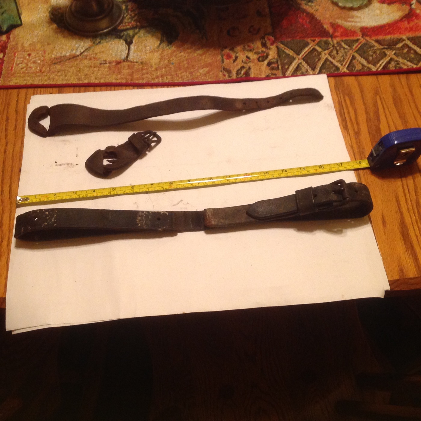

My original, unrestored 1907 Autocar has them in the rear. They were very common and were made of very thick retanned leather.

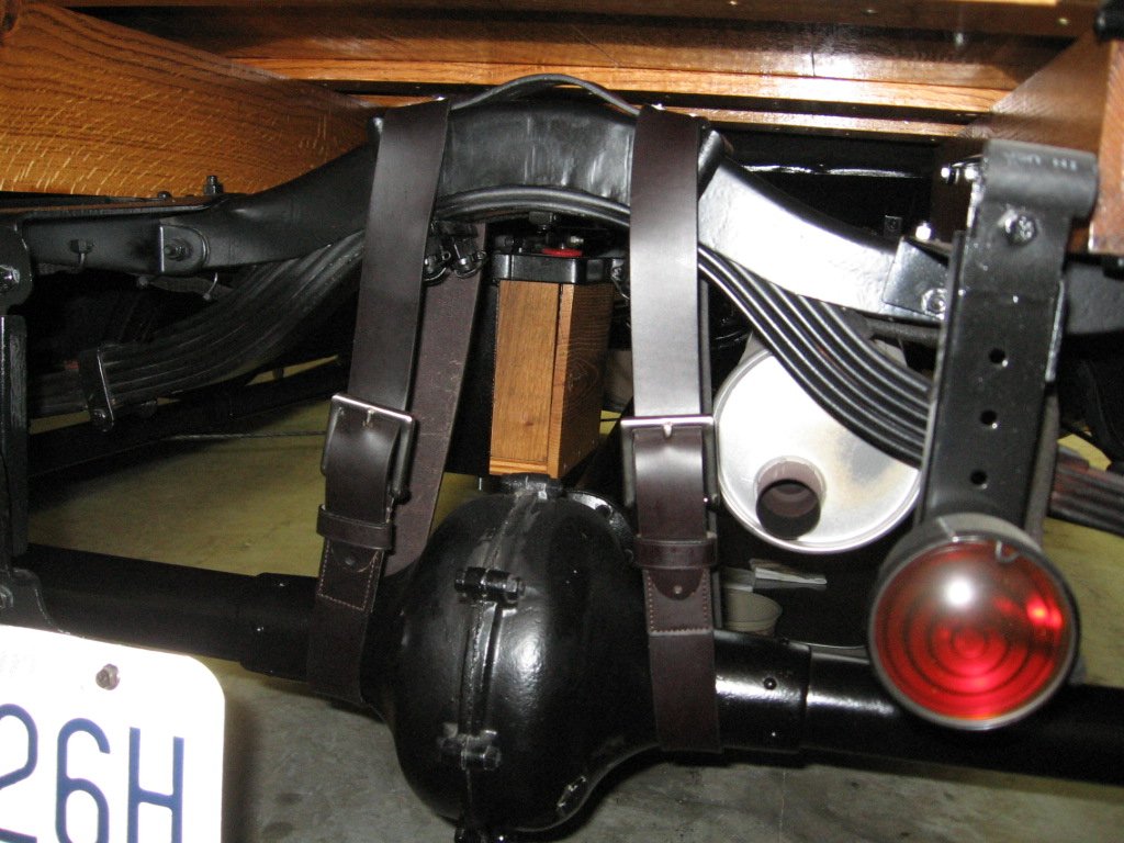

Post by DanTreace » Sun Mar 02, 2025 11:27 am
Yes These leather straps help to control rebound of the transverse springs. Many type made, some straps only, some with spring assist, esp. for the Ford.

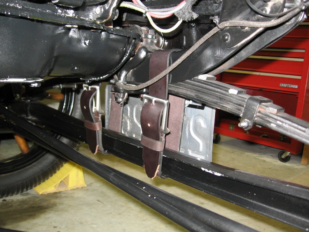

I run them on my 1924 front and rear. I made them from heavy leather belts I bought at Walmart. They do help to reduce rebound on bumps. :)

Mark, What method did you use for adjusting the length? In your picture it looks like you have the wheel off the ground and the front straps are tight?

Regarding the free length of the straps, I adjusted them so that they hung about 1/2 inch below the bottom of the axle when the car is on the ground. Purely a rough guess on my part, but it seems to work well. If the belt didn't have a buckle hole in the right place, I added one with a punch.
I believe that the car appearing to be off the ground in the first pic is an illusion, that yellow thing is a wheel chock.

Steve my Autocar had 2 on the rear only. They are fairly complicated and clearly designed to be adjusted. After 100+ years they gave up the ghost bouncing around in my trailer. I eventually found a saddle shop that was willing to reproduce them but they are extra heavy, thick leather. I don’t see how belt leather would last very long.
