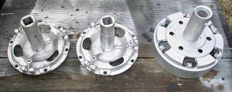

Here is a picture of two on the left for a 26/27. I just bought the one on the left from Jim Golden on the site.

In that case, 26-7 (wide drum) are smaller diameter. They fit into & under the drum surface.
Narrow are larger in diameter. The outer edge has a step & is actually part of the drum surface.
The larger/narrow output plate can be cut down & bolt holes modified a bit to be used on a wide drum.
So, the mounting hole pattern is slightly different. The wide drum plate has/had smaller holes for the smaller 3 finger pins.
There is also an odd/rare version that fits the narrow, replacement drum for the replaceable shoes. with a different hole pattern & lipped edge.
