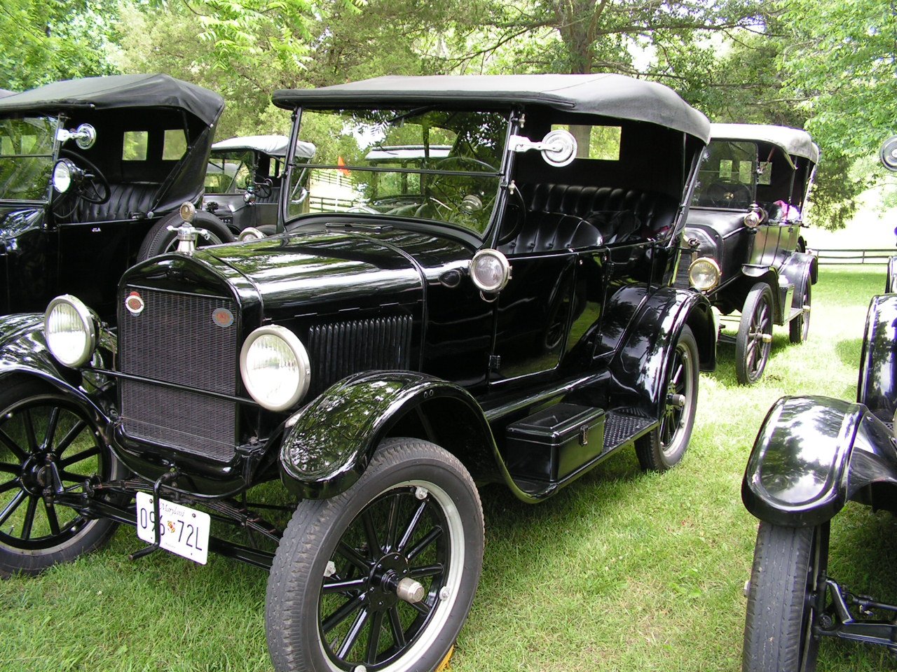

Post by J1MGOLDEN » Tue Mar 04, 2025 6:49 pm
The Made in Canada 1926 Model Ts had electric cowl lights.
J1MGOLDEN
Posts: 1314
Last Name: Golden
Location: Bowie, MD
Re: Any Differences Between 1926 Running gear U. S. vs Canadian?
Post by J1MGOLDEN » Tue Mar 04, 2025 6:56 pm
A 1926 Canadian Model T.
Posts: 7133
Post by Allan » Tue Mar 04, 2025 8:17 pm
That one has electric cowl lights. I have never seen another on any of our Canadian built cars here in Australia. Perhaps a particular Canadian province demanded them.
