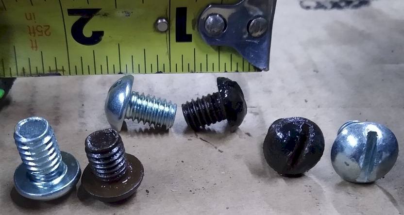

We installed an oil filter on the hogshead with an extra gasket. But the screws were 3/8" length and it has been a chore to get them threaded in the holes every time while I was upgrading the springs, tightening the bands, and reworking the pedals. So, I got some 1/2" replacements and was wondering if anyone else replaced these screws when adding an oil filter?

Sure did - original not enough length to grab the additional thickness of all combined !

The originals do vary in length. The little shorties are only good enough for the cover, but I do not use them on an alloy hsgshead. Longer ones can be almost 3/4" long. I dig through my stash and use those. You can fit the filter plate and gasket, and the starter cable bracket under those.

No Kent, they are 5/16-18x1/2" slotted round head machine screws.
