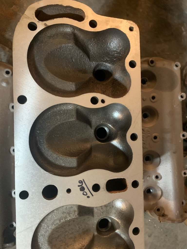

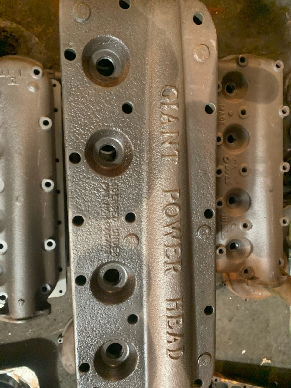

Anyone see this brand of head and got any idea what its worth? In excellent condition.

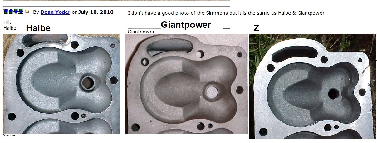

That is a Giant head. Haibe and Simmons also made a head which are very very similar. All are hi compression heads. I have seen them sold in the $350-$600 range.

I have 2 GPHs on my Model Ts. Great performance enhancers. I also agree with stated price range.

Got to be a little careful here... Those early high compression heads only had enough area in the head for the standard lift on the camshaft. The newer "Z" head is cast and machined to accommodate the higher lift cams to operate valves.

Let me elaborate a little.... Standard valves with standard lift and standard diameter Will be okay to use with those early high compression heads. If you have a cam with a higher lift or a larger diameter valves, that could be a problem as those valves would hit the cylinder head... I speak from experience. The Ralph Zajac " Z " high compression head has deeper recesses for increased lift valves, but I'm not too sure about extra diameter.
