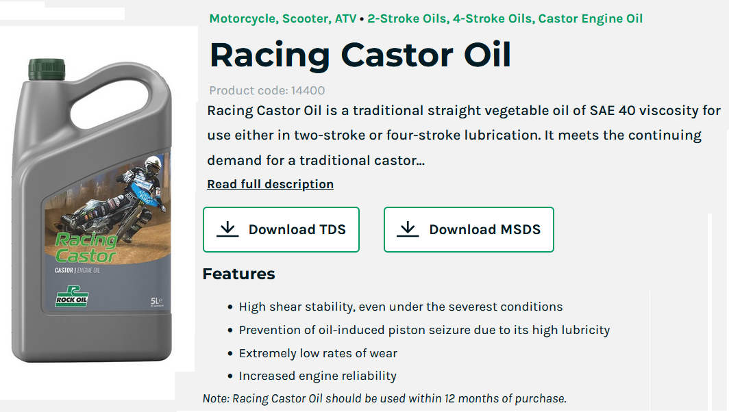

For sluggish engines use Castor Oil. Loosens up the piston rings & exhaust valves.
Posts: 8653
Re: I'm new. What oil should I use?
Post by TXGOAT2 » Mon Mar 10, 2025 11:00 pm
I think that at one time castor oil was the best lube available for racing engines.
Posts: 6587
Post by TRDxB2 » Tue Mar 11, 2025 3:37 am
Yup https://rockoil.co.uk/products/racing-castor-oil/
Racing Castor Oil is a traditional straight vegetable oil of SAE 40 viscosity for use either in two-stroke or four-stroke lubrication. It meets the continuing demand for a traditional castor lubricant, preferred in speedway, grass tracks and vintage machines.

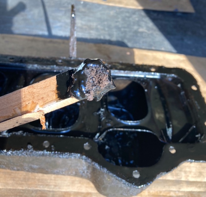

I pulled the oil pan off of my '18 Maxwell. I believe the PO was using unrefined oil sands from Canada in it.
