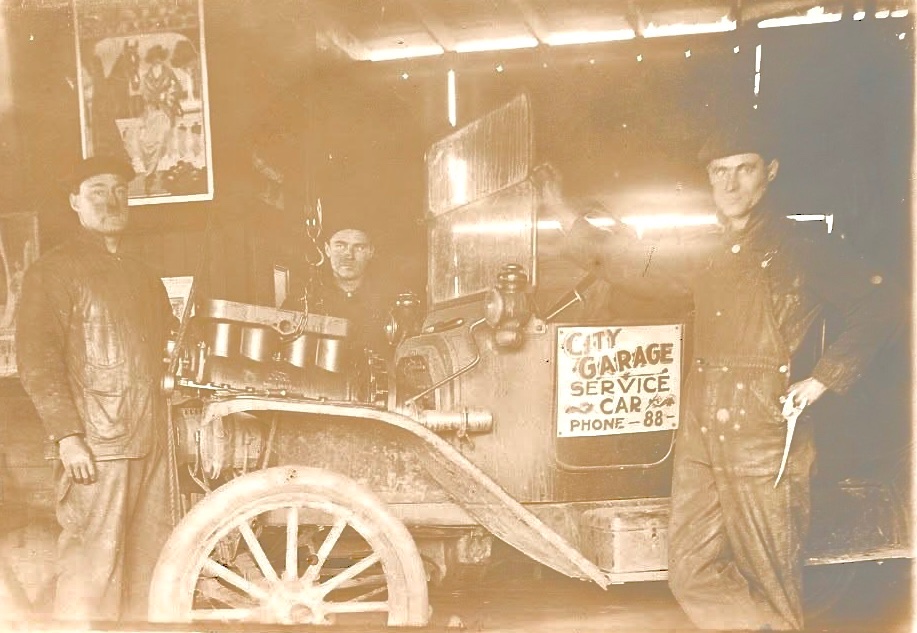

This one has me baffled ! How did they pull the engine, leaving the pan in the frame, and clear the flywheel with the dash in place ??

However it was done, it took 3 men to do it.
- Posts: 4691
Re: Don’t try this at home - we’re trained professionals !
Maybe the photo was a staged photo with the only engine in the shop to take a pose.
Seems like the mechanics would know you couldn’t get the engine in without the firewall area cleared out. But it does have the service sign on it which I still think it was a staged photo for their photo.
But the crankshaft has a long handle on it to help wrestle the engine block in!

Pretty sure that's the rope for the chain-fall - not a bar.

Can anyone decipher thar poster in the upper left? I see 1915 or 1916?
- Posts: 5549
And it has gas headlights!

Two digit phone number.

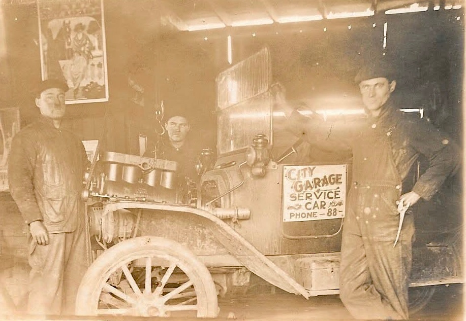

Take a closer look. The oil pan appears to be mounted to the bottom of the frame. Or, just setting the floor behind the car?

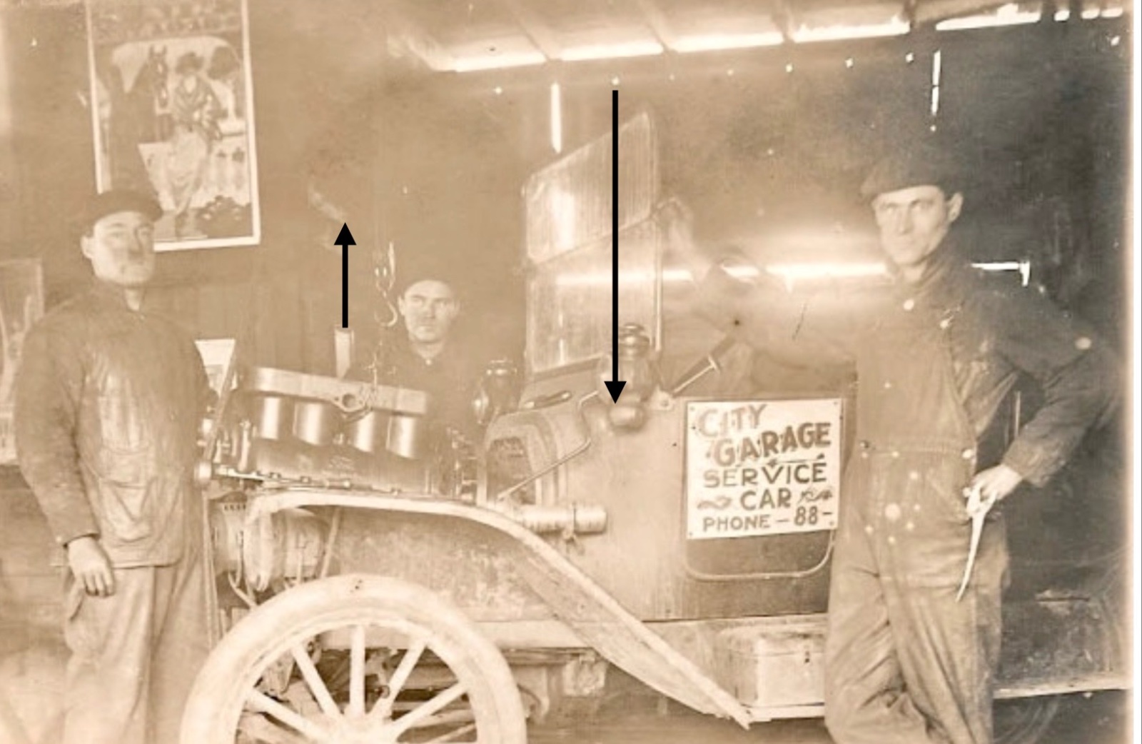

Here’s my take on removing the engine and flywheel trans from under the dash, while the body still appears mounted on the frame.
The chain fall lifts from center opening where balance is provided. Thus man 2 pulls up the engine , (up arrow), allowing tilt ,while man 1 pushes up to clear pan nose, big guy can also pull engine forward as the tilt is made.
All the while man 3 uses the long lift bar with bent handle, hanging over the cowl lamp, to push down (arrow) on the flywheel or coil ring to lever flywheel out of the sump of the crank pan, and helps to clear the firewall.
No fear of magneto damage, as this old T sports an electric horn, so obviously a battery is there for ignition, all the while night driving can be down with the gas lamps.

Dan - I believe that is the radiator brace wrench on top of the sidelamp - I have the same wrench - it's that specific length to clear the radiator whilst removing the nuts.

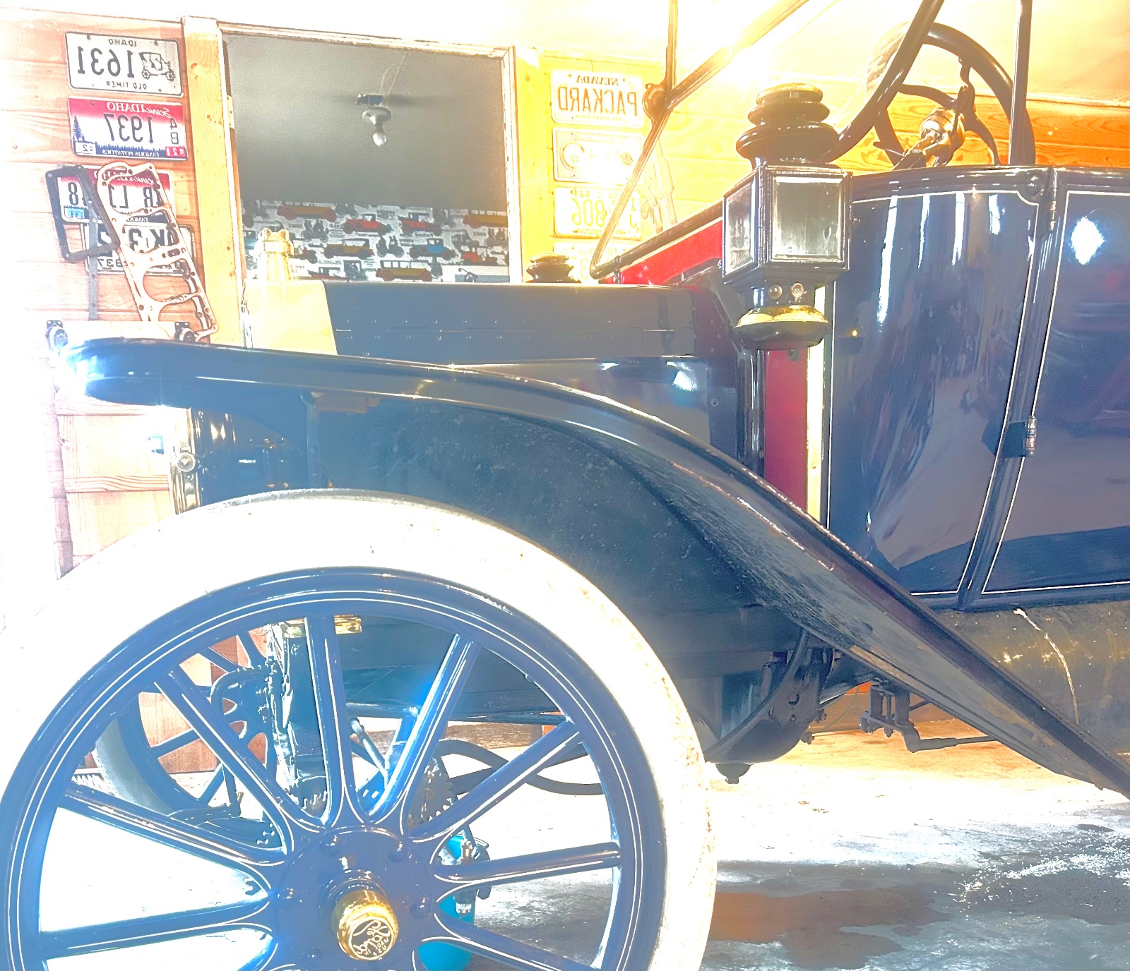

Sharp eyes, Scott, that needs a critical look. I’m pretty sure what’s mounted to the bottom of the frame is the splash-pan. I need to take a critical look at my T from the same angle to be sure, but it seems to me the pan is in its normal place in the frame, and attached to the wishbone.

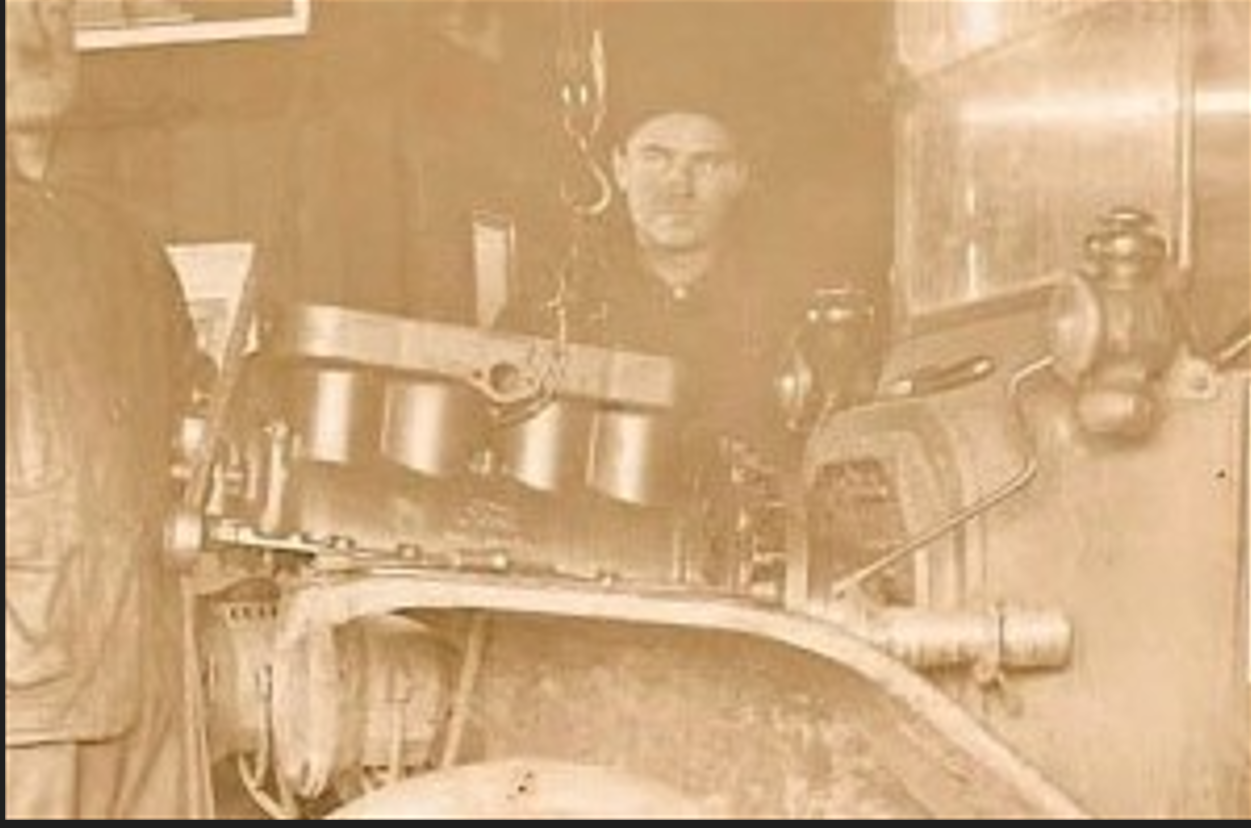

Zoomed in...
- Posts: 5597
OR - perhaps that is the pan bolt/nut brace wrench - same size nut.

Compare - it’s a ‘13, and I “flopped” the image as I couldnt get a shot from the driver’s side, but the angle is close, and the pan and support arm are clearly visible . . .
