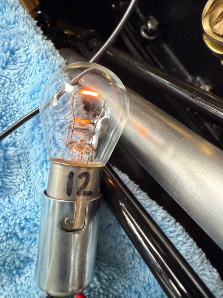

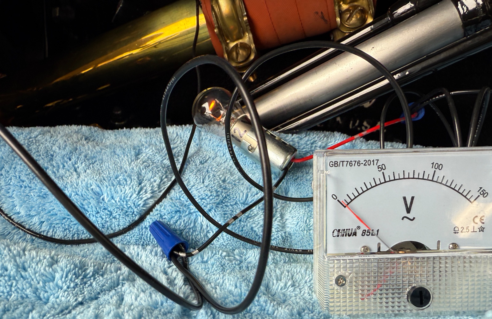

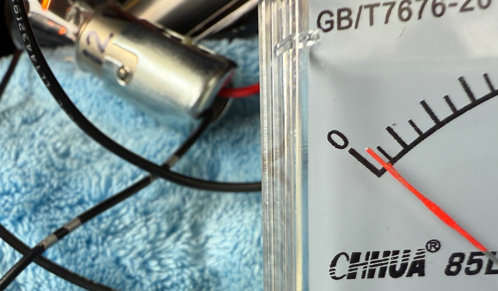

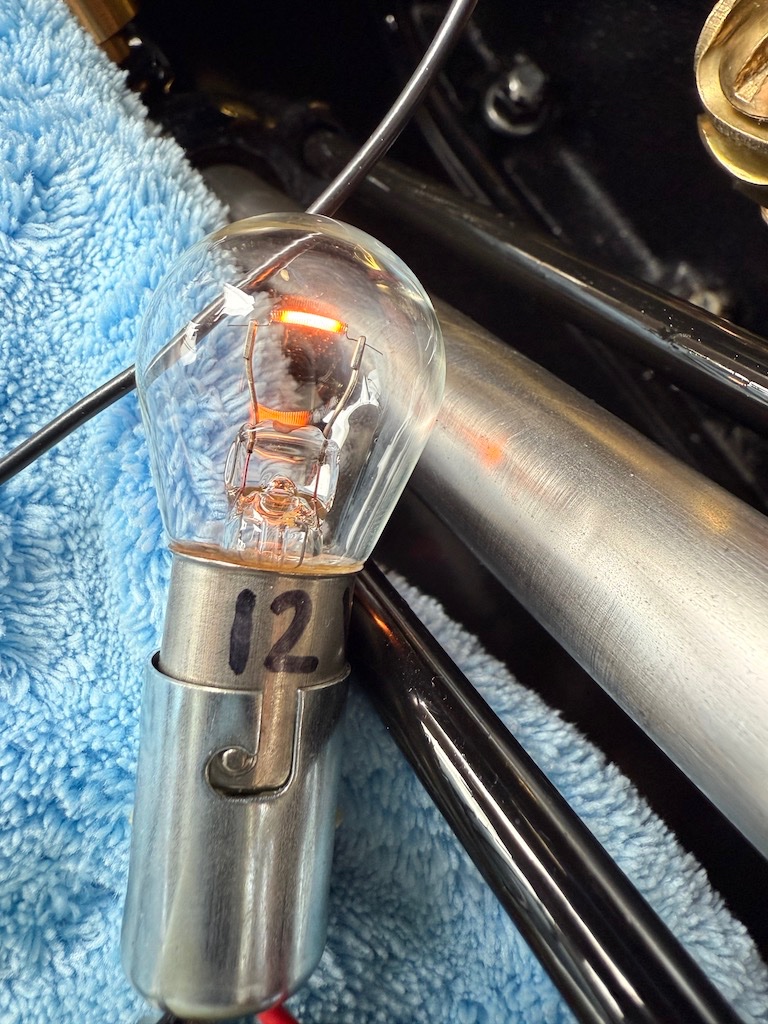

I just got out to the garage to check the mag voltage. I used a digital voltmeter as I don't have an analog unit.
I hooked the wires red to the mag wire under the hood (porcelain plug), black on ground.
I got a free "hot start" on BAT after priming.
Meter reads 3.5V AC
That's it. And the 3.5 V stays pretty steady through all RPM ranges, from idle to fast idle.
When I switched to MAG, it all but quit entirely. Literally sounds like an old "hit or miss" engine. One cylinder fires every once in a while to keep it just barely limping.
Switch back to BAT, smooth as ever.
Bummer. How does this just happen?

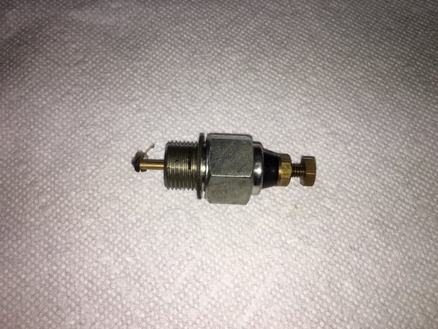

Gary .....Just for the hell of it, put in a new mag pickup on top of the transmission cover and start as usual.

Re: Runs great on BAT / Hit & Miss stumble on MAG
UPDATE:
I used the analog AC volt meter with an 1156 12V bulb. Attachment directly onto the MAG plug and grounded to an engine stud.
The bulb filament exhibits a dull orange color and the voltmeter never exceeds about 3V from a "spark-retarded" slow idle, all the way to a fast idle.
Literally no change through all RPM's. I got the same reading with my digital volt meter. I am totally at loss what on Earth could have possibly happened here, but it's a bummer.

I don't know if it matters, (I think it might), but that looks like an 1157 bulb, (dual filaments). I think an 1156 is a single filament bulb. The 1157 may draw a lot more current and pull down your voltage.
- Posts: 5594
Did you remove, inspect & clean the contact ??????????
Gary W
Topic author - Posts: 7
- Joined: Fri Jan 11, 2019 7:51 pm
- First Name: Gary
- Last Name: Wheeler
- Location: Wall, NJ
- Board Member Since: 2013
It’s an 1156 single-filament. Just reflection in the photo
Removed and replaced mag post. It is spotless so I wiped it and reinstalled
Removed coil box entirely from firewall and inspected every wire/connection. Everything is tight, clean and in perfect working condition.
Got same voltage reading from mag post and firewall mag porcelain post so I know the wire is good.
Thanks for the help/advice/ideas….

Electrics are not my strong suit, but I get by.
If what I am about to say is incorrect, I hope our smarter T people will correct me.
Seeing your testing hits me as screwy.
I thought the light bulb test & voltage output test were TWO separate tests. You have them combined in series.
The light bulb test by itself Looks for a visual condition by the brightness of the bulb. @ idle the bulb should light ok. As the rpm increases, the bulb gets brighter to near blowing out.
The ac voltmeter test by itself reads mag output by voltage readings. Idle should be 6-10 volts. As you raise the rpms voltage rises. High speed 18-30 volts. Furthermore, your meter is in the wrong scale for an accurate voltage reading. It should be 50V max. You dont use a 150# truck tire gauge to test for 30# on a modern car tire. Such gauges are designed to be accurate in the middle third of the gauge.
You might try testing again separately.
Even with your testing method, the 12v light bulb is well lit. How can that be only 3V? I think the bulb is bringing down the voltage reading by its presence in the circuit or the meter is way off. (I do have recent experience with an inaccurate Chinese ammeter.)
By example: I have a home made rectifier on my 14 to convert the 30V mag output to charge a 12V battery @ 3 amps.
The bulb does not light @ idle, yet the motor still runs very well on mag. @ road speeds It glows bright. I had to use both filaments or the light would burn out.
Testing without the rectifier in the circuit, mag post only, shows 12V @ idle & 32V @ hi speed.

I thought the light bulb test & voltage output test were TWO separate tests. You have them combined in series...
It would appear that the OP, Gary W, did it correctly."Please do this test exactly as described, provide the results, i will interprete the results and tell you how best to procede.
Go to your local auto parts store and buy a #1156 bulb. This is commonly used as a back up light bulb in modern cars. This bulb will come close to simulating the load of a typical Model T coil. You may want to pick up a socket for it too and put some wires on it to make a regular test light out of it.
Connect the bulb across the magneto output and ground while you running the car on the battery with the emergency brake pulled all the way back and set. Using an analog voltmeter check the AC voltage across this bulb as a load."
"You have them combined in series."
Should be in parallel.
