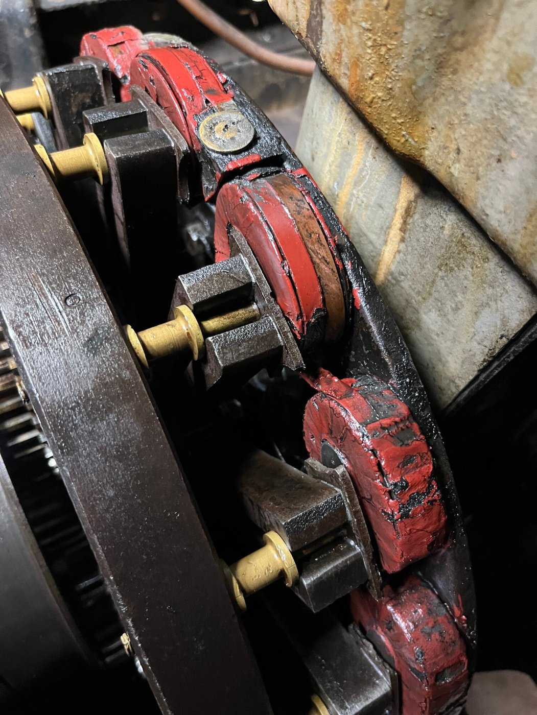

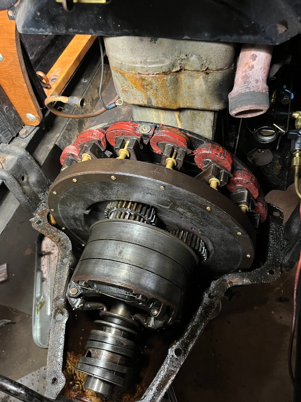

Since I'm rebuilding the rear, I thought I'd check out the transmission of my 1915 roadster. This is the first T that I've removed the hogs head. It has cotton linings which actually look OK, but one had loose rivets that came right off when I touched them. Anyway, any thoughts on how it looks?
Phil
Phil

Drums look ok but those windings are going to give you grief. The winding covering is past the point of no return and as it continues to flake off is going to plug your oil feed tube and put a lot of trash into the oil. It is already missing in places.

I was wondering about the red coating on the coils. What should I do to correct it? Is that a paint like Glyptal?

To check the trans correctly it needs to be dismantled. Drums crack in the webbing all the bush clearances etc, the magneto field coil needs replacing, the usual way is to use a later set up with a ring gear flywheel so a starter hogs head could be fitted now or later. your head gasket is leaking. I'd say it has been many years ago that the engine has been apart, the hogs was put on with cork gaskets, they haven't been available for years. Could be all sorts of surprises in the engine. The engine mount wood blocks are missing as well.

Whats the clearance between metal tabs holding 2 ‘legs’ of magnets and the field coil ? I like a max of .032 at the top. Drums not scored, lacing wire present, triple gears look good. You asked ‘how it looked’ but, as previously advised, it’d be best to do a total tear down. Especially since the T is new to you…
- Posts: 4412
Re: 1915 Transmission. Look OK?
It "looks" very right for a 1915! Which in itself is quite unusual. It has the correct early style triple gears, which have a wider running surface than the more common later gears. Those early gears were riveted together, and sometimes the rivets weaken and become loose. So if you take it apart for a more thorough inspection, check those gears very carefully.
That style gear was used for quite a few years, and they are not rare. However, a lot of people do not trust the rivets and so replace the gears with the more common later type. Personally, I like the way the early riveted style run better and more quietly than do the later ones.
Your 1915 engine has the double-stacked oval shaped field coil for the magneto. That is the correct one for a 1915, and I believe 1916 and maybe early 1917. They were not used for very long before being replaced by an improved single (no stacking) ovals field coil. The double stack was introduced for the 1915 model year to increase the amount of electricity produced in order to run the magneto powered electric headlamps. It was found to have not really been necessary, and after some time Ford went back the "no stacked" single coils which were considerably cheaper to produce.
Those double stacked field coils are not found often. They were actually used for only a short time. Over the years, most cars that had them from the factory had had them replaced by the much more common and available later style. The double stacked field coils are much more difficult to rebuild than are the later ones. Twice as many coils to rewind, and trickier wiring make them very difficult.
Reworking the whole transmission to engine assembly requires checking and fitting the field coil for best results. Not difficult to do, and changing to the later field coil usually does not complicate it significantly.
Only a truly anal purist would insist on using the "correct" 1915 style field coil. If I had one, and it was a good one, I would have used it. However, I do not have one, so my 1915 runabout has a later field coil inside. If anyone would like to provide me with a proper 1915 field coil? I would only change it IF and WHEN it was convenient to do so (which most likely would be never?).

Glad I posted the photos. No idea what has been done to this car, but it does run and drive pretty well. The rear was worn. I replaced the U-joint, axles, axle gears and drive shaft. The axle and drive shaft tubes were straight, however. Never knew about the wood engine mounts (Lang's #3083?).
Thanks, Wayne, for your comments on the coils. Again, news to me. Would it be worthwhile to get a rebuilt double stack coil assembly rather than trying to redo the old one? I see Snyder's offers them for $345+ core.

The magneto coil has been painted with DuPont red electrical winding spray paint. I had some with that was the same exact color. When I removed the engine out of my 24 Coupe for the first time many years ago I used some gas to remove the grease from the mag ring since there were a few places that the winding material coming off so I used the winding spray paint the coil. It lasted until I removed the engine again a few years later.
That was before you could get the mag rings rebuilt and that was probably done to your car.
Your car had the engine out and some work was done on it since the mag ring was painted I’ll bet. The drums look good and not grooved so they are probably OK. I would say since the mag ring hasn't been rebuilt it might be a good idea to have it done. I don’t think yours has. If you use the later single stack you may need to use some spacers to get the correct spacers to change it but I’m not familiar with that and others that have done that can tell you how to do it. Wayne S. would know about that.

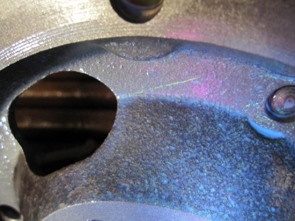

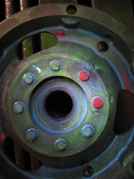

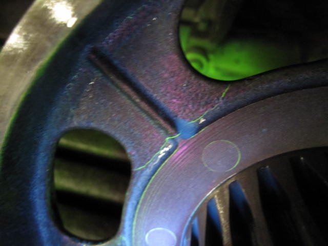

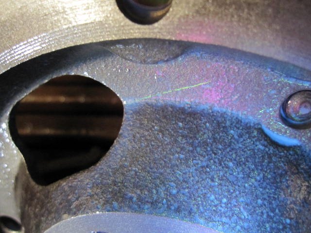

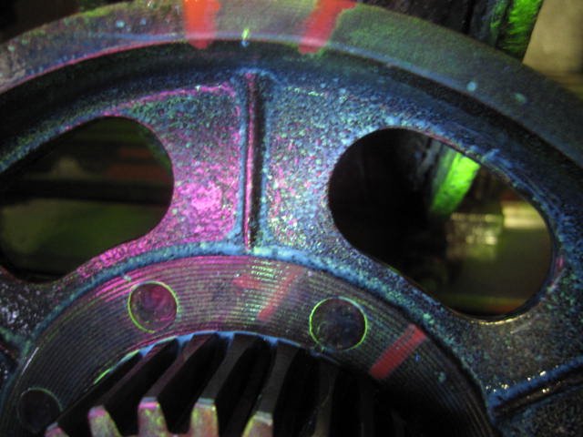

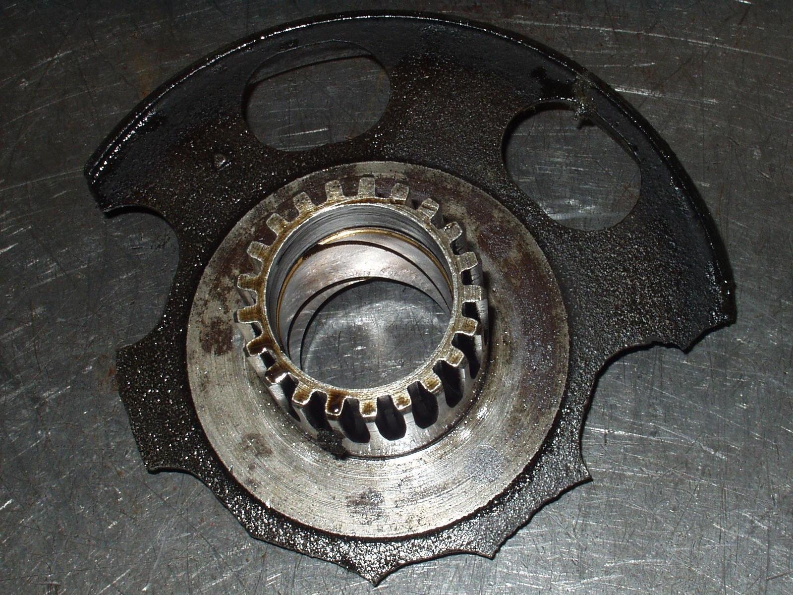

If you know the car has been driven alot it would make sense to disassemble and inspect the transmission parts properly.
With the red paint on the mag field , it's been apart before and that needs replacement.
The drums especially reverse and to a lesser extent the low speed does crack . Along with the triple gears and pins and bushings wearing out.
You have it apart it makes sense to go the distance and make it safe for driving the car.
I have enclosed a few examples of where the drums crack as well as the drive plate between rivets.
J and M Machine.
