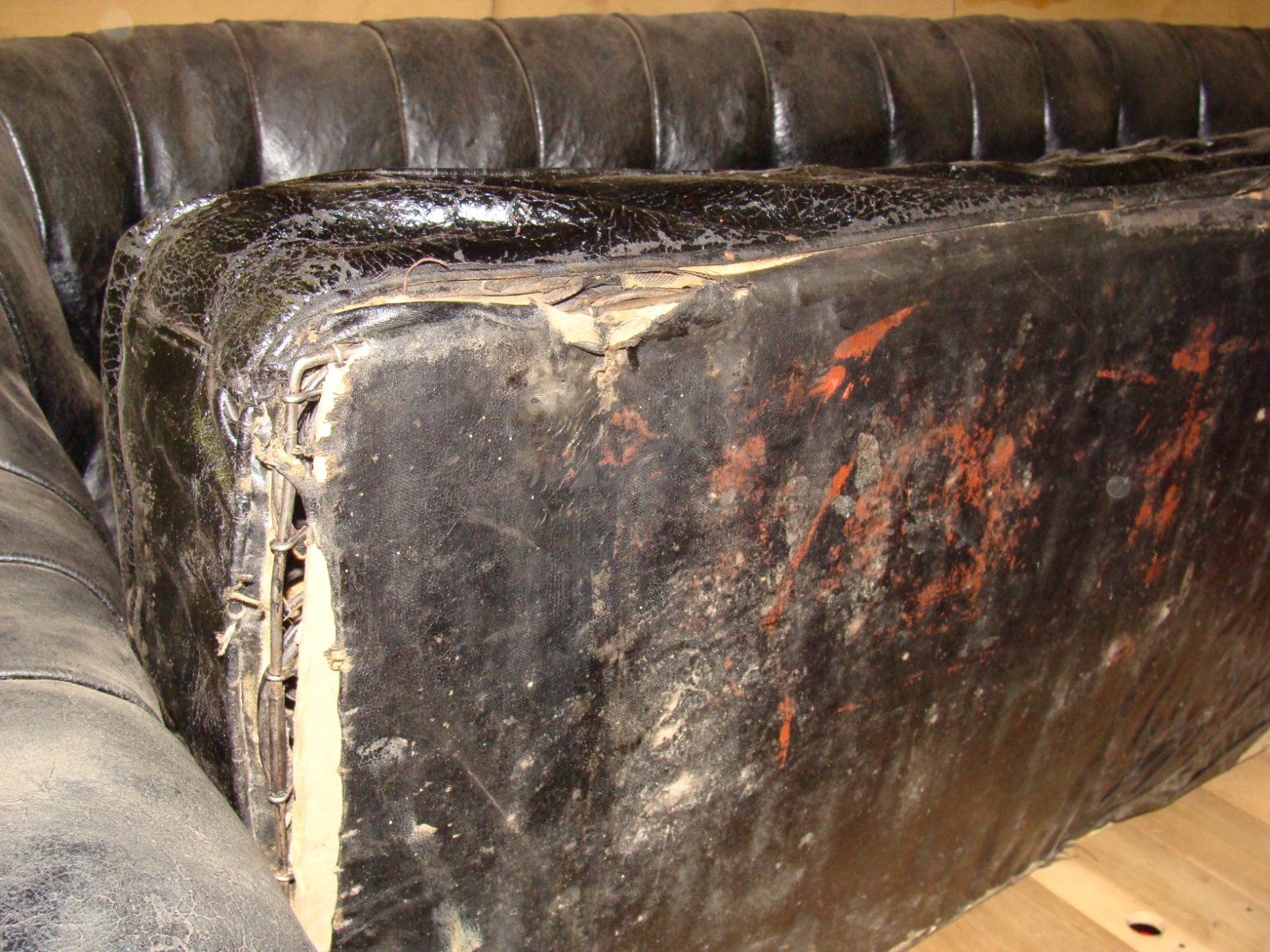

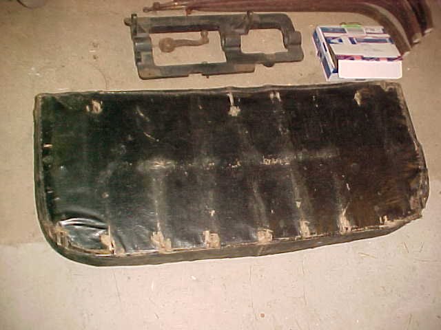

This is the underside of car s/n 82425 front seat cushion.
Here is the underside of car s/n 83913 front seat cushion.
They are like a pillow case and the bottom has 'vinyl' covered cardboard.

Keith, so it looks like that seat has a wire metal frame?KWTownsend wrote: ↑Sat Mar 15, 2025 6:41 pmLate '11 do not use the wood frame.

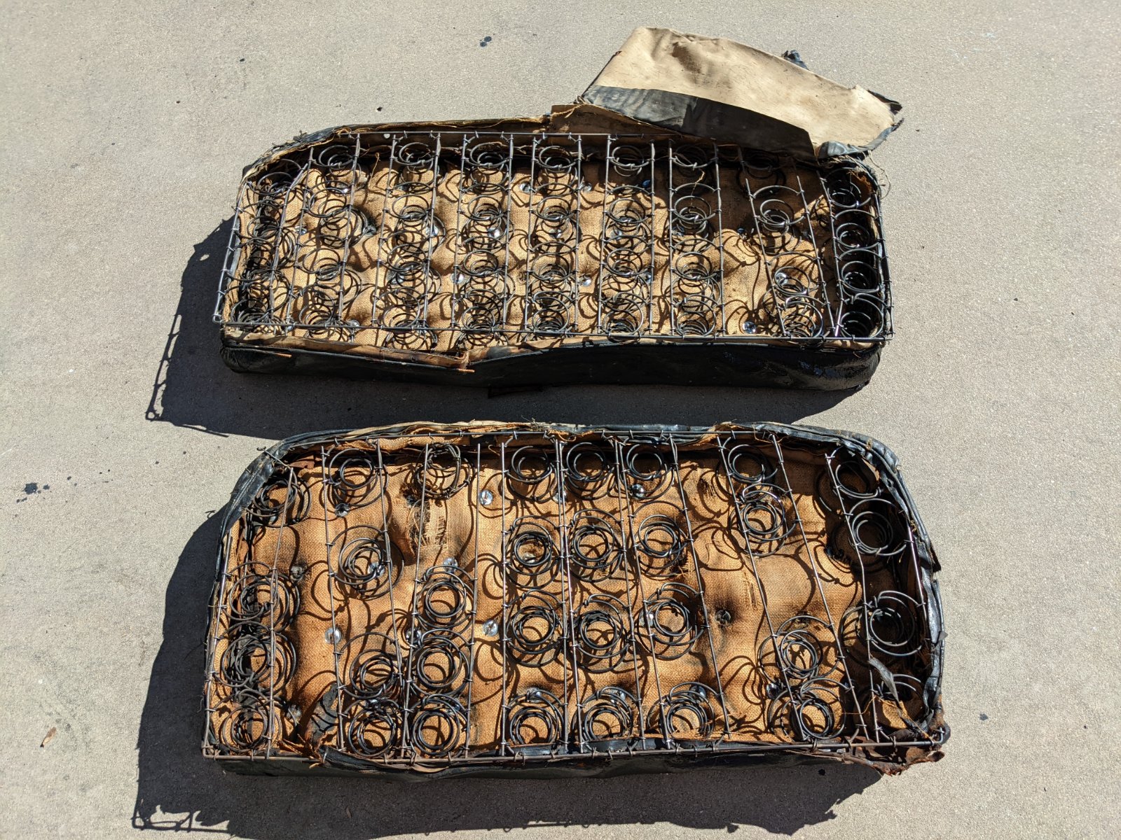

This is the underside of the seat cushions from the late 11 touring car that I restored, showing the wire seat bases. One of the pictures that Keith posted is one of these cushions before the cardboard like bottom was removed.
Neal
Neal

Re: Seat question for 11-12
Mike,
You are correct. The spring has a metal frame, but does not have the crimp channel for attaching the cushion upholstery (with the cord) like on later years.
Delivery cars may have a different spring and cushion all together. I would suggest you reach out to John Regan.
