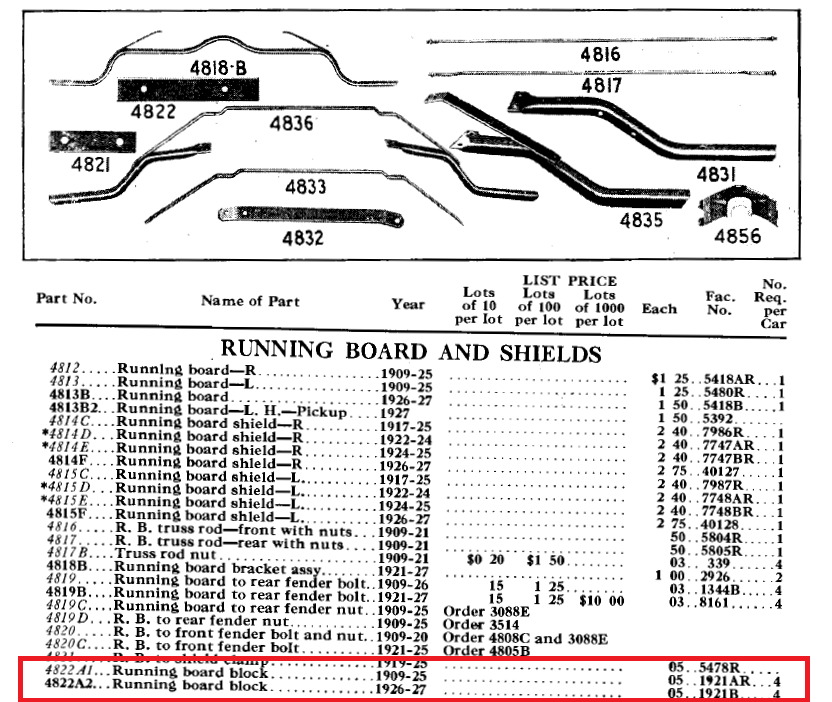

When did they stop using the wooden blocks between the fenders and running boards?

Post by TRDxB2 » Mon Mar 24, 2025 1:44 am
Stephen_heatherly wrote:
Sun Mar 23, 2025 10:32 pm
Thanks,
Stephen
They were used on the 1927 Model T.

Post by TMiller6 » Mon Mar 24, 2025 2:46 am
1921?
The vendors parts catalogs offer 8 piece block sets with usage through 1920.

Post by varmint » Mon Mar 24, 2025 5:20 am
Our October 26, 1926 ('27) T has blocks between the running boards and the support brackets but not between the running boards and the fenders. If it is supposed to have them there, i don't know anything about it.

Post by jab35 » Tue Mar 25, 2025 12:32 pm
RB Blocks- https//www.modeltford.com/item/4822B.aspx price slightly higher than original 4/twenty cents.
For '26-'27, front fender flange mounts to running board flange, no blocks
My '27 is the same.
