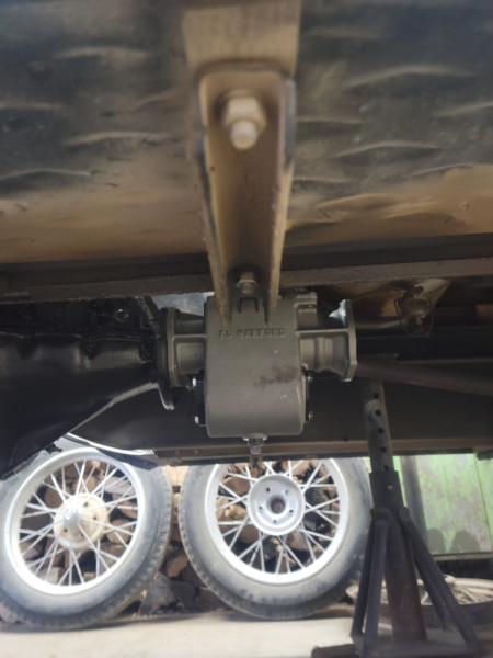

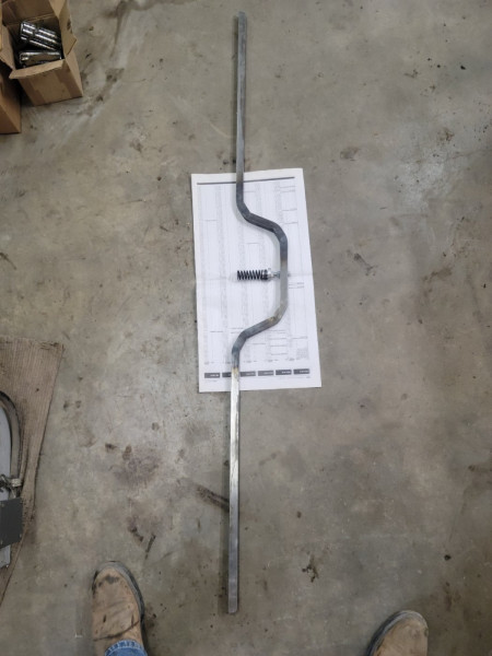

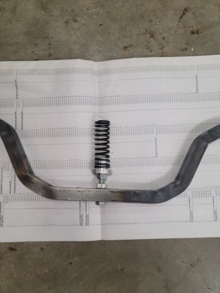

This what I came up with. I'm sure some won't like it. Part of installing the trans requires cutting out 7" of the running board bracket. I had figured on reinforcing it anyway but noticed the bracket is directly in line with the drain plug. I fabricated this from 3/4"x 3/4" cold rolled. It ties together the running board brackets and supports the trans. The trans weighs 32 pounds. Using a T valve spring the rate is 26 pounds at 2". This car does not have a 26-27 motor so felt it needed something. The bracket is 1 1/2" lower than the engine drain plug.

Hi Steve,
Correct some may not like it but & like the way your thinking. I'm installing a Warford in my next speedster so I will have a lot more room than
you have. My thought on this is you only need to support the weight of the Aux. trans so I'm not sure how much good pushing it up with a spring
will be but mounting it that way will make changing the oil in the Warford a little complicated. I plan on using a belly support or Lizzies girdle
as they are called so that it supports the weight but doesn't restrict the frame movement. Just a thought.

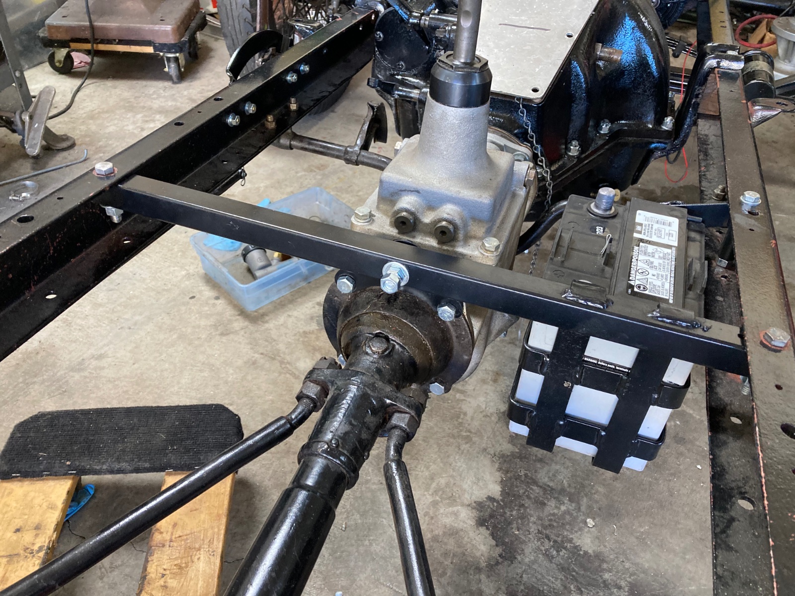

I have a new Warford in my Mercury. I made a cross member/battery box with a bracket to support the warford. It is a simple triangular plate that bolts to two of the warford rear bolts and a single bolt through the cross member so it supports the weight but can twist. I also run a pan sling due to the extra weight of the Rajo and Warford.

I also have a Warford in my speedster that I mounted much the same as Andy. I added radiator springs to the rear oil pan bolts, giving a place to flex. Also only used only the vertical bolts on the pan, left the horizontal bolts out.
