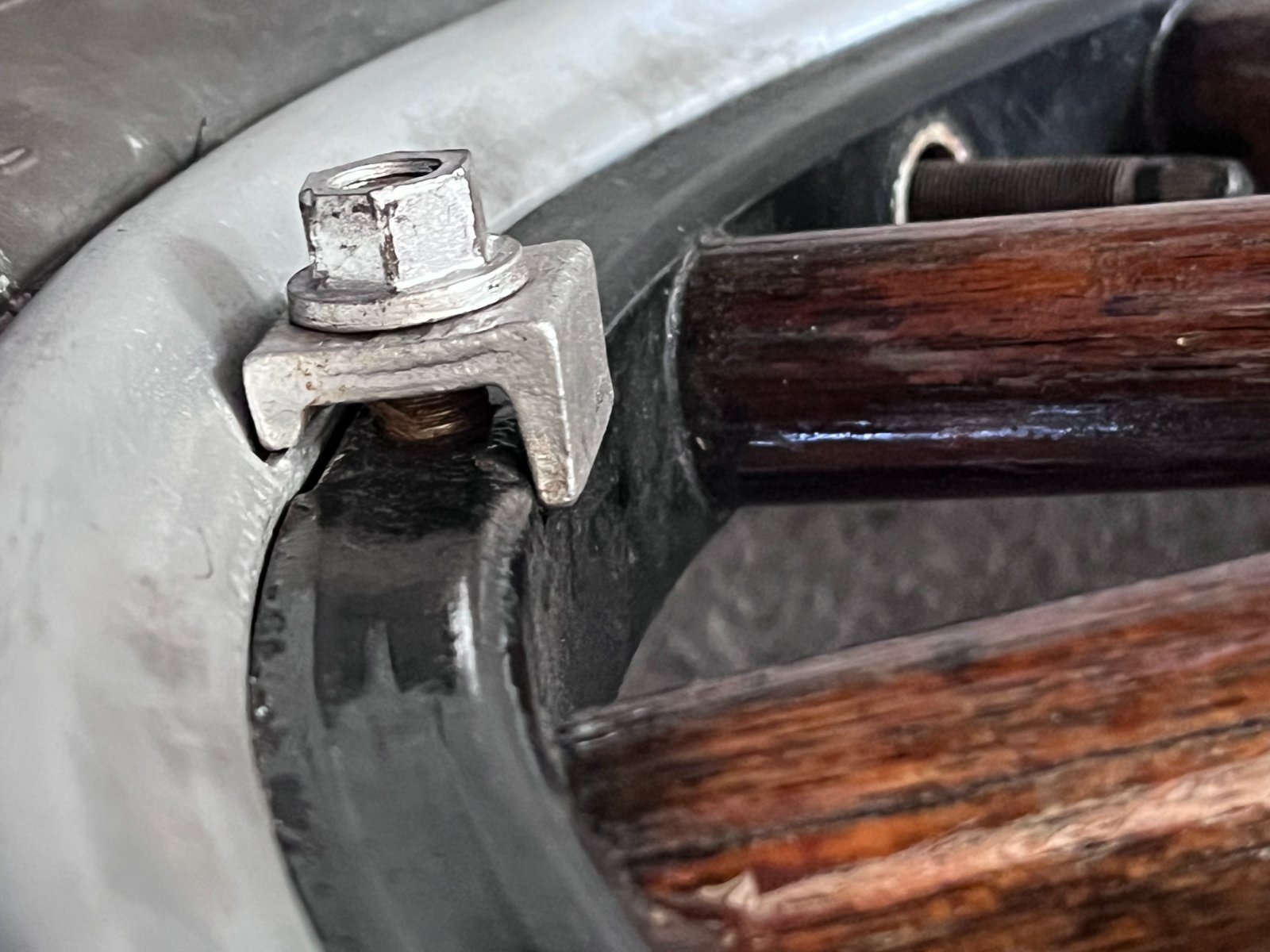

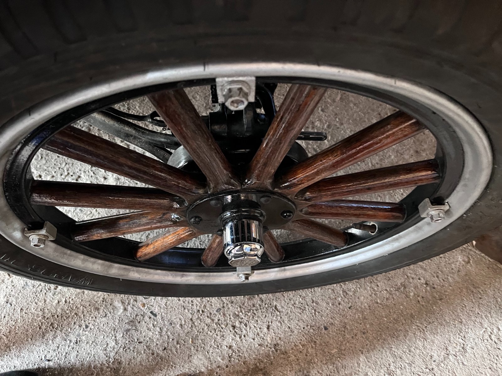

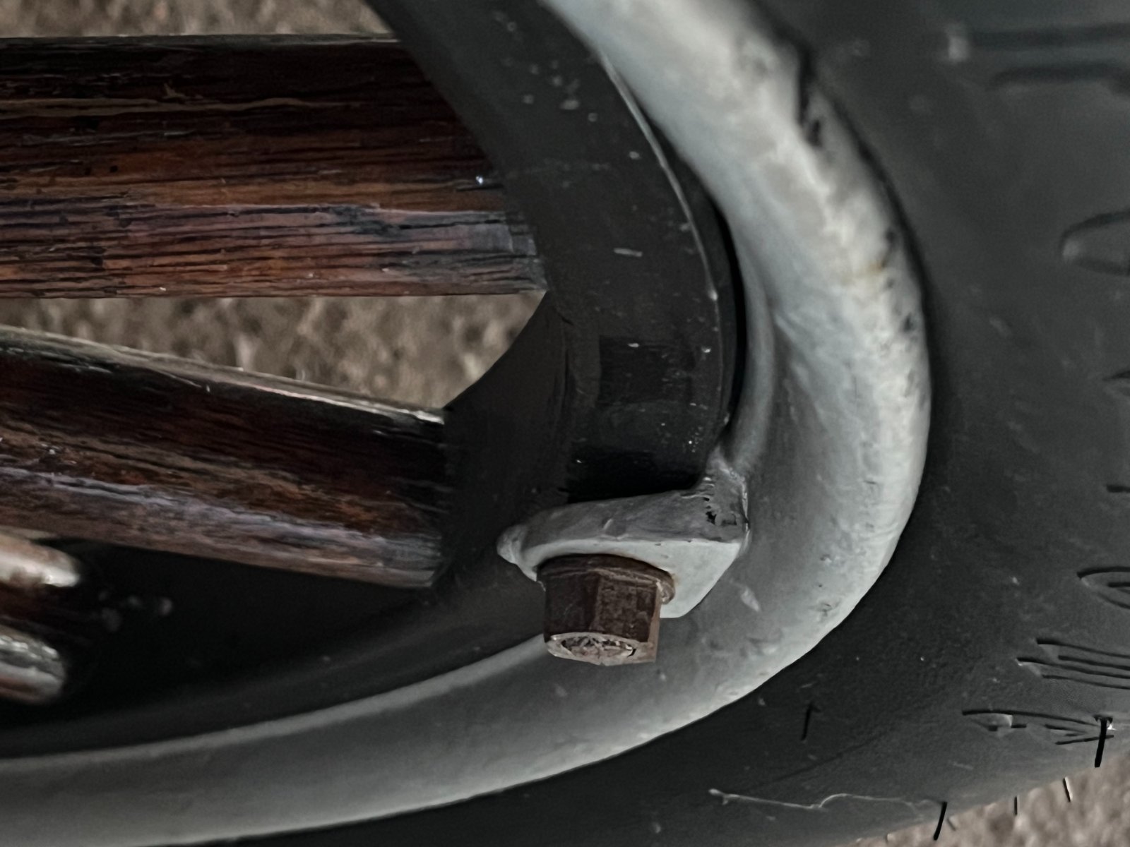

I have a question regarding lugs.
A demountable rim with fixed lugs had been on my car; but the tube was leaking and I wanted to use my spare rim/tire.
This spare tire is installed on a demountable rim without fixed lugs, so it has loose lugs to install them to the felloe (I think they are called Kelsey lugs).
I tried to install them but I am not quite sure, if this installation is correct and secure as there is a gap.
What do you think/ recommend?

Re: Could I use loose rim lugs instead of fixed lugs on the same fellow?
No.
The loose lug fellows have a raised tab.
The lug sits on that raised tab as it contacts the rim with the other end of the loose lug.
It's not just the raised tab needed. There is a difference in the actual felloes and the way the rims mount on them.
Loose lug wheels are wedged onto the rolled -in land on the outer edge of the felloe. The job of the loose lug and rim bolt is to maintain the wedging effect so the rim cannot move on the felloe. With a good rim and no wear due to looseness on the felloe, a credit card can be inserted between the inside of the rim and the rolled out inside edge of the felloe
Fixed lug rims work differently. The felloe which takes the lugged rim has a wider rolled out edge on the inside. A lugged rim wedges on this wider, inner edge of felloe. With a good rim and felloe combination, the lugs will stand off the outside face of the felloe, and a credit card can be inserted between the rim and the outer land on the felloe.
Some believe that the rim makes contact on both edges of the felloe. On worn assemblies this can happen, but it should not. For instance, those felloes with the straight-up edge on the outside are not made to make this contact.
Lugged rims can be mounted to loose lug felloes, but they do not wedge on those felloes. The rim bolts then have to take all the drive, not an ideal situation.
Hope this helps.
