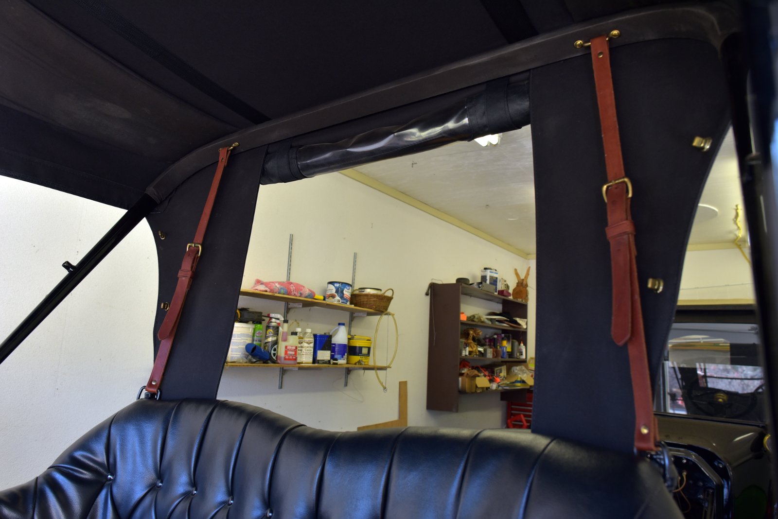

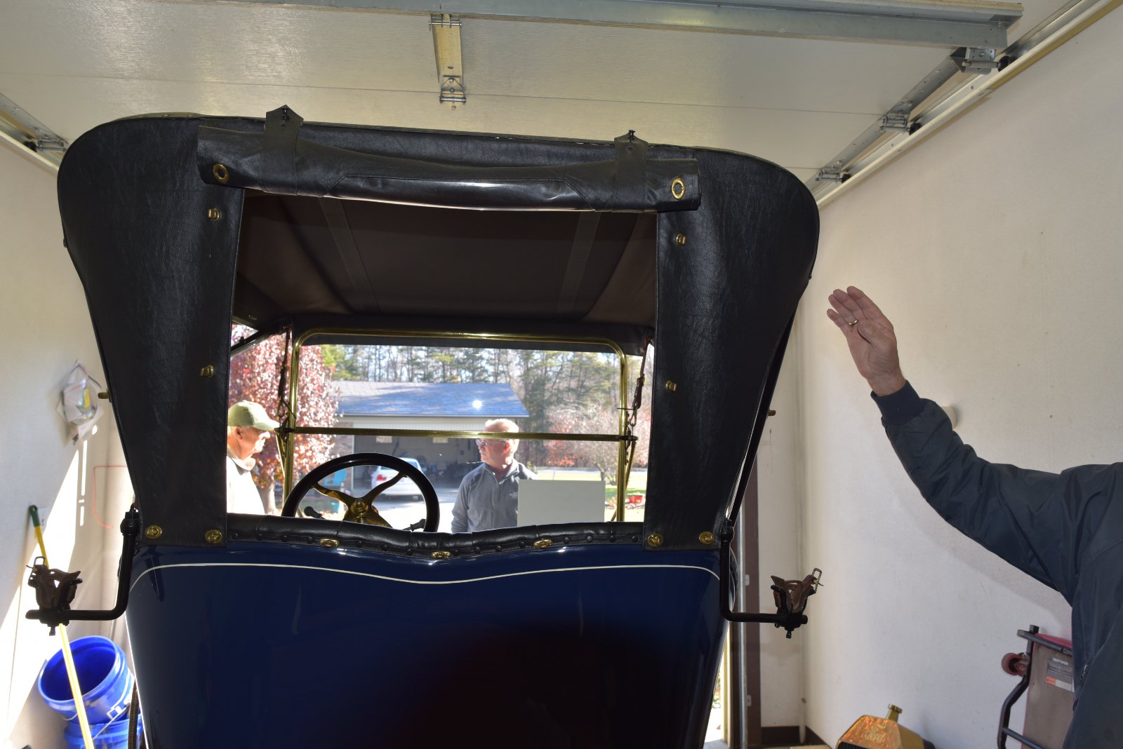

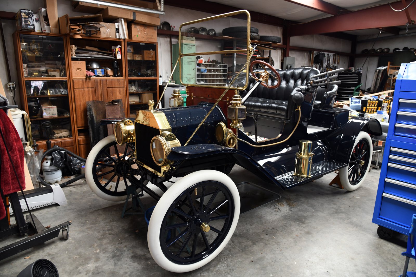

I am working towards getting a top on my 1912 Commercial Roadster. Classtique doesn't make a top specifically for the Commercial Roadster but they do make one for a 1912 Torpedo. Tony York modified a 1912 Torpedo top for his Commercial Roadster. Of course, his guy that did it is long retired and gone fishing. He said the top deck fit well but modifications had to be made to the rear vertical panels. He couldn't tell me what those modifications were as he was not the guy who did them. Anyone else out there have experience with putting a Torpedo top on the Commercial Roadster? Some guys tell me it is out of the question, others not sure, and I know of at least one guy who has done it. Anyone out there have any thoughts about this? Anyone else modified a 12 Torpedo top to fit a 12 Commercial Roadster? I asked Mike Francis of Classtique if it could be done, and he said he didn't know because he had never tried it. Seems like the experts at doing these custom tops are thousands of miles from where I live so that is a bit of a last resort.
Attached are pictures of Tony York's Commercial Roadster (that's Don Ellis in the background, y'all) as well as a picture of my topless 12 Commercial Roadster.

Hey Greg. Who did your upholstery? Its really nice!

It was done years ago in the Pacific Northwest when Ken Jones was building the car. He was a well known guy but I forget his name. Steve Tomaso probably knows who he was.
