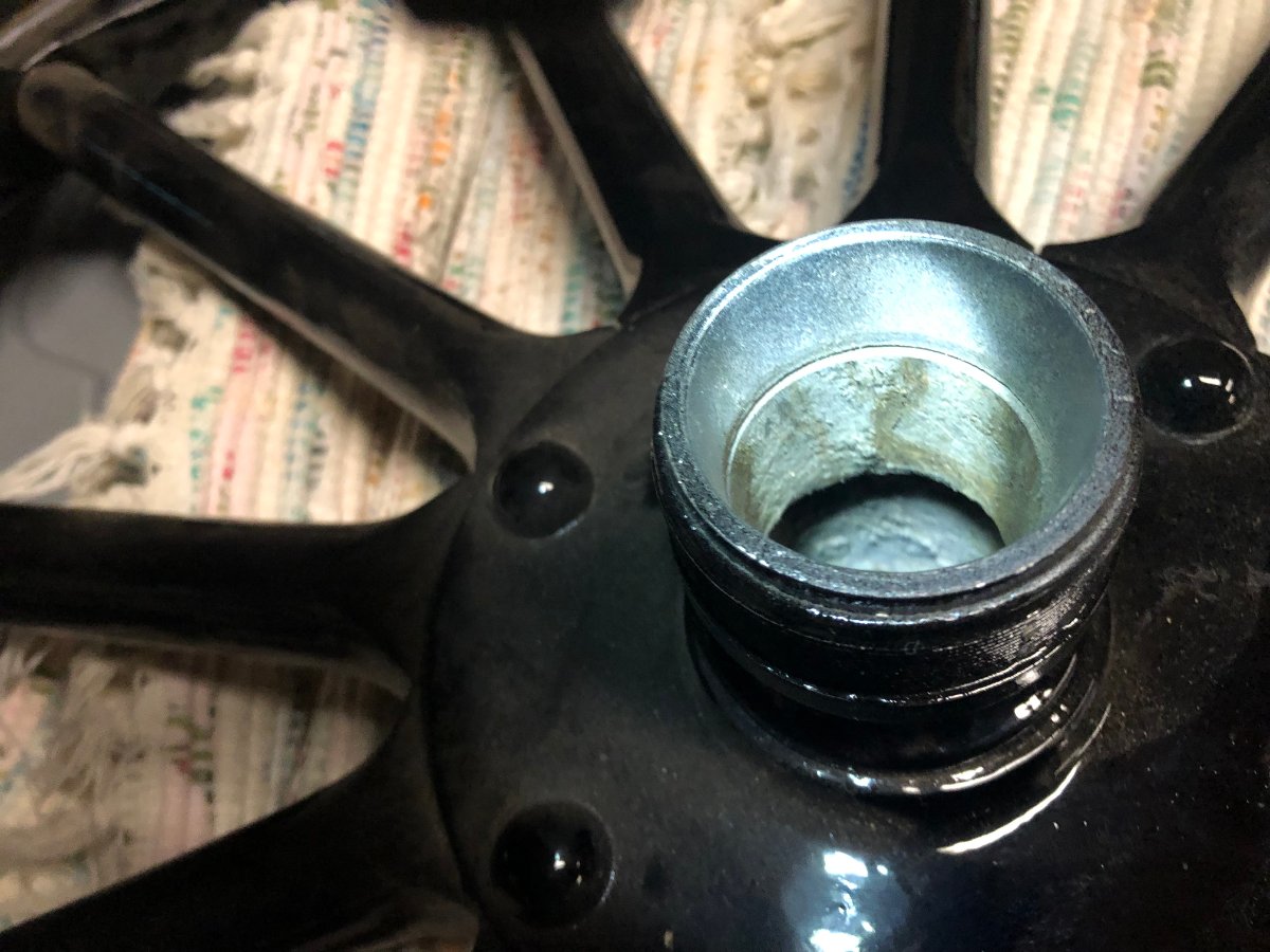

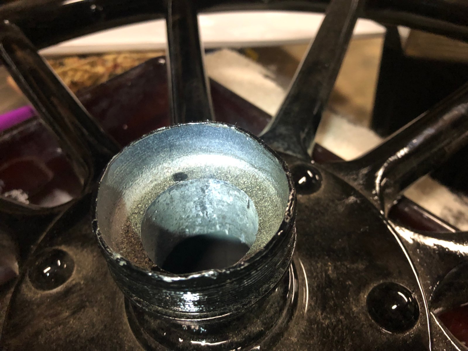

it appears that I have two different front hubs. One is of thicker construction with grooves in the inner and outer race areas. The other is of thinner construction, slightly shorter and no grooves and appears to be slightly egg shaped on the outer edge. Both were rebuilt and painted when I got them. What do I have and what would you recommend? Art

Re: Wheel bearings.
Post by dykker5502 » Tue Jun 25, 2019 9:37 am
The lower one still has the outer race of the bearing in the hub. Hence the difference.

Re: Wheel bearings.
Post by Art Ebeling » Tue Jun 25, 2019 10:14 am
Thanks fo pointing that out. Art

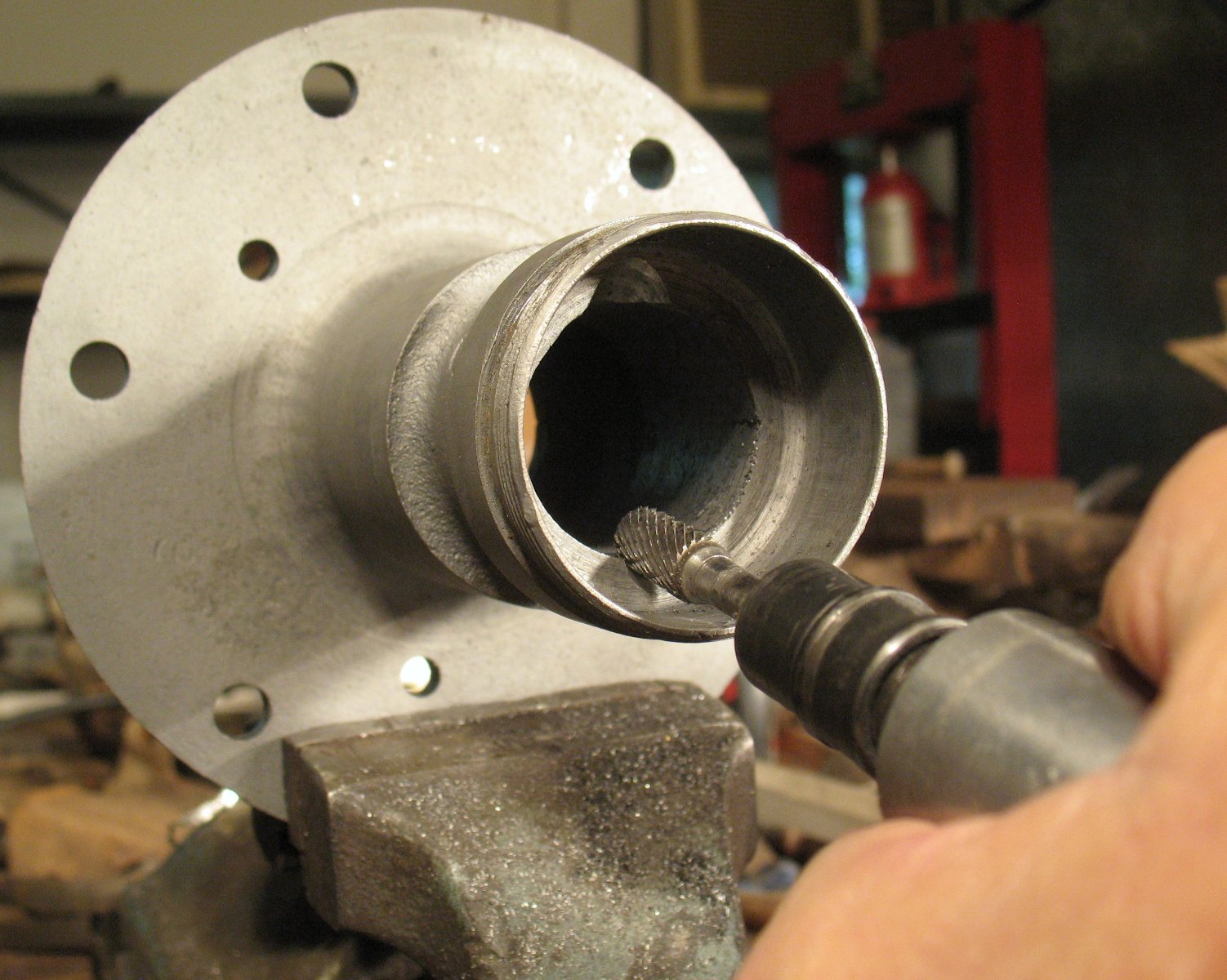

Art, if by grooves you mean notches for driving out bearing cups, that hub is a later one made for Timken bearings. The ball bearing cups are wider and you don't need a notch to drive them out. When I made the front wheels for my 1915 (had Noah Stutzman make them) I used 1917-1918 hubs because they are heavier duty but still have the machined flange for a speedometer gear. They were made for ball bearings, but I added notches and used Timkens. The heavier hubs did not split. I don't hold out a lot of hope for your WTB ad. Some ball bearing parts are readily available, but others are made of unobtainium. That's the main reason I used the roller bearings.
Cutting notches for Timken bearings.

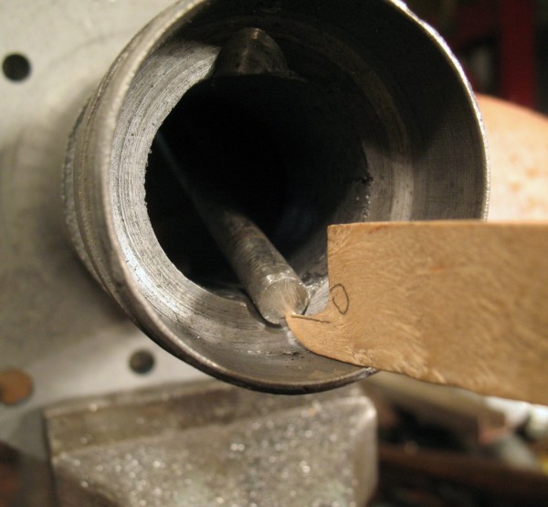

Checking notch depth. The stick shows that a drift pin will be able to reach a roller bearing cup.

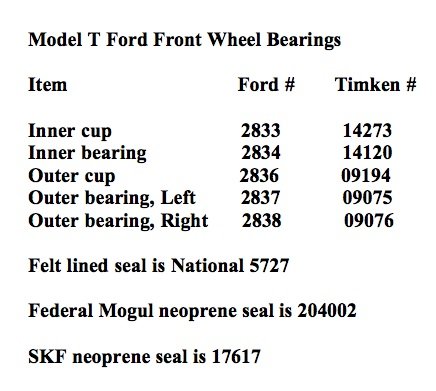

If you have no luck with the ball bearings and want to go with rollers, these are the numbers. The best prices are usually at Rock Auto.
