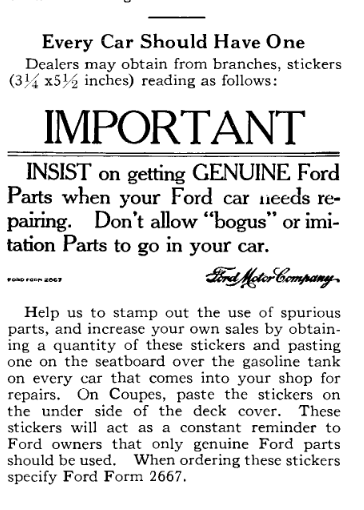

Early 1919, the first 2 issues of the 1919 Service Bulletins expound a great deal about spurious and inferior parts. The first one that comes to mind for me is that was when they started stamping the Ford script onto the front cross member (early to mid-1919).
Screenshot 2025-03-23 at 12-28-22 sb1919.pdf.png (80.26 KiB) Viewed 1108 times
From the 1919 Service Bulletin.
