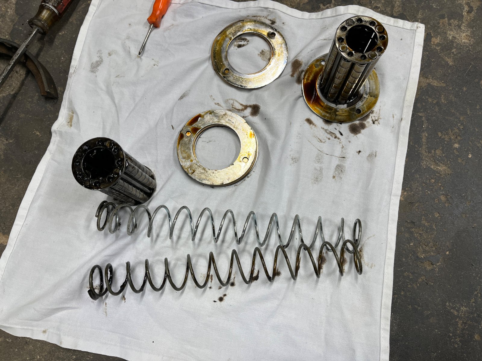

I disassembled the axle today and inside were the two large springs. They were between the inner and outer bearing and the axle shafts passed through them. I do not see these springs on any diagrams and don't recall reading about them. I also can't find a reference to them online. Anyone have insight?
Thanks!

They are an accessory item designed to wind IN the extra grease to keep the outer grease leaks down. Note they are wound in opposite directions.
IMO, they are unnecessary when using the modern neoprene inner grease seals. They could be of benefit if the seal surface on the axle is buggered up to not work with a modern seal.

I believe they are woodworth springs and do what John said. I had a set on my '24 roadster for a time but took them out when swapping an axle. Didn't really see a need to use them. Besides, if you accidentally put them in backwards ya gotta big mess, so I was told.
