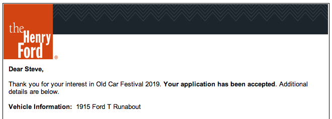

Post by Steve Jelf » Mon Jun 24, 2019 9:46 pm
Now I have to get it put back together. :D

Nothing like the incentive program. I have confidence you can do it.
