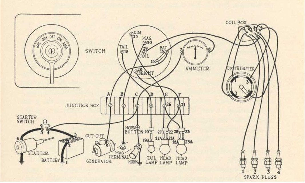

Here you go.
Ron P.
Ron P.

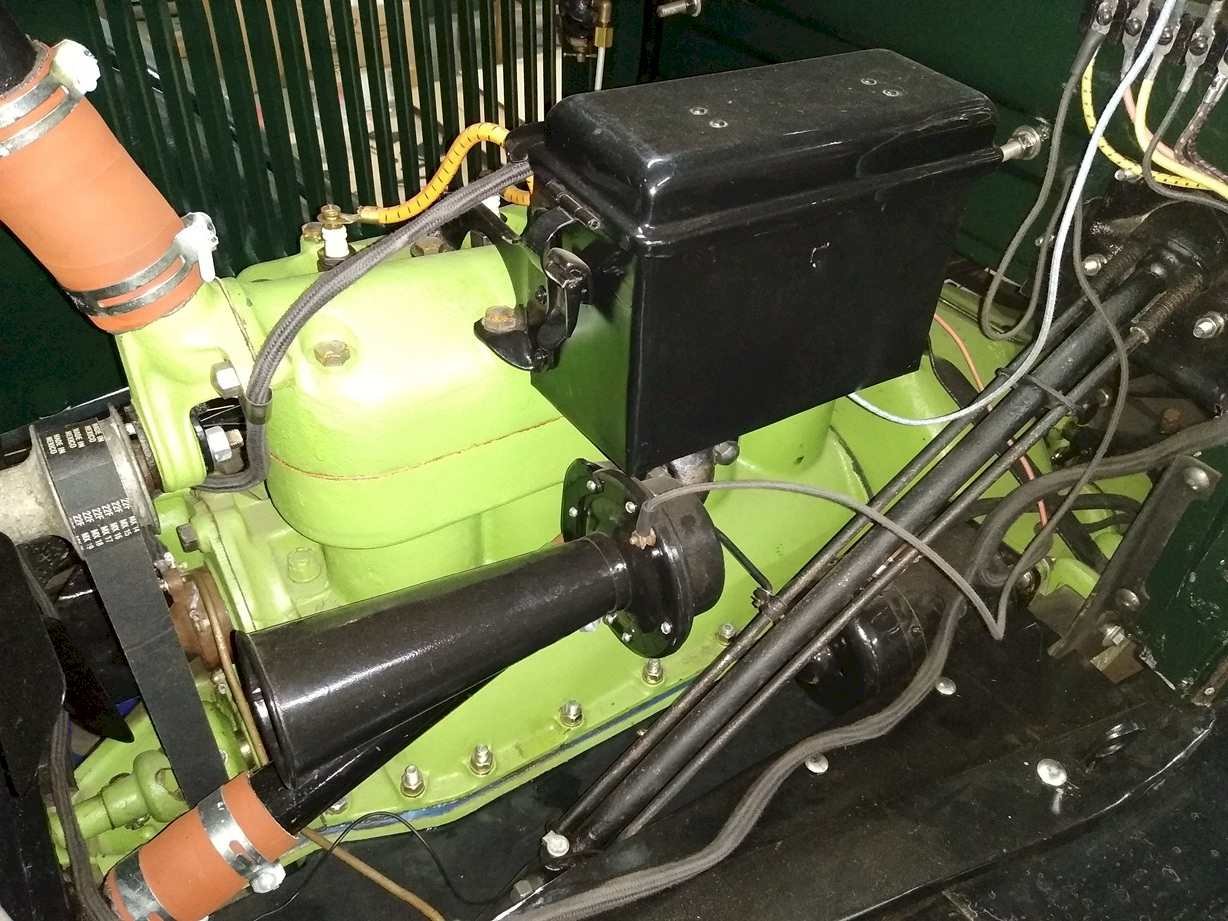

Be careful in testing the horn. You should have a battery horn like I do but if you have a magneto horn, then things can burn up. Positively identify the horn first. Also, if you are having electrical problems, now would be a great time to install a fuse if it does not already have one.

Here is a photo of our Battery Horn. The back side is larger than a magneto horn.

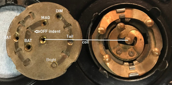

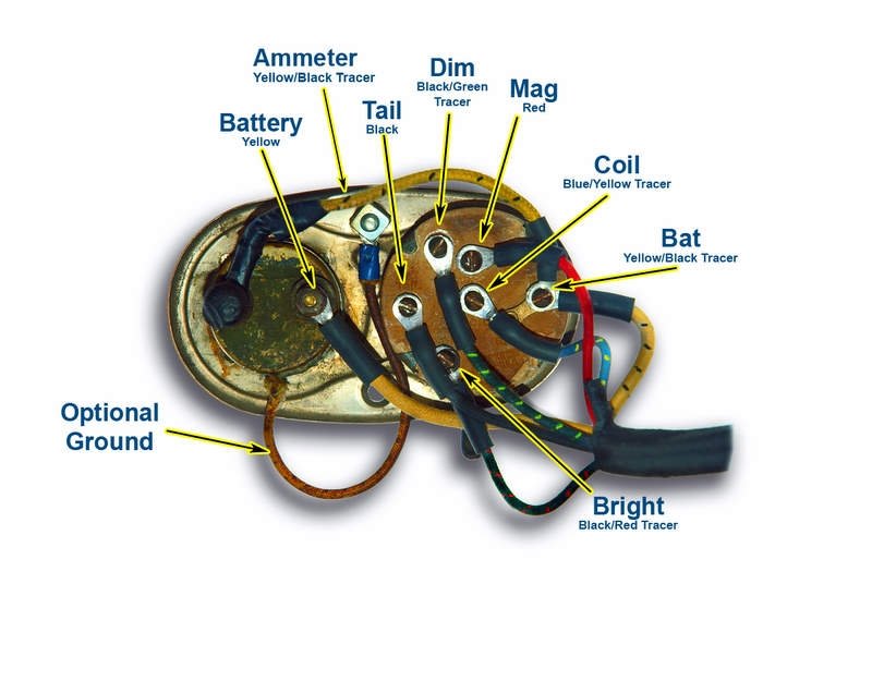

Here is the switch wiring. You may need to take it apart and bend the tabs a bit for better contact.

Besides a possible wiring issue the headlights, there could be an issue with the switch itself.
But the first thing to do is make sure its not a wiring issue. DO NOT take the switch apart until you have confirmed that the wiring is OKAY
You didn't mention if the tail light worked when the switch handle was on DIM.
There are two different style backing plates, one with pins that secure it in the cup with the switch parts or one without pins that held in place by tabs on the cup as in the diagram.
The switch is actually two switches in one. The key selects the power source, BAT / OFF / MAG, while the handle selects the lighting choice.
Some simple tests
- If you turn the switch handle to select a lighting choice, you should feel some drag & some indexing into the dimples on the underside of the backing plate. If not, possible warped backing plate. - If you turn the switch to DIM or ON, check the tail light to see if it is on even if the headlights aren't on. That is possibility since its powered via the switch independently. enough for now
Some simple tests
