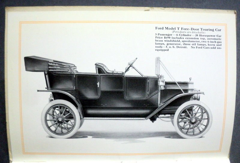

One of the other things I did not mention is in my personal database I have listings on car serial numbers, ID (dash tag) numbers, and body makes with their body numbers. There is absolutely no linear correlation to the numbering sequences. I know of a car s/n 93XXX with a Beaudette Body 15XXX without fore-doors and a car s/n 86XXX with a Beaudette body 22XXX with fore-doors. I was taking with Trent Boggess about it one day and told him that it seemed as chassis numbers were generally linear, that is first-in first-out inventory, but the bodies were first-in-last-out. Trent confirmed with me that during that era of production the body inventory room indeed had only one door. So the inventory room would accept deliveries and when a body was needed for production they would get the body closest to the door. Consequently we have an example of a very late car paired with a very early body.
Here is an interesting image from a Ford publication showing a step-side body with straight-top fore-doors:
If anyone here has a late 1911 or early 1912, please contact me.
