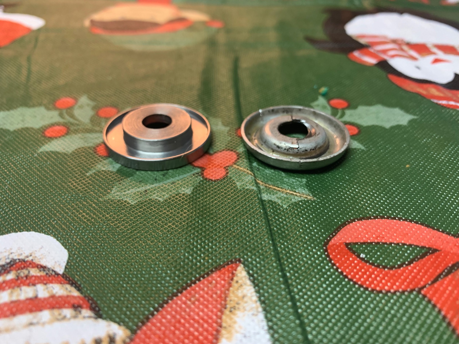

Do your self a favor. Research Model T valve cup failure.
I only put new valves from 351/390 in the engines I build. Using modern locks and keepers.

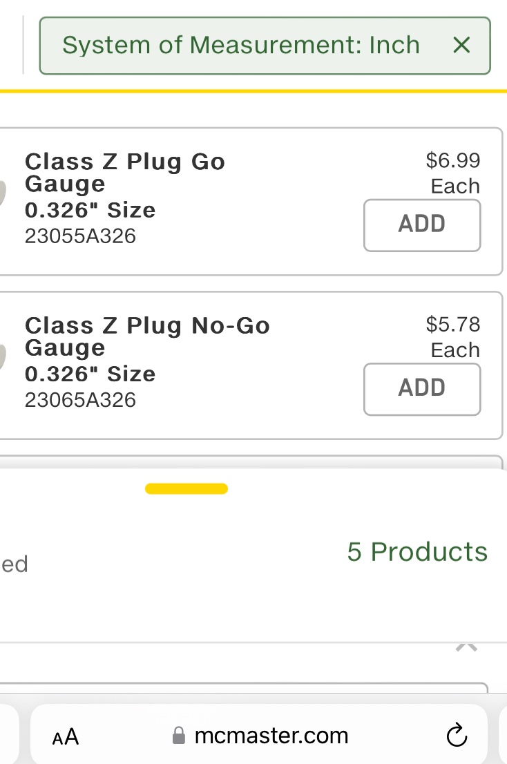

To check your guides, you can buy gage pins at mcmaster-carr for about $6.00 in .0005 increments. Buy the low and high of the tolerance based on the actual replacement stem and total stem clearance spec. The vendor may be willing to mic the stems for you.

I had a valve cup fail on an engine that I just put together and when I took it apart there were multiple had cracks where the little pin goes through i’m almost every one. So I created a solution. I made a set out of billet stock. I wanted to make sure that never happened again because that’s a good way to get stranded,. Thank God, I was able to find the little pin. So that taught me not go cheap and try to reuse old parts unnecessarily

It was not used parts I am talking about. It is the reproduction washers and pins.
That is why I only install modern valves and locks in engines I do.
When have you heard about a 390 dropping a valve cause the lock failed?

.0025-.003" is the total clearance. In that case you would feel some wobble. If you find a gage pin that is a slip fit to the guide, mark it up with a sharpie pen and slide it straight down the bore. Look for an even ink wear all around.
