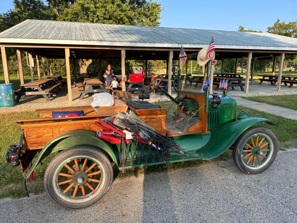

Replacing the coil box on my late cousin's T
Post by HoosierFordMan » Mon Mar 31, 2025 12:11 am
I am replacing the coil box on my 27 Model T truck. This is a family T that my late cousin had for years and had some, let's say, imaginative wiring practices. This is a T that my Grandfather pieced together in the 70's, so I have to get the serial number on the block to accurately date the engine. But I'm wondering where I could find proper wiring diagrams as the MTFCA Model T Electrical System manual is lacking in this area. There is one hand drawn diagram in there but I'm hoping for something more standard.
Since this car has a dashboard with light switch and ameter, I don't believe It should have had a switch on the coil box. The connections internal to it became loose and started causing issues but the modern lock my late cousin installed on it couldn't be removed without destroying the box, sadly. It has a starter that only succeeds in becoming very hot so I hand crank it but otherwise runs like a top. Any help/advice would be greatly appreciated. Thank you
[image][/image

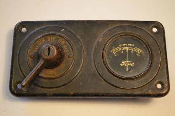

Looking at the set up on your truck there, It looks like its got a typical headlamp switch / ignition switch combination for that year, combined with the amp meter next to it. Only difference to a "typical" Model T is that your switch unit appears to be mounted on a block of wood, instead of the metal dash that Touring cars have.
Just one thing, I notice you said your truck is a '27, there is a slight variation to wiring coloring, which I have made mention of on the circuit diagram.
I have attached a reference picture below...
Model T ignition switch

First things first. It is not a truck. It is a nicely fashioned vehicle based on a car chassis. If it was a T truck it would have a heavy worm drive rear axle, very short running boards and no s[lash aprons.
As it is, it will run with standard Ts at car speeds rather than the slower speeds of true TT trucks, and most people would see that as a good thing.
The only 26-7 parts I see is the rear wheels with large brake drums. The rest looks earlier. Many put-together cars have a variety of parts used in the build, and that too is of no consequence for some people.The bigger emergency brakes on the back are a bonus for performance.
The switch panel and ammeter are for a pre 26-7 and on a flat wooden dash like you have, would be mounted on a panel bolted to the firewall and angled back to carry the switch and gauge. These were available from the vendors. That would make rewiring easy using stock looms from the vendors.
Commercial vehicles can be much more interesting than standard factory issue Fords.
You can play with yours just as you like without the constraints some chose to impose on themselves trying to get everything factory correct. It is a vehicle with which you can have a lot of fun.

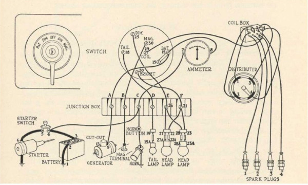

To go along with the wiring diagrams already posted, here's one that will be very familiar to those who have been here for several years.
The switch shown here has two controls. One, operated with the key, turns the ignition on and off. The other is a handle with various positions for the lights.

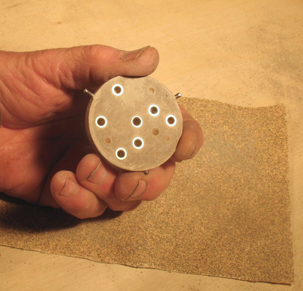

Over the course of a century the back plate in the switch may have become warped. Chances are you don't have to buy a new switch. A warped back plate can often be flattened by rubbing it on coarse sandpaper. If that makes the non-conductive stops too shallow you can carefully deepen them with a drill that fits.
There are two types of back plates. One has pins, like the one in the picture. The other type is held in by bent-over metal tabs. To remove the back plate you have to pry the tabs open slowly and gently. Before reassembly you should turn the tabs red and let them cool to prevent breakage when you bend them over again.
