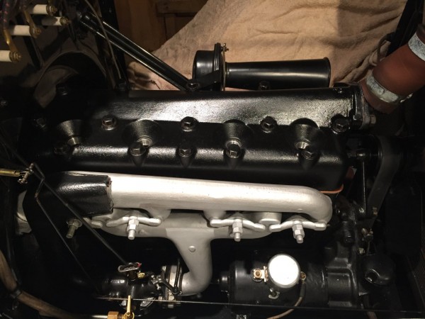

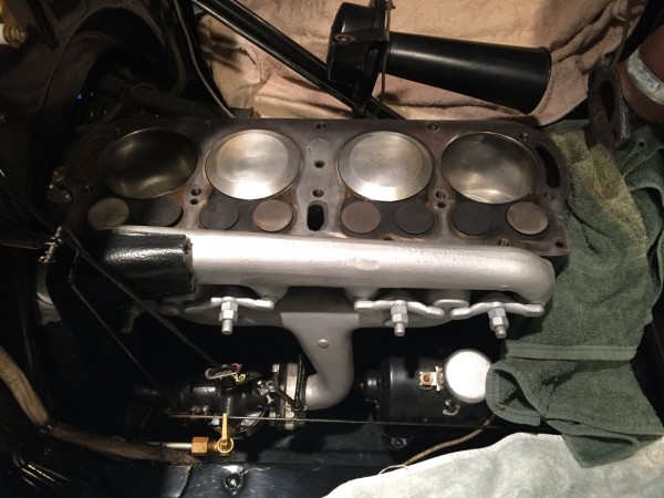

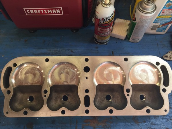

Well i finally decided after much thought, and some inspiration by others i know, to install the Prus head i have had sitting on my shelf for a few years now.
I still have a few questions that i hope some of the great minds here can answer. From what I've read, I'll need less advance for normal operation that i usually run V.S a stock head, and its better to drop the spark gap from .030 which my engine prefers now, to .025 for the H/C. Any thoughts and experiences would be greatly appreciated.

Got it done today without a hitch, and will run it tomorrow. Had the head off about 600 miles ago to replace the valves and add adjustable lifters and it looks like everything is working pretty well inside.

Not advice but a comment on the head design: The combustion chamber has a squish area above the piston which creates a lot of turbulence during ignition. This speeds up the burning of the air/fuel so less spark advance is needed. It also increases the efficiency of combustion which leads to more power.

Got it running today, sounds great. Still playing with the timing to find out what it likes best. I used to run it about a 1/2" inch from the bottom, but now it seems to like it a lot further up, like about 2/3rds down. Also still playing with the plugs and mixture as it seems it might like something different from before. I was always under the impression that you should reduce the gap to .025 with these heads, or maybe not.
One thing i did notice is that the exhaust tone is definitely different, and it seems to run a little cooler. After fiddling with it today in the yard for a half hour in 85 degree temps, it didn't even gurgle after i shut it off.
One final question if i may, Did you find after installing a H/C head you had to re-adjust your fuel mixture from where you had it set prior? Thanks Again, and short vid below.
