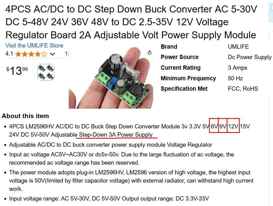

Was wondering if this would work. Magneto to Buck Converter then one to power each bulb circuit depending an amp draw if necessary
Supposedly a buck converter will provide constant out voltage

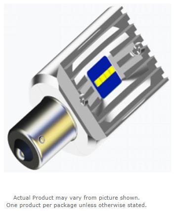

Ledlight.com sells a headlight bulb that will work off 5 to 30 volts a/c or dc non polarity. Need to wire headlights in parallel instead of series. single pin contact bayonet base. Technically according to the specs it should work off model t mag. Unit has a built in voltage regulator so light output should be rather constant from low to high rpm ? I don't know. Haven't tried it. But might be worth investigating.
LED Headlamp 5 to 30 Volt CSP

[image]
LED Bulb.jpg (19.15 KiB) Viewed 2700 times
I have not tried them and do not have a mag headlight car. I skip from brass to starters in my fleet.
Here is my opinion on them, I do have a few concerns/questions about them.
Brightness, current, lifetime, color, size and materials all look good.
The double sided construction is good but it has to be rotationally aligned for the proper light pattern. Did the pins on the base get aligned correctly?
It uses the stock reflector, does it place the light at the correct depth to be able to have a decent focus?

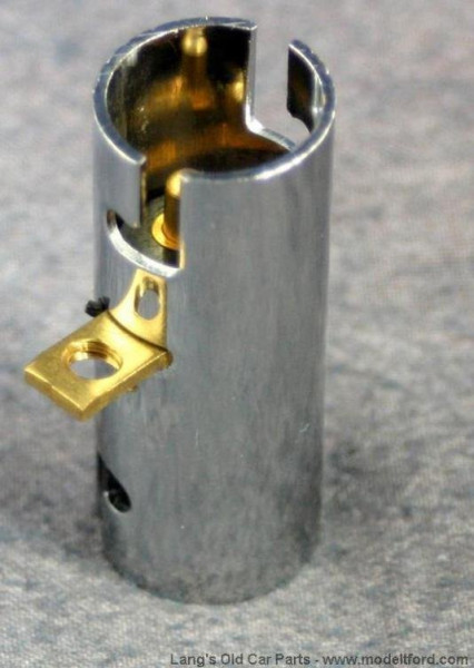

The socket (Part #6574X) will have to be changed to install this. I do not know of a BA15S socket with screw tab to install in the headlight bucket. Not sure how to solve this without creating custom parts. I have installed single pin bulbs in dual pin sockets with mixed results. No matter what the stock wiring MUST be reworked to avoid shorting the magneto and burning out the wiring.
It has a wide voltage range with a built in voltage regulator and this is what is needed for a magneto bulb. But I believe the stock dimmer assembly will produce a car with 2 high beam settings. This may or may not be a problem.
I am concerned about the comment in the listing about maybe needing a resistor to fix a flickering issue or poor low beam operation. I don’t know enough about this to make judgment here.
I am also concerned about burning out the bulbs when running high speed with a hot mag. The rating is up near the voltage limit so it should work. But the magneto power is noisy power, there might be garbage and spikes that will damage the bulbs? I don’t know how strong they are at the upper limits. I worry about this because I have burned out several electronic things on my car due to this including my Arduino GPS Speedometer. It worked great on my modern cars for many hours and Rusty (my 26 touring) smoked it dead in about 1 block.

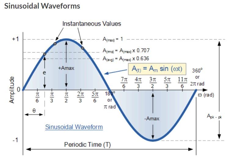

Ok, here is some voltage theory.
A.C. = Alternating Current it is a voltage source that rises and falls in a cyclical pattern called a sine wave.
It can be thought of like a crankshaft rotating and the piston going up and down, plotted over time the piston position is a sine wave pattern. if you use the center of the crankshaft as zero you can see that you have both positive and negative pulses. See the enclosed picture. Rarely is AC all positive or all negative so we will not discuss this special situation.
In a crude way AC is just reversing DC really fast.

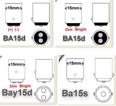

The 1157 bulb is mention but it can not be used because the 1157 pins are offset and the Model T uses parallel pins.
The magneto bulb power comes in one contact and out the other not using the shell in the circuit. This is how the bulbs are wired in series.
The battery bulbs use the same base but in one pin for low and the other for high with both using the shell as a common ground. These bulbs are wired in parallel.
See the enclosed picture as to the differences between the bases and how they are hooked up.
So many details have to be correct when choosing the correct bulb for your application.
