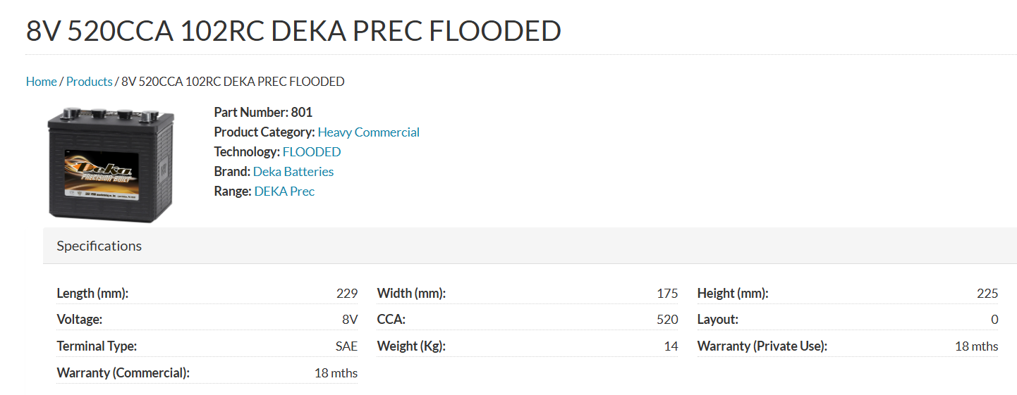

Since we’re on the 8 volt battery subject; where is the best place to acquire one ? And do you use a golf cart 8 volt in your antique car ? I’ve been trying for well over a year to make a 6 volt positive ground battery work in my 1950 Ford - to no avail. Traveller 6 volt batteries from TSC are junk. Been through 3 batteries and 3 starter motors. Found a possible 8 volt at NAPA for $219. Batteries + quit carrying 8 volt batteries and, yes, I’m using 00 cables, bought a new solenoid and triple cleaned grounding surfaces.
Any ideas ?
Any ideas ?
Kerry
- Posts: 1464
- Last Name: van Ekeren
Re: 8 volt
This one I use in my Ts, same size as a T battery box and original 6 volt battery size.
- Posts: 5284
Re: 8 volt
Interstate batteries. They sell a large & a small. The small fits a T. Retail about $175.George House wrote: ↑Tue Apr 15, 2025 8:00 pmSince we’re on the 8 volt battery subject; where is the best place to acquire one ? And do you use a golf cart 8 volt in your antique car ? I’ve been trying for well over a year to make a 6 volt positive ground battery work in my 1950 Ford - to no avail. Traveller 6 volt batteries from TSC are junk. Been through 3 batteries and 3 starter motors. Found a possible 8 volt at NAPA for $219. Batteries + quit carrying 8 volt batteries and, yes, I’m using 00 cables, bought a new solenoid and triple cleaned grounding surfaces.
Any ideas ?

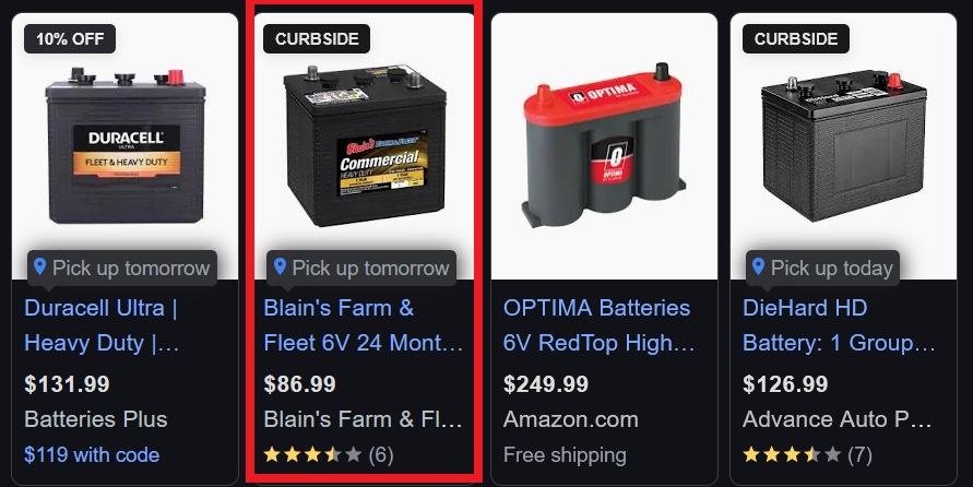

- Posts: 6607
Re: 8 volt
For what its worthGeorge House wrote: ↑Wed Apr 16, 2025 2:12 pmVery interesting Frank. Thanks for the education. I hadn’t considered that. Makes sense tho. Guess I didn’t realize reasonings behind battery design. Still don’t know best Class 1 battery to acquire..
A Model T is not a modern car so ones thinking needs to be adjusted as to its needs. Many new cards have small drain electric devices that run all the time even when the car is shut off.
Battery selection should consider:
How frequently will the car be driven.
How will it be charged while driving. Cut-out, Voltage regulator, Fun Projects Magneto.
What does it need to power while driving other other than coils and duration of use.
---- Tail lights & headlights filament or LED can have little effect if battery charged while diving & can even help battery live if turned on/off to ---prevent over charging
---Just Coils then "golf cart" battery. Have starter "starter" battery
Infrequent driving or cold winters - smart charger/trickle charger too.
Since there are only 3 Major Battery Manufacturers in the USA (Johnson Controls, Stryten, and East Penn) branding batteries for different retailers its a tie. Cold Crank spec is not the measure to use for a Model T. Reserve Capacity & Ah are good comparisons to Battery Cost
Every battery I have ever bought was from my local farm supply (Farm & Fleet), usually 2- 3 year warranty and never replaced one of theirs
Can buy 3 F&F (Reserve Capacity: 130 minutes) to one Red Top (RESERVE CAPACITY of 100 minutes)
