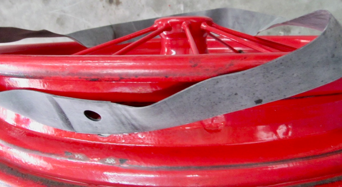

Once had a he*% of a time removing a tire from a wire wheel, that tire would not come off! Someone had placed a flap in the wheel and moulded to the drop center and the wide flap wouldn't allow the tire casing to drop down for removal. Out with the super long TT tire tools, and worked that tire and tube and flap off...... :twisted: :twisted: If you have ever tried to remove a tire with a flap from a wire wheel you will advise all you know to never put a flap in the wire wheels!
All you will ever want to use is the rim strip to protect the tube from the Ford welded spoke nipple bumps in the drop center.
