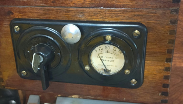

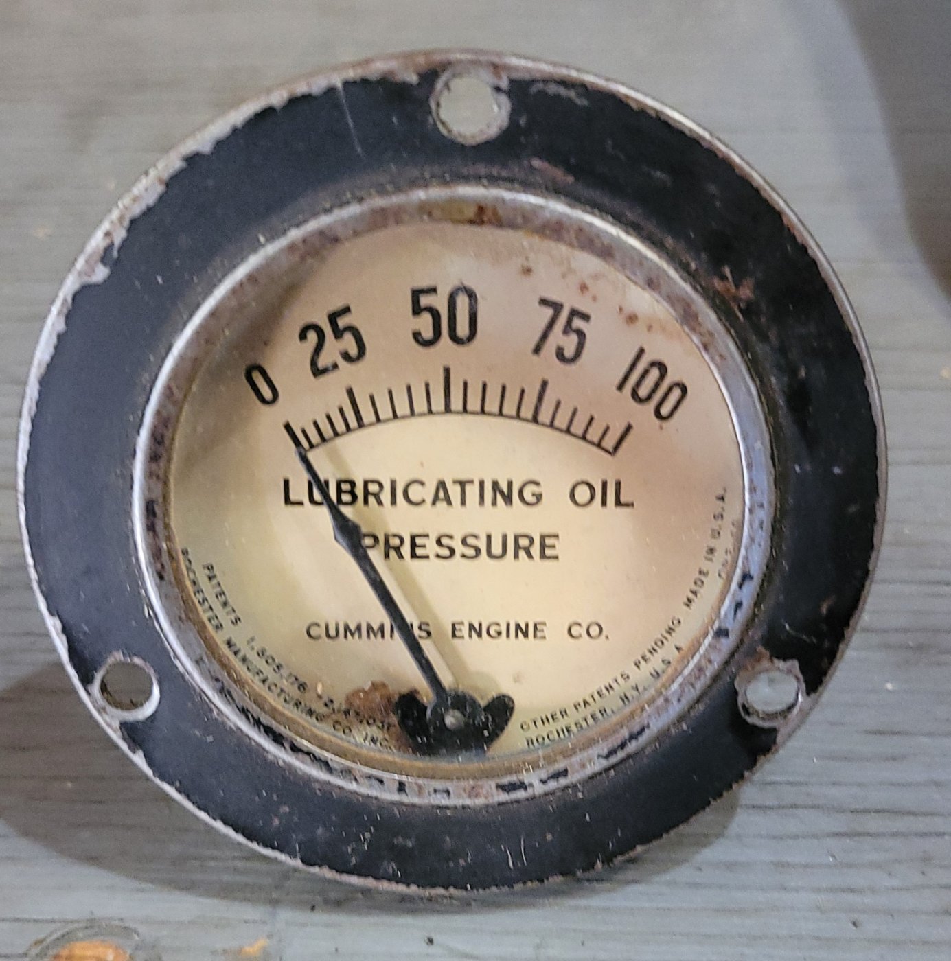

Re: Oil pump pressure
Shall I use this old timey gauge?
Kevin Pharis
- Posts: 1655
- First Name: Kevin
- Last Name: Pharis
- Location: Sacramento CA
Looks good to me! Just keep in mind that the gage port on the oil pump is 1/8”-28bsp (British Standard Pipe), not 1/8”-27npt

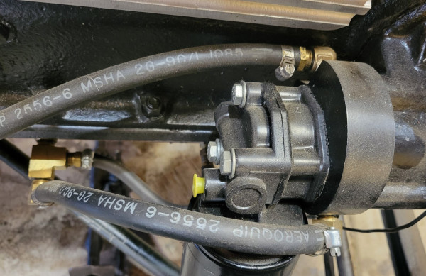

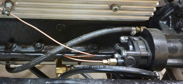

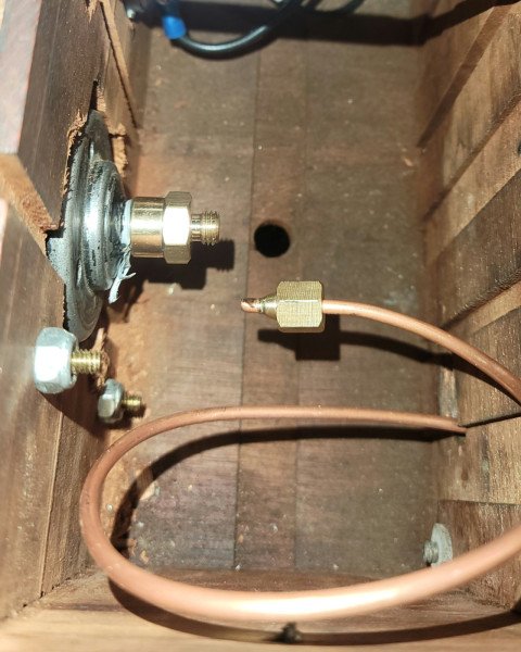

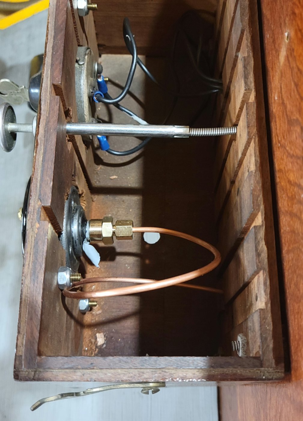

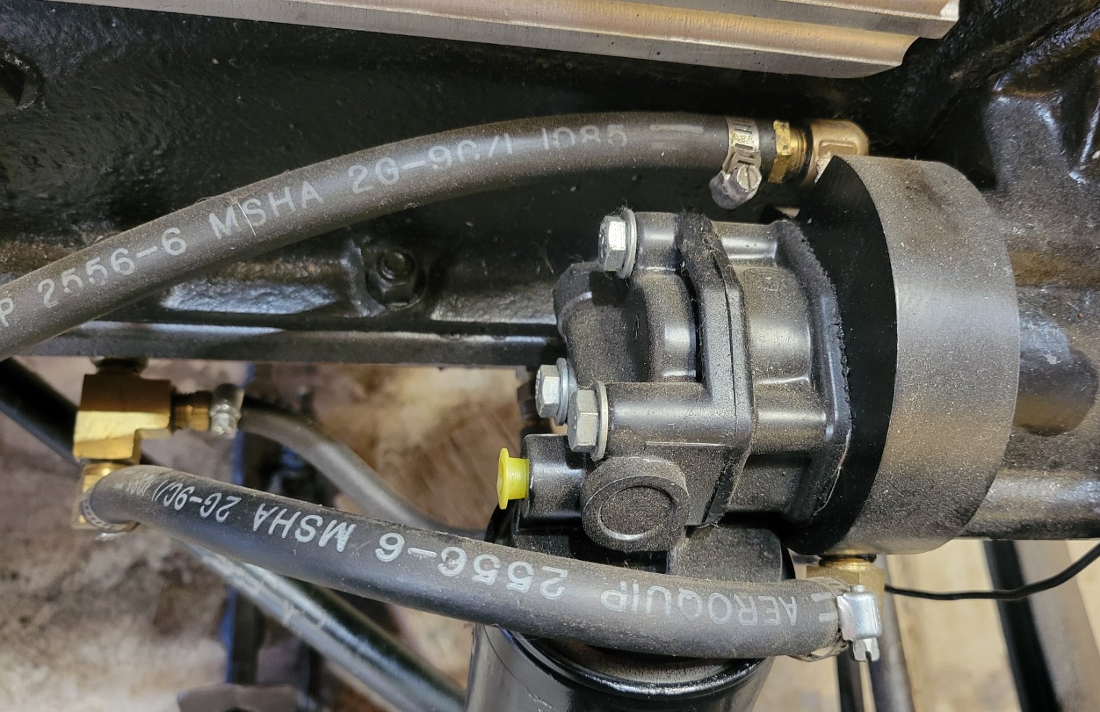

Topic author - Posts: 1520
- First Name: Keith
- Last Name: Townsend
- Location: Gresham, Orygun
Update pics...
- First Name: Keith
I put in 5 quarts of oil. Is there any procedure for priming a B-210 oil pump?
Should I crank it over by hand and bleed the line until i get some oil to the gauge?
Kevin Pharis
- Posts: 1655
- First Name: Kevin
- Last Name: Pharis
I suggest pulling the coil wire and cranking it for a short bit with the gauge port open. Be sure to pre-fill your oil filter to ensure quick response. If no oil, possibly use a hand held vacuum pump do draw oil in from the gauge port
- Posts: 5618
- First Name: Henry
- Last Name: Lee
I recommend filling oil filter completely, disconnect oil lines , outputs on pump, and fill with an oil can and turn engine by starter. Works everytime.
