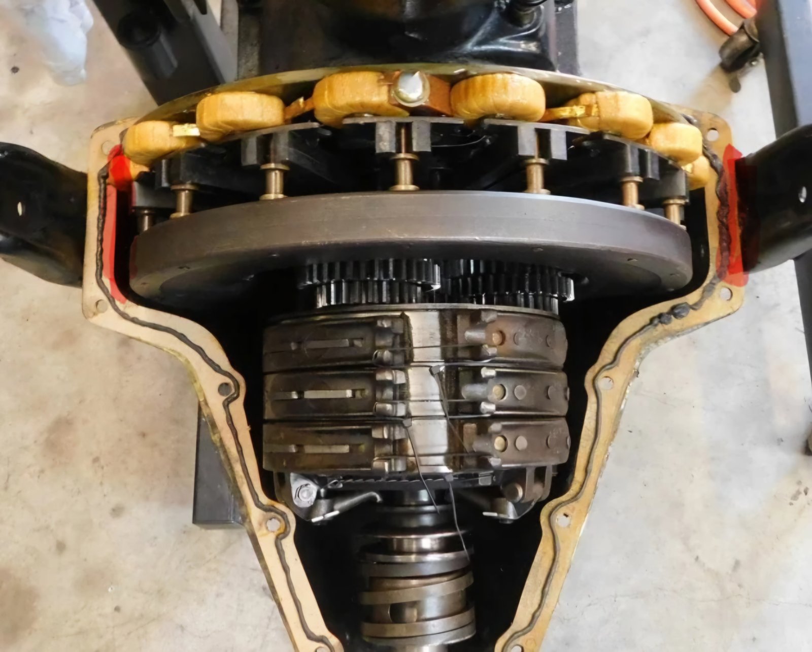

I'll start by stating I have used various gasket sealers over the years and Aviation Permatex is my gasket sealer of choice. If applied liberally to both gaskets and bolt threads during assembly, it does a great job of reducing oil leaks. After assembly, clean the excess off with a rag and gasoline. Let it set up and your golden.
Regarding leak proofing or modifications. All those mentioned above are great suggestions and recommended as well. One area often overlooked and very prone to leaking oil is the area of the pan where the frame arms are located. When using a pan straightening table, it is impossible to access the flats as the arms are in the way. A straight edge across this area will show a significant dip between the front and rear bolt holes. You have two options to minimize the likelihood of leakage in this area. The first option (my preferred method) is to drill two 3/8" holes is the arm to allow access with a punch. Heat the area with a torch and flatten with a round punch. Once satisfactory, weld the holes up and finish grind. The other option is to double up the gasket material in the area and apply a very liberal amount of Aviation Permatex on all mating surfaces. Install the transmission cover bolts as usual. Wire off excess with a rag and gasoline. Let dry for 24 hours.
Lastly, when installing the transmission cover felt seal, I have had excellent results by soaking the felt seal in Shelac prior to assembly. When installing the laminated shims for the field coil, I place the narrow portion of the teardrop in the upward position. This helps hold the felt in position when installing the transmission cover.
Just a few tricks learned from dad, the master Model T Mechanic, over the years. I'm sure you will also find these suggestions useful.

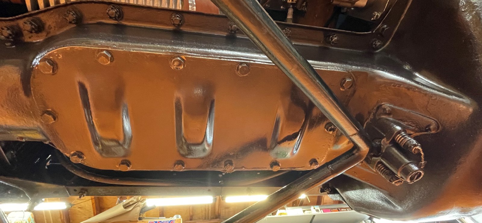

My 4 dip inspection plate has steel/ rubber washers like for tin roofing. They work great.

Terry - I used the nylon washers under the bolts on the inspection pan when I rebuilt the engine on my 1919 Speedster in 2012. I also used the standard paper gasket that is included in the gasket kits from the vendors, and "The Right Stuff" as a sealant. For the first several years, I didn't notice much leakage around those bolts, but over time, it's increased a little. No significant leakage but they do seep a little now 13 years later. Still very acceptable and expected for a 13 year old rebuild. Here's a photo of the pan; hard to tell but there's a light oil film on several of the bolt heads and around them.
