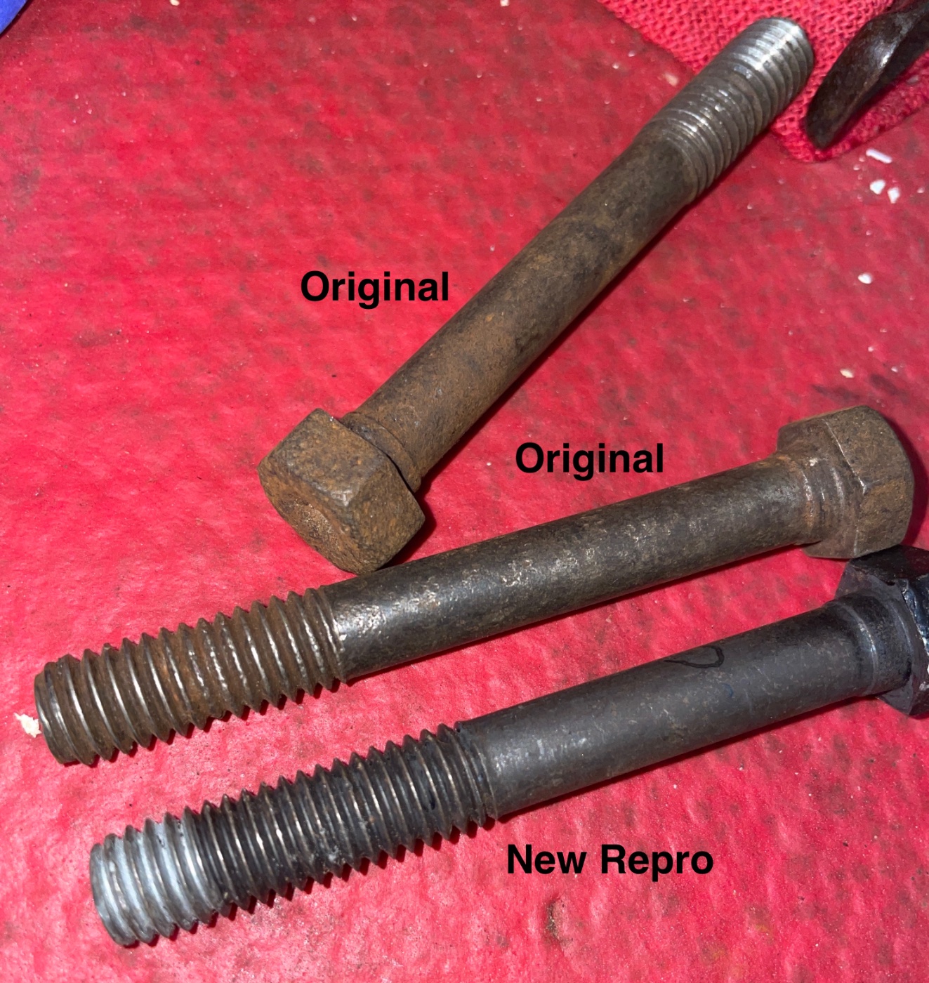

If you resort to a standard bolt, be sure to get correct length, that is most important.
The reproduction are well made, good quality, and have the correct shape under the head, note the slight collar that centers with the cylinder head bolt hole.
