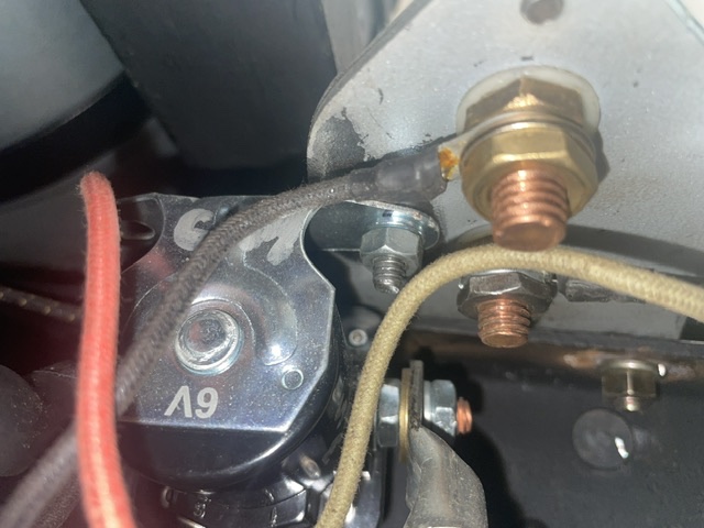

Where on the frame would be the best place to mount a starter solenoid? If you have one installed, would you please post a photo? Thanks.

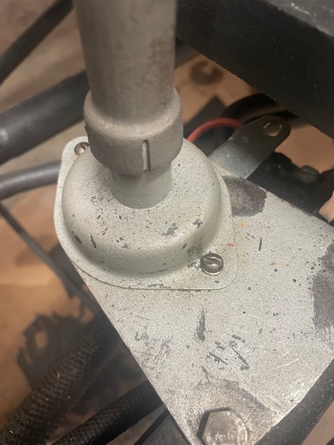

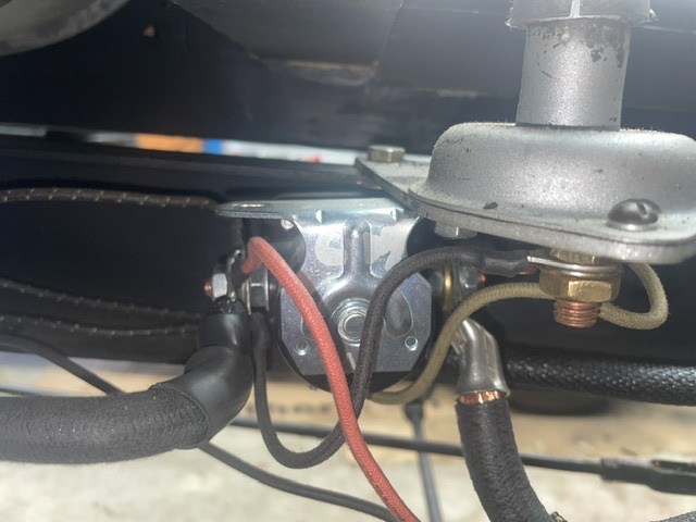

Did this install a bit different than most. Since the footswitch was apart for refurbishing, drilled a hole in the base inside the cover. To that hole added machine screw and nut to secure one arm of the solenoid.
The solenoid needs ground so the foot switch provided that.
The small wire to the foot switch was easy that way.
