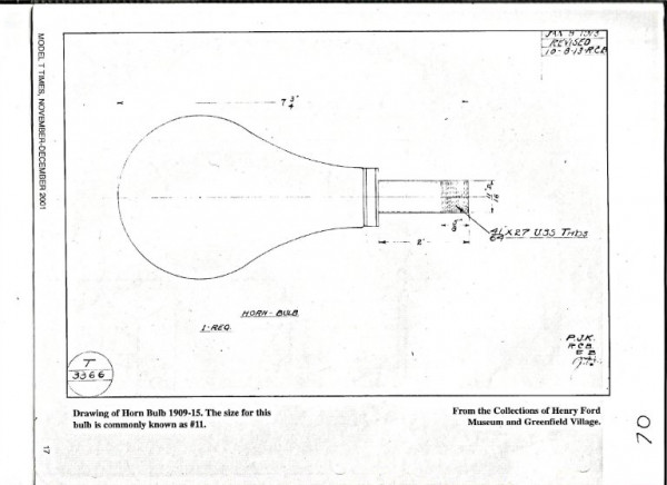

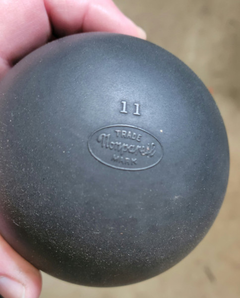

Re: 1914 Horn Bulb
Post by KWTownsend » Sun Mar 07, 2021 12:35 pm
John-
I'm glad you have the original horn and tubing. Some of the reproduction stuff is terrible. Especially the bracket!
In regard to the bulb, neither is "correct" for 1914. The original horn bulb size is a "#11, is between the two. It is about 3-1/2" in diameter. For a while, reproduction of the original size in Non Pariel and Rubes was available. I'm not sure if they are any more. If they are, they ain't cheap!
That being said, I have used both the large and small and although I have small hands, I have had better results from the larger bulb.
You might check on the interweb to look for replacement rubber horn bulb like the type used for a "Bombay taxi."

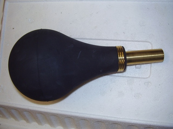

Hello John I have a 1912 T I use the small bulb from the venders it work fine ,I find that the large one just looks wrong to big and bulky . This my be because I have the original and it is small . I have removed it because every body wants toot the horn ,so to save the original bulb I installed a new one.
This is the small one from the venders

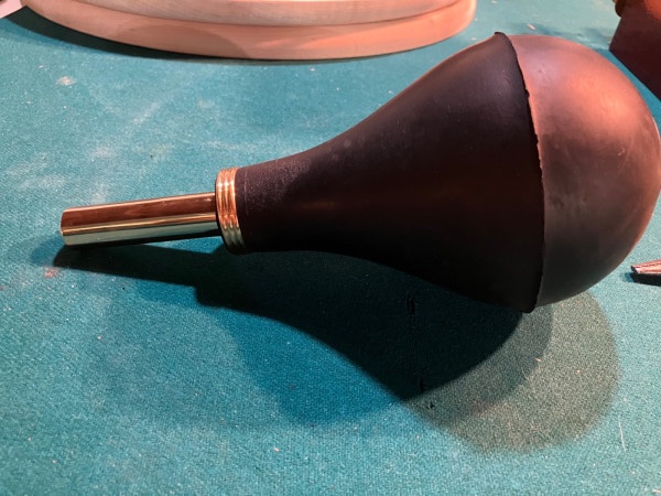

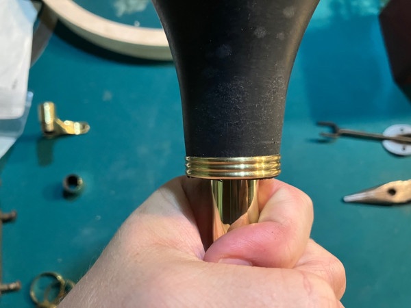

Tbird
Posts: 1348
Last Name: Bird
Location: Goshen IN
Re: 1914 Horn Bulb
Post by Tbird » Sun Apr 27, 2025 5:03 pm

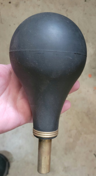

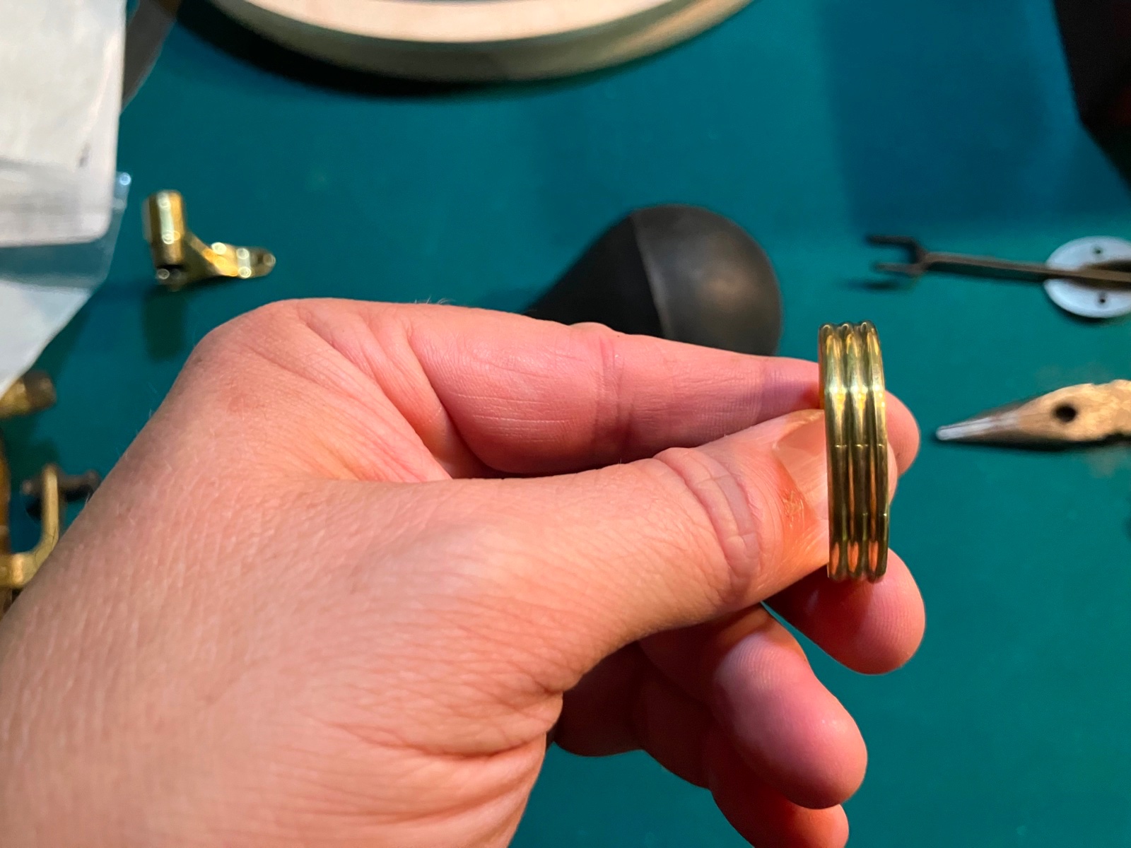

I looked for such a long time for one of RVs bulbs. Before he passed we were talking back and forth and he was gathering up some of the brass sleeves that had the goofy thread on them that I would be using on my rubes horn restoration. I finally found an original (deflated) bulb on eBay I harvested the brass ring off it and made up a few copies. I found a new “taxi” bulb on eBay that is pretty much identical to the #11 bulb size.
Of course the bulb does not have the #11 or the Rubes logo/wording. The wording is raised and the number is stamped. The ring fits nice and tight just like the original did and besides the absence of the wording look almost identical to the Rubes bulb.
I did notice that on the original bulb it was seamed together with 4 pieces long ways. If you look at the reproduction bulbs RV had made they had a seam that goes around the diameter of the bulb just like the taxi one as well.
Here’s a few pictures of the deflated bulb and the taxi bulb with the rings I made. The last picture is one of RVs repo horn bulbs.

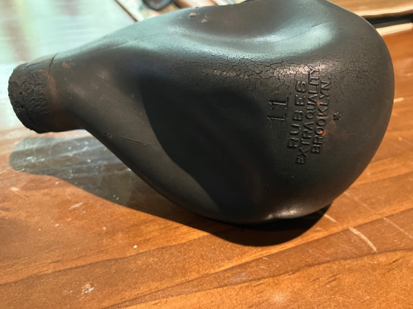

Posts: 1526
First Name: Keith
Last Name: Townsend
Location: Gresham, Orygun
Re: 1914 Horn Bulb

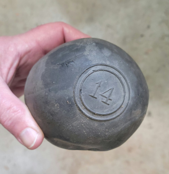

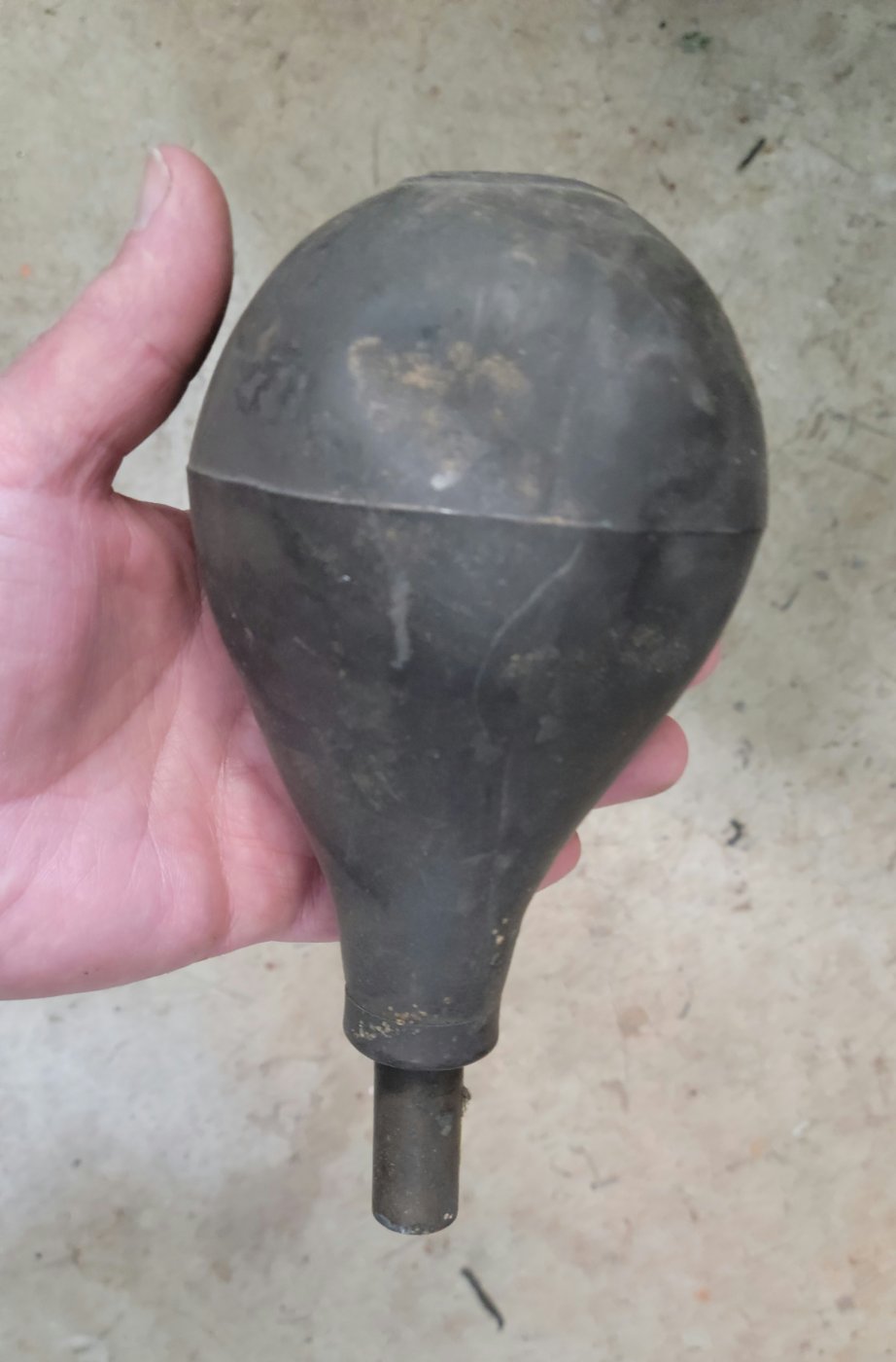

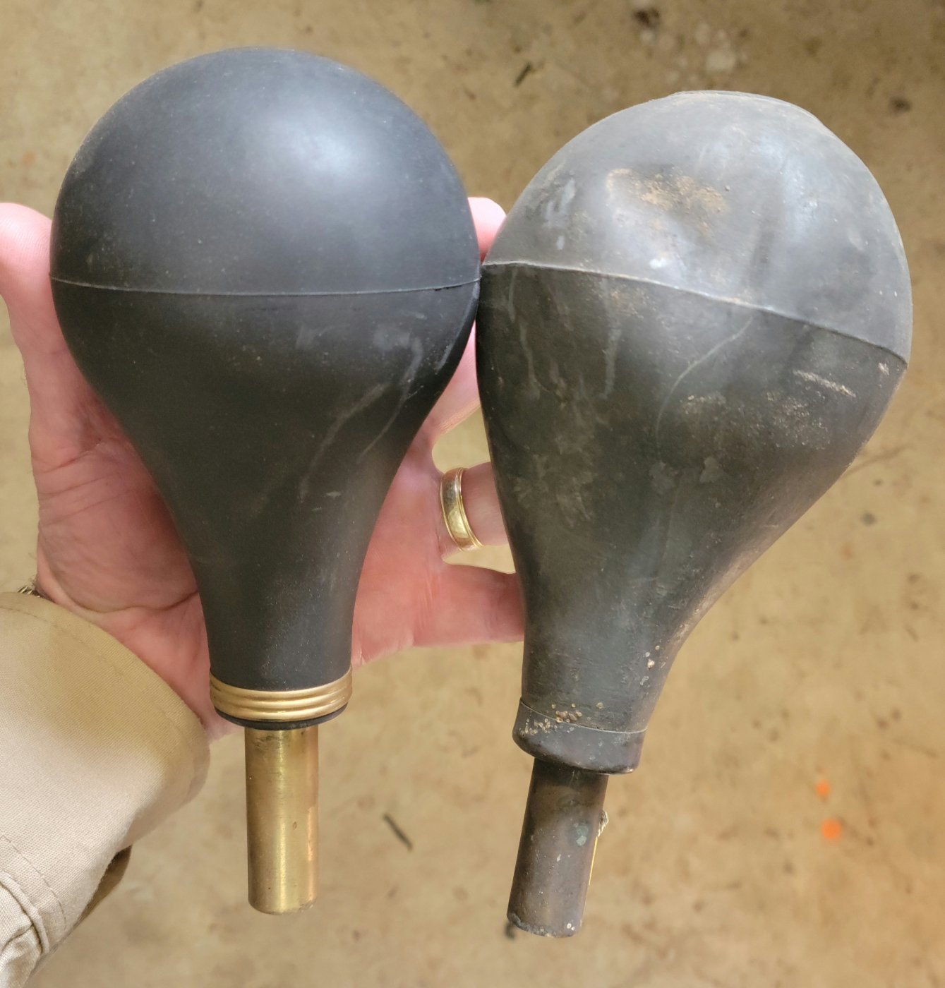

Post by KWTownsend » Sun Apr 27, 2025 7:13 pm
Petrified era horn bulb:
One of RV's:
Side by side:
