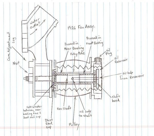

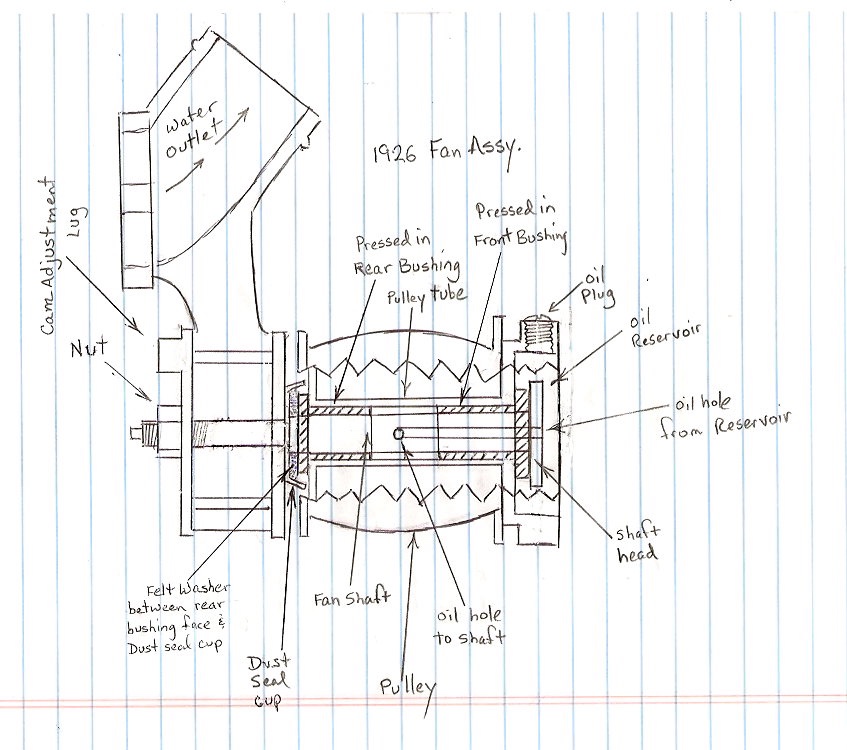

30w oil. It needs to be thin enough to make its’ way from the reservoir through the center of the shaft to the hole in the center and out of the shaft into the space between the bushings so it can lubricate the front and rear bushings. Grease or 600w oil is too thick and will only block the lubrication hole preventing any lubrication at all.

Jim, Thanks for the detailed illustration. It brings up a question though.
My hub is extended to bring the fan closer to the radiator. Most of the hubs in my spares were like the one you show but I found one long one and used it to replace my badly worn one. I had only one neck/bracket that was the squeeze bolt style, like my original, and it had the short hub. Does anyone know the evolution of the hub and neck/bracket?
