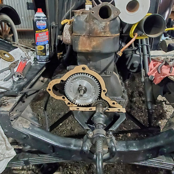

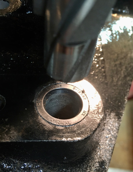

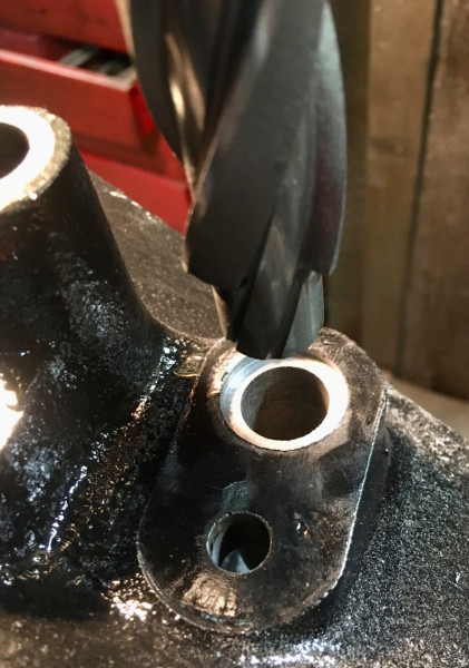

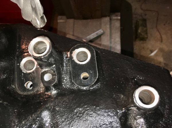

Hogs head fun! Got a counter bore and a Bridgeport. Added some oil seals to all 4 shafts.
now let’s get this thing assembled!

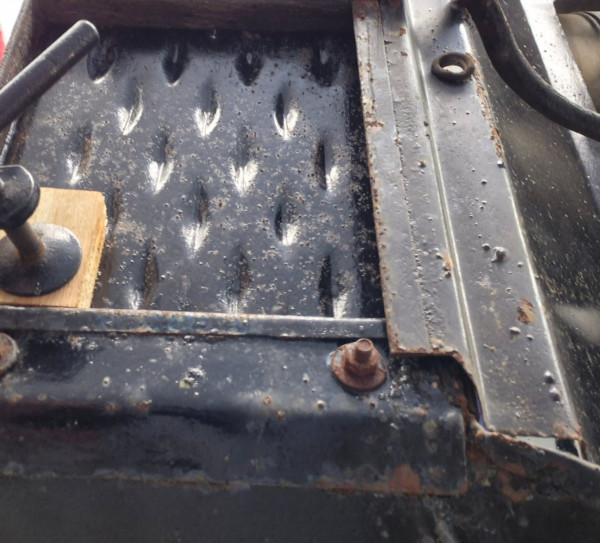

Finally got my top bows painted after many hours of restoring the wood and replacing rotted wood of the rear curve with a piece of azek PVC leftover scrap. The stuff is great for nailing and can be bent with heat. Next up: wrapping the bows, then on to the top.
John

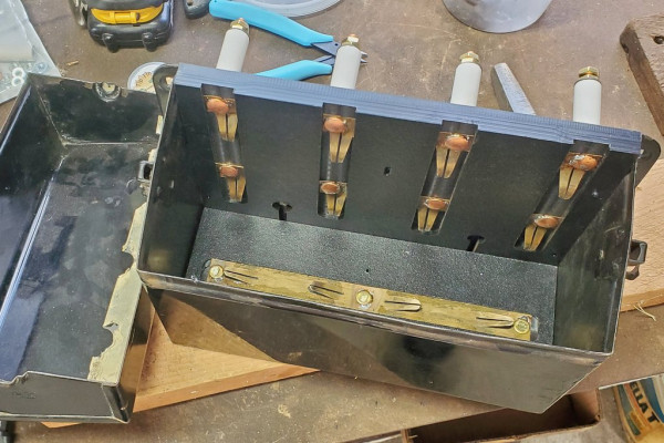

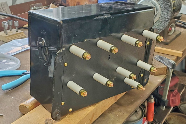

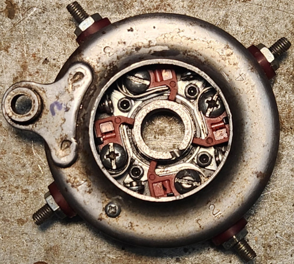

I have continued to enjoy the very smooth performance I get with my 'timer with points' which floats on a bearing on the camshaft.
About 250 miles so far....

What I like best about your timer is the reinforced hole for the rod. Mine looks like Bakelite and is worn with slop in the timing adjustment.
Vern (Vieux Carre)

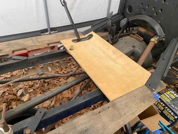

Here’s what I’m up to

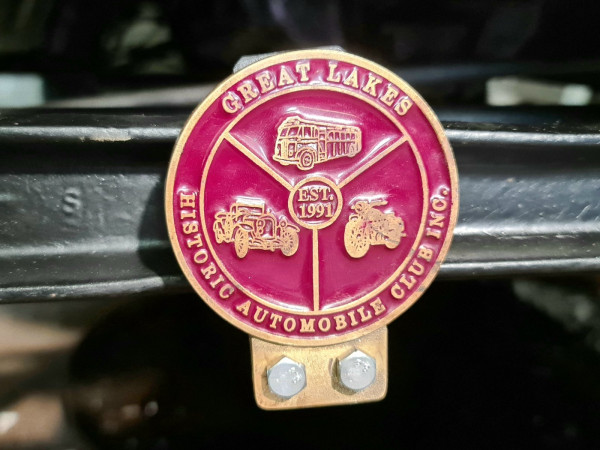

Added a new badge to the front axle. Funny story behind it, the Great Lakes HistoricAutomobile Club, of which i am Vice Presiden, is locatedin Australia. While browsing online to see what had been posted about the club, I came across this badge from around the time of the club's inauguration— and the item location? England! ... Neither me nor the seller could work out how it found its way to the UK :D

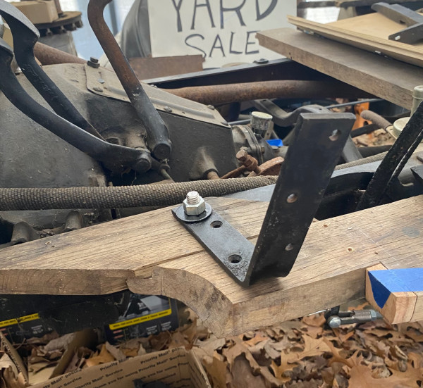

Fitting top bows on my 1912 Roadster.

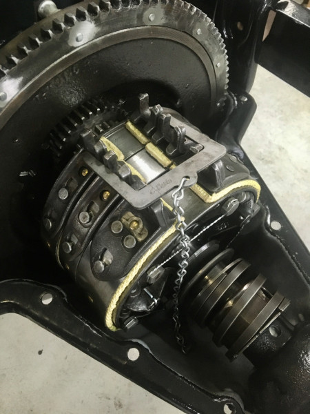

Relining transmission bands! Took the opportunity to go through the process with my daughter. It being both our first time doing this, we spent time researching and planning out the job. It appears to have worked out great. This will coincide with her automotive service badge for her American Heritage girls troop. Learning about auto maintenance and engine and drivetrain principles I figure why not work on a Model T!
Bryant

Jones in Aiken SC wrote:
Fri Apr 04, 2025 2:03 pm
IMG_1638.jpgFitting top bows on my 1912 Roadster.
Can you do mine next? You've got all that practice!

I bought a set of bows from Snyders where the ends were already formed, meaning tapered and grooved. Took some sanding and fitting but it beat carving the ends from a chunk of lumber. So I cheated and saved myself the aggravation of wood carving, which I ain't too good at. I am a welder/metal worker hobbyist, not a wood guy.

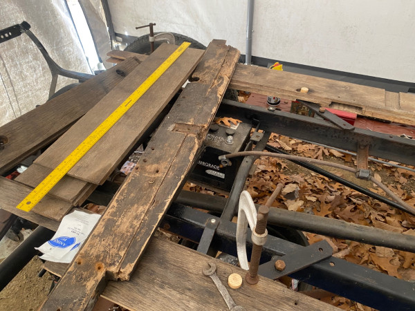

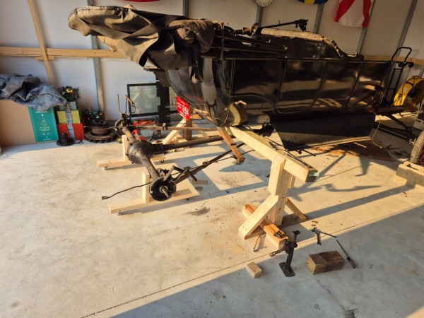

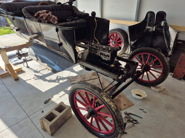

I hadnt really wanted to take Daisy all the way down, but given the rebuild of the rear as well as the tranny, the tear down began yesterday. As good as the top side paint is on the fenders/running boards, the undersides however are pocked with lots of small rust bubbles. Given coastal salt air, that just spells trouble. So, everything's coming off at this point to be stripped & repainted, and will also lift the body off so I can do the frame as well. Surprisingly the body is in excellent shape, and will probably leave it alone other than some minor touch up....will see.
Daisy Mae
Posts: 529
First Name: Kurt
Last Name: Andersson
Board Member Since: 2024
Re: What have you done with your Model T in April
Post by Daisy Mae » Thu Apr 10, 2025 7:16 pm

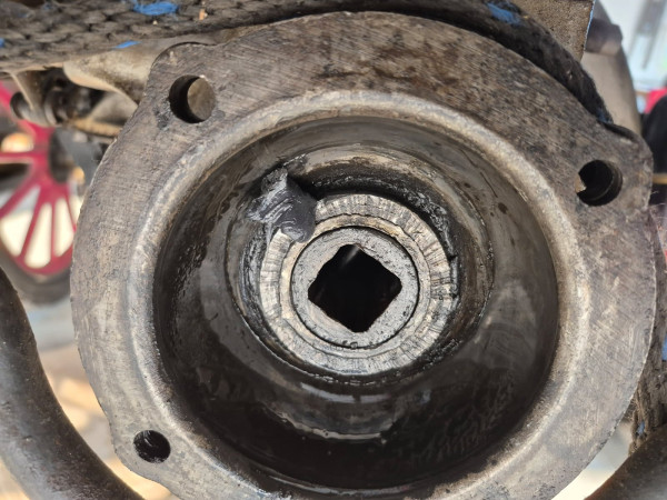

Pulled the axle today. I don't even need to disassemble the thing to know the driveshaft thrust bearing is shot, simply looking at how chewed up the face of the 4th bearing is!!

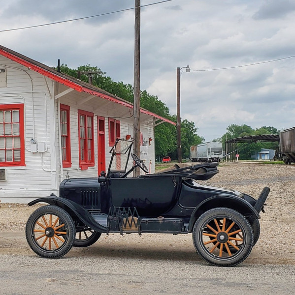

Post by KurtM » Mon Apr 28, 2025 9:48 am
My '23 Runabout evidently craved fiber in his diet and tried to eat his timing gear. Replaced it with an aluminum one to discourage gnawing on himself.
Overhauled coil box with plastic parts kit primarily to cure chronic ill-fitting coil box lid problem. It worked perfectly - hooray!
Last picture taken yesterday in Gonzales, Texas while on a 72 mile Sunday lunch run.

Post by Jerry VanOoteghem » Tue Apr 29, 2025 6:26 am
Be sure to remove the crankcase inspection cover to remove all of the shredded gears bits that you can. Change the oil too. I had a broken off gear tooth that found its way into my oil tube funnel. The result was a ruined front main bearing.

I had a noise in the differential in my ‘24 Touring that irritated me so late this winter, I pulled it out and took it to a good friend’s shop to troubleshoot it. It didn’t take long for him to see the ring & pinion gears were shot. I ordered new parts and soon had it back together, and a couple days ago my neighbor came over and helped me reinstall it. I can’t wait to take the Henry T out for a spring drive without any wierd noises. Here’s to another year of great touring!
