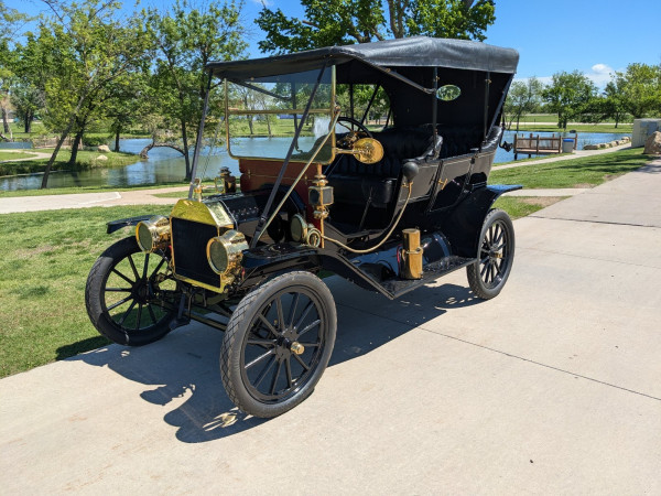

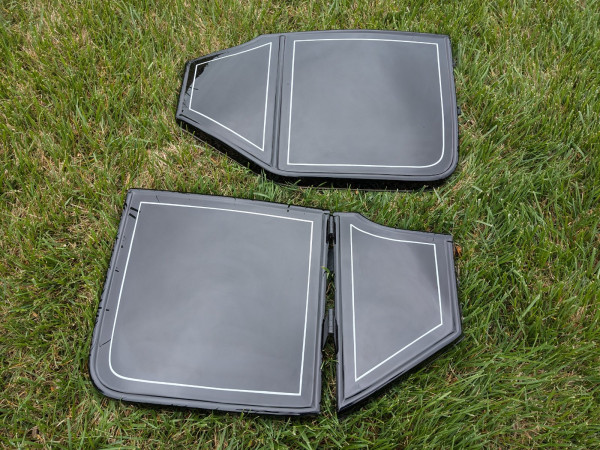

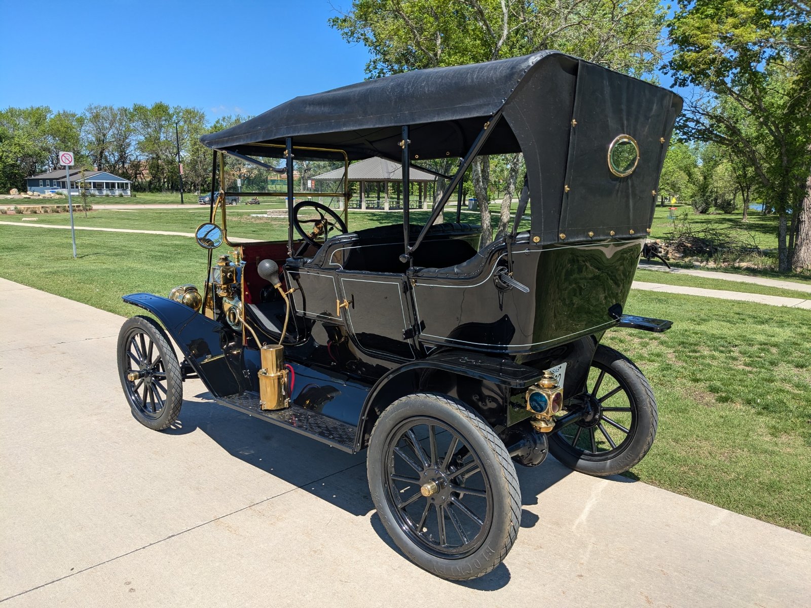

This week I finally added the factory pinstriping to the late 1911 touring car that I finished restoring in November 2022. A big thanks to Keith Townsend for providing pictures of the pinstriping on his car based on his research into proper striping that the factory did at that time.
I took it out for a drive today, but it appears that the pinstriping didn't make the car go any faster! :)

Beautiful car. Nice to see a hood striped correctly. Should go faster with the fore doors on.

So you're saying that you didn't pony up for the "high performance" pinstriping paint and now you are regretting it.

Neal, to go faster the pinstripe needs to be RED. If you used tape, it will be easy to replace. :D :D

Does anyone know what the correct angle for the rear top bow and back curtain is? Women often wore huge hats in those days, and I'd think that having the rear bow and back curtain leaned farther back would better accommodate them.

The angle of the reat curtain follows the trajectory of the back of the seat on the outside of the body.

That appears to be the case with the original 1910 car.

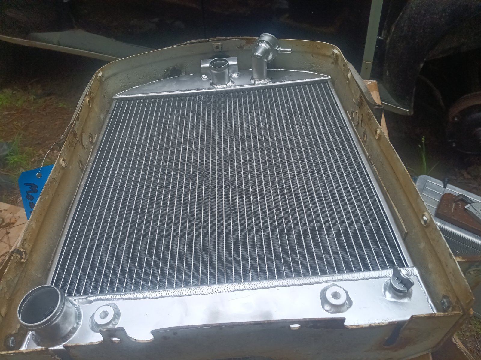

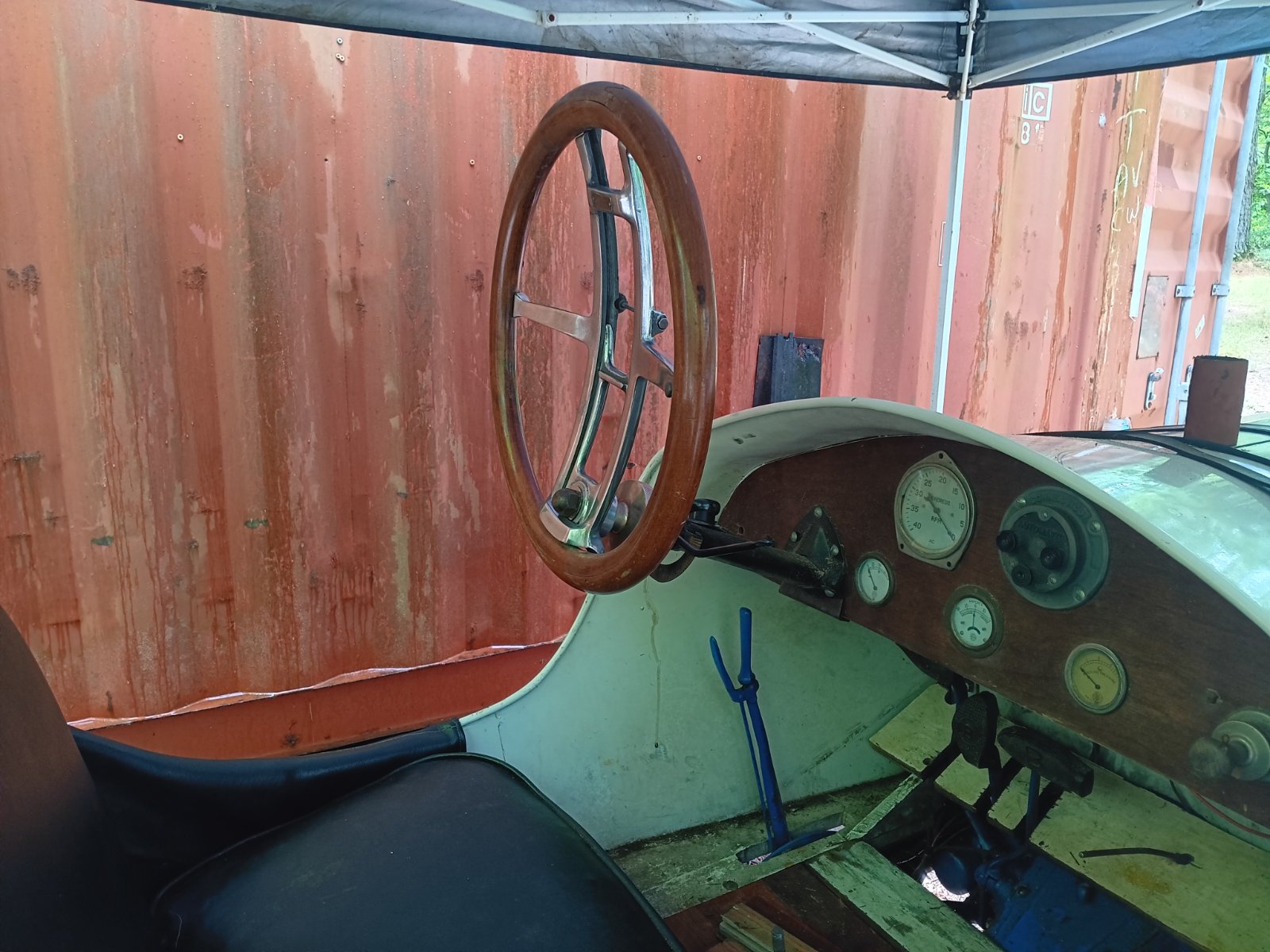

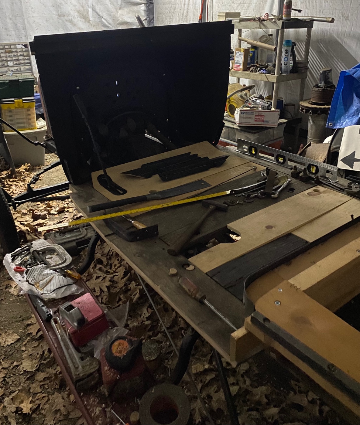

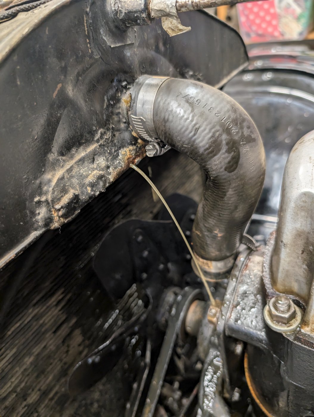

Post by babychadwick » Mon May 12, 2025 7:42 am

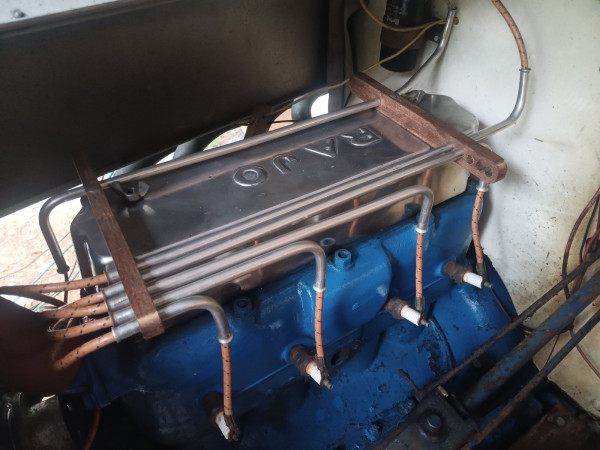

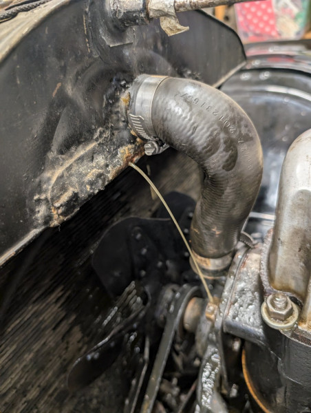

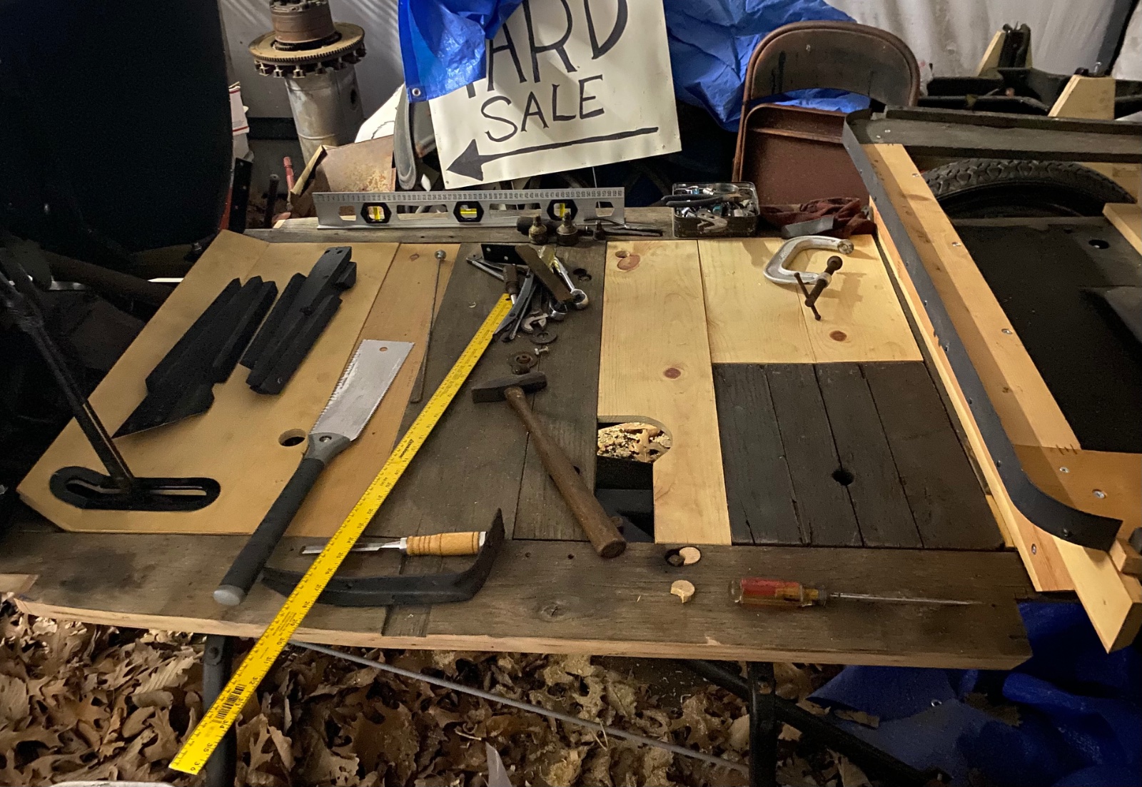

So far working on replacing the radiator after 40 plus years. It's been a problem from day 1.
Cleanup on the motor including wiring and valve cover sanding and polish.
New adapter made for carb upgrade from model A to Winfield.
Seat torn out and new padding/wood installed
Rotted plywood floor replaced with new hardwood, making room for better storage.
New steering wheel found (neville), adapter started.
Distributor, ruxtel work coming soon.

Post by babychadwick » Thu May 15, 2025 6:43 am

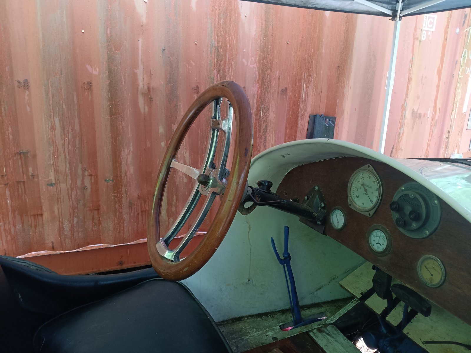

Fitting a new wheel, made up the adapter and she fits beautifully. The original was a T bent out so the neville is a near perfect swap.
When getting in and dropping it into place it just feel "right" like you are ready to go racing.

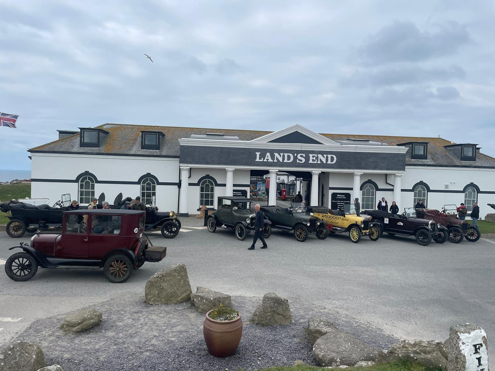

We joined the 2025 Round Britain Tour - celebrating the centenary of Ford taking the 250,000th British built Ford on a similar tour.
We joined at Bridgwater and travelled to Lands End, then back to Somerset. About 450 miles for us, but the core group of 5 Ts did 2717 miles all round Britain. About 100 cars joined for some part of the route. A great event

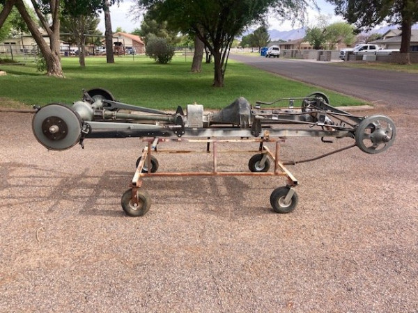

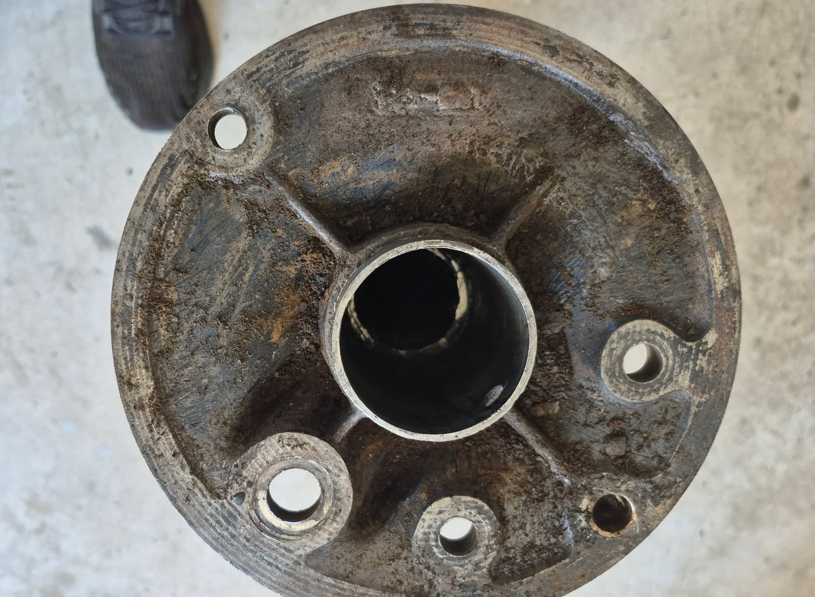

I feel like a dentist cleaning the axle halves...
Between 111 years of paint, dirt, grease & rust on the backing plate, all hardened into a plaque....
Screw driver scraping...
Degreaser soaking...
Rust remover soaking...
Dental picks...
Wire wheel...
Been a process, this was about the halfway mark...

Kirt, Be sure to check for straightness of the tubes and straighten them out before you re-assemble the axle. When it is all together the axles should be centered in the outside bearing. If it is not straight, it is much easier to break an axle. After it is installed in the car do not jack up in the center but place the jack near the backing plate. Also when you tie it on a trailer do not pull against the center of the axle but place your tie downs hear the backing plates.

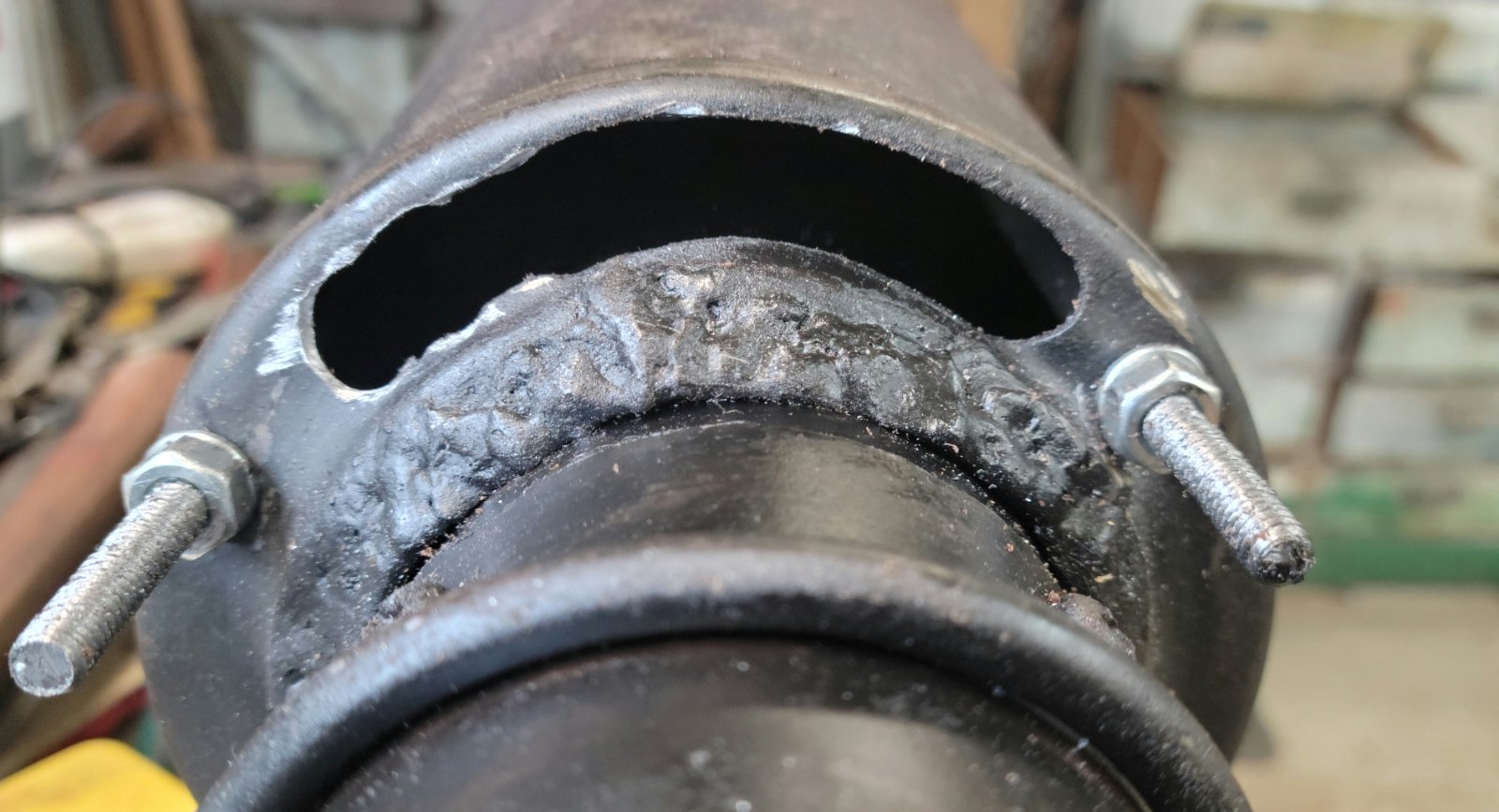

Post by KWTownsend » Fri May 16, 2025 12:33 am

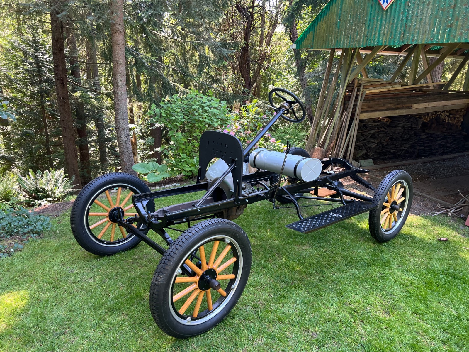

I modified my shop-built Wheeler Combination Muffler so it breaths a little more freely.
Before:
After:

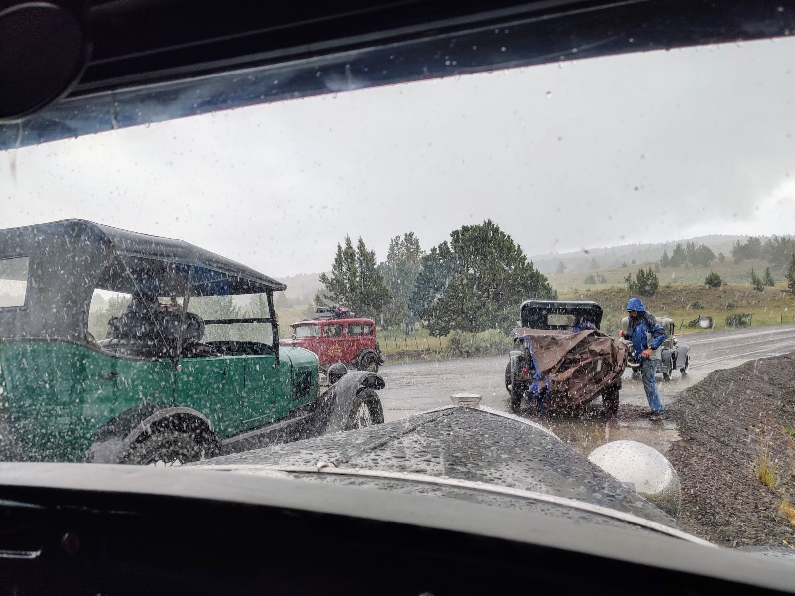

Last Saturday we went for a annual spring drive, it is about a 100 mile loop that is all but 4 miles on backroads and over 40 miles of dirt and gravel. Most years the weather is really nice, however this was not most years. While we did have some sunshine it was mostly cloudy and lots of rain at times that made for quite a bit of mud. One of the group this time was a local youtuber that rescued some of us a couple of years ago, he will have a video on his channel soon @ Casey LaDelle we had a good time whether we enjoyed it or not, it is always fun to get out in the old cars.

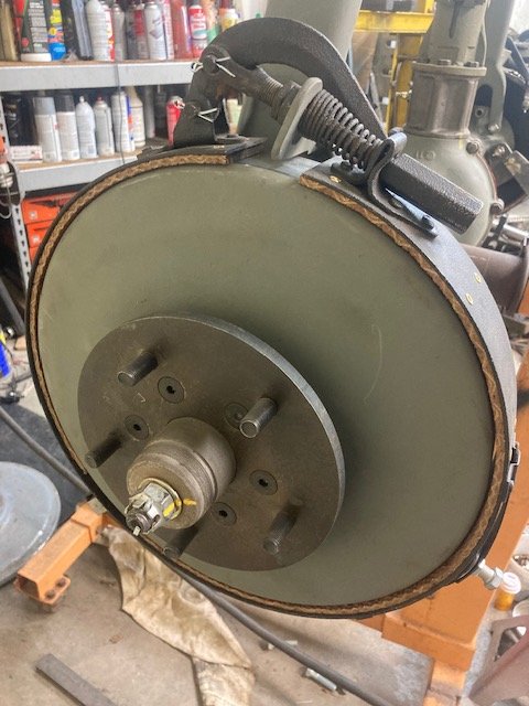

Sun Country Model T Club had a great tour on May 3. Thanks Monte & everyone that helped with planning. This was Monte's first time planning a
tour. Hope it's not the last. Finished the speedster stoppers a combination of Studebakers? & Dodge? parts. Much bigger than Rockies & they self
energize 60% forward & 40% backward.
Craig.

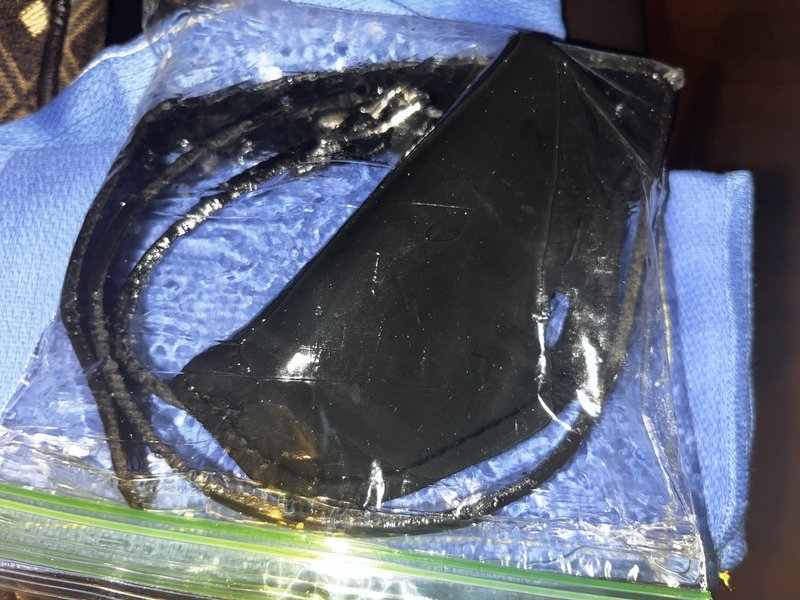

I replaced a sheared off crank dipper, I learned I need to lube my slapper timer so I used dow 33.
I have successfully started my car with the crank two times now and she fires up with very little effort.
The leather crank holder thing is in very good shape and no cracking, but it is very dry so I cleaned it and doused the holy carp out of it in liquid “mink oil”
I need to get more of the lard type and more saddle soap.

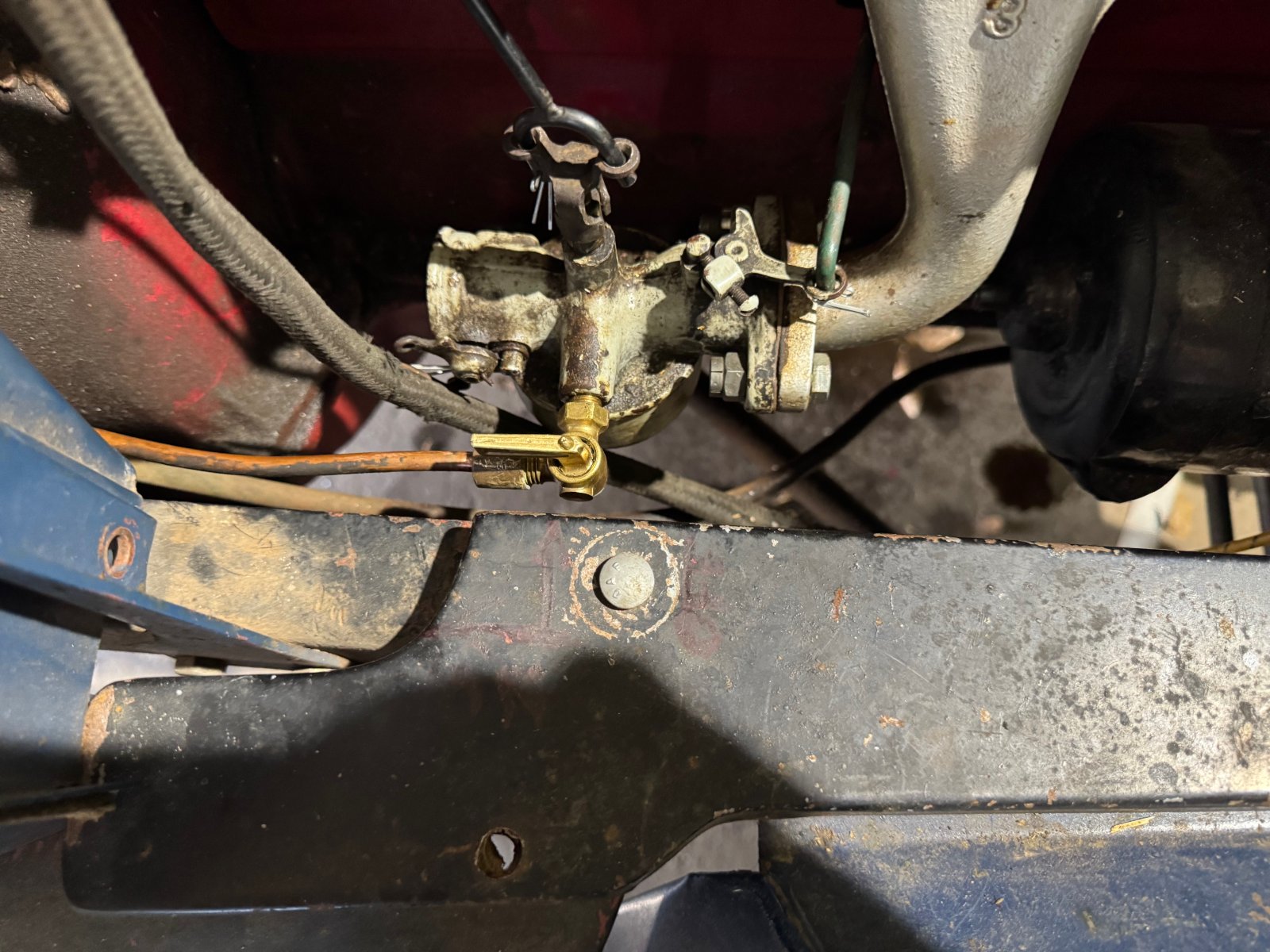

Space City T's of Houston club members helped another club member get his '23 T truck on the road.
Found out that the fuel valve only works in one position shown.

Finely got far enough along that it looks like I'm actually accomplishing something on my next speedster. Engine, trans & Warford have been done
for quite some time.

Craig,
Is that for driving in Australia?

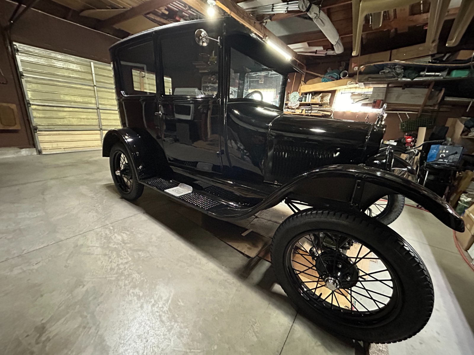

Post by Shrshot » Thu May 29, 2025 9:11 pm
Got the 'ol girl back together this weekend. Rebuilt the rear axle/driveshaft, added AC brakes, wire wheels and new tires, foot throttle, starter solenoid, adjust bands and oil change. Hoped to have it done by early spring. Health issues took me longer than I anticipated. Ran her on jack stands last night, everything sounded good. Next step, take her out for a road test.

Post by weto » Fri May 30, 2025 8:40 pm
Found out Grandpa's ~50 year old solder job finally gave up.
Probably in the market for a new Rad, but since he put a custom milled down chevy water pump which has its inlet (radiator outlet) on the passenger side I don't have the heart to buy a new radiator then immediately torch it up. Local shop said they would be willing to patch it but it'll probably leak somewhere else.
Time to do some figuring I suppose. Maybe just go to a standard water pump. But not really sure how that'd work as the engine has a model A crank, a model A camshaft modernish (50' tractor I think) distributor and a Frontenac head with a standard water pump? (or even without a water pump?), figure they did it for a reason all those years ago. I definitely love the Frankenstein ingenuity, even if it give me headaches.

Post by TXGOAT2 » Sun Jun 01, 2025 8:48 am
Re: radiator leak... That leak can probably be re-soldered and hold for another 50 years. I'd get a new hose and trim it up so as to avoid any strain on the radiator tank.

Post by mtntee20 » Sun Jun 01, 2025 5:07 pm
DO NOT LET THEM PRESSURE TEST YOUR RADIATOR. They love to do that to see if their repair will hold. BUT, pressure testing an 0 psi radiator WILL result in a failure NOBODY wants to see.
Good Luck

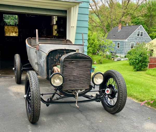

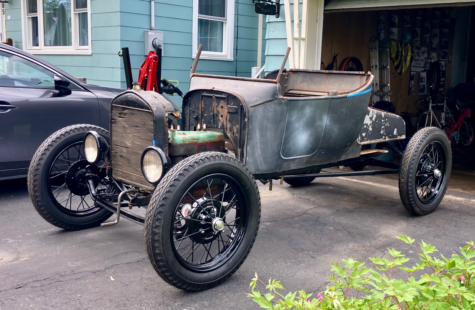

Mocked up my a powered t roadster a little more. It’s nearly 50/50 model a and model t. Model a engine and trans. Model t rear axle. Model a front axle and steering box.
