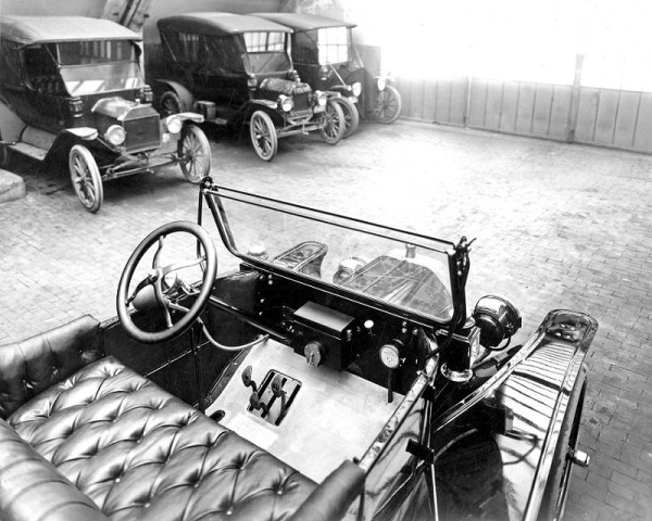

For whatever it is worth? The angle of the photo does not clearly show the profile of the steering wheel nut? However, zooming into the photo, it looks to me like this 1914 interior photo might be the high crown style? Steel or brass is anybody's guess.

To my bum eyesight, the car in the photo above seems to have a high crown nut . . .
