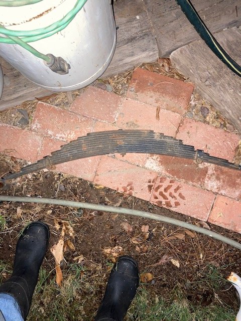

I'm one of the last people to ask about originality on Model T's but this is the front spring from a TT chassis I purchased some years ago.
Note that two leaf's are doubled up, it's 11 leaf's if you remove the doubled ones it's 9 leaf's.
