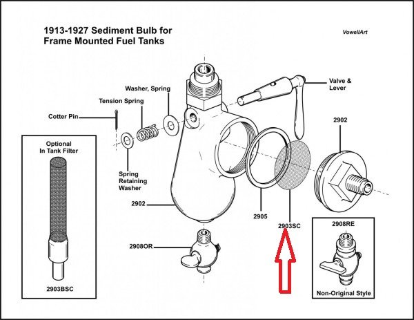

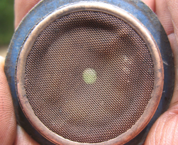

You do have a filter. When you de-solder it you might notice a very narrow edge of cap was rolled over the screen then soldered. Save time just use RTV to hold it in place
