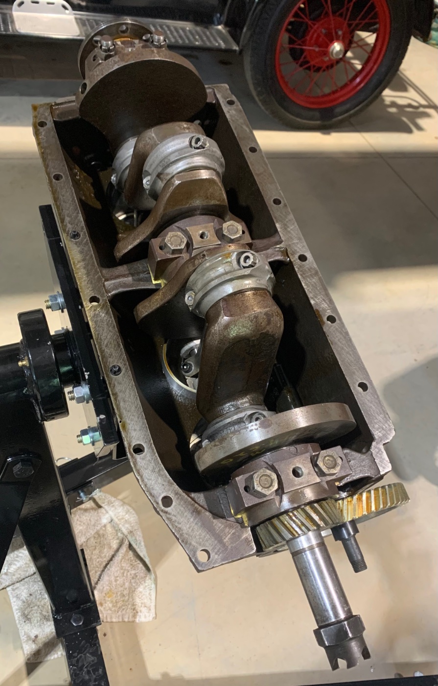

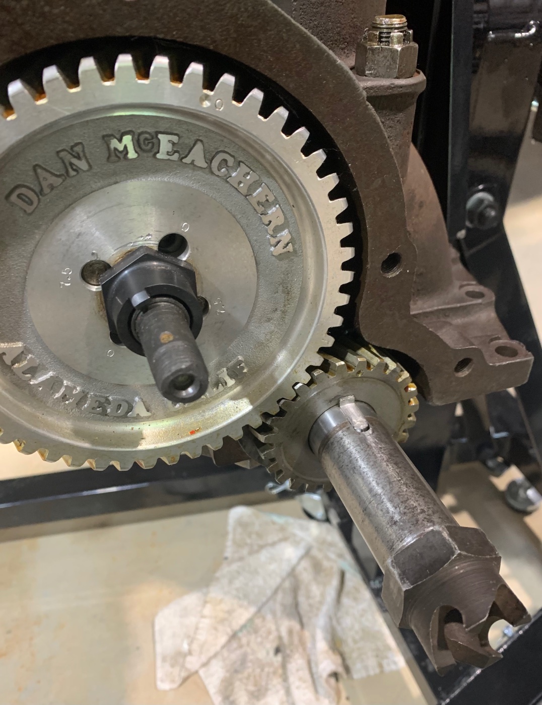

I was just getting ready for a similar question. Brent asked about the T pulley in his first post.
My new C crank block already has the timing gear installed.
Timing gears on A crank
Crank in block
Crank in block

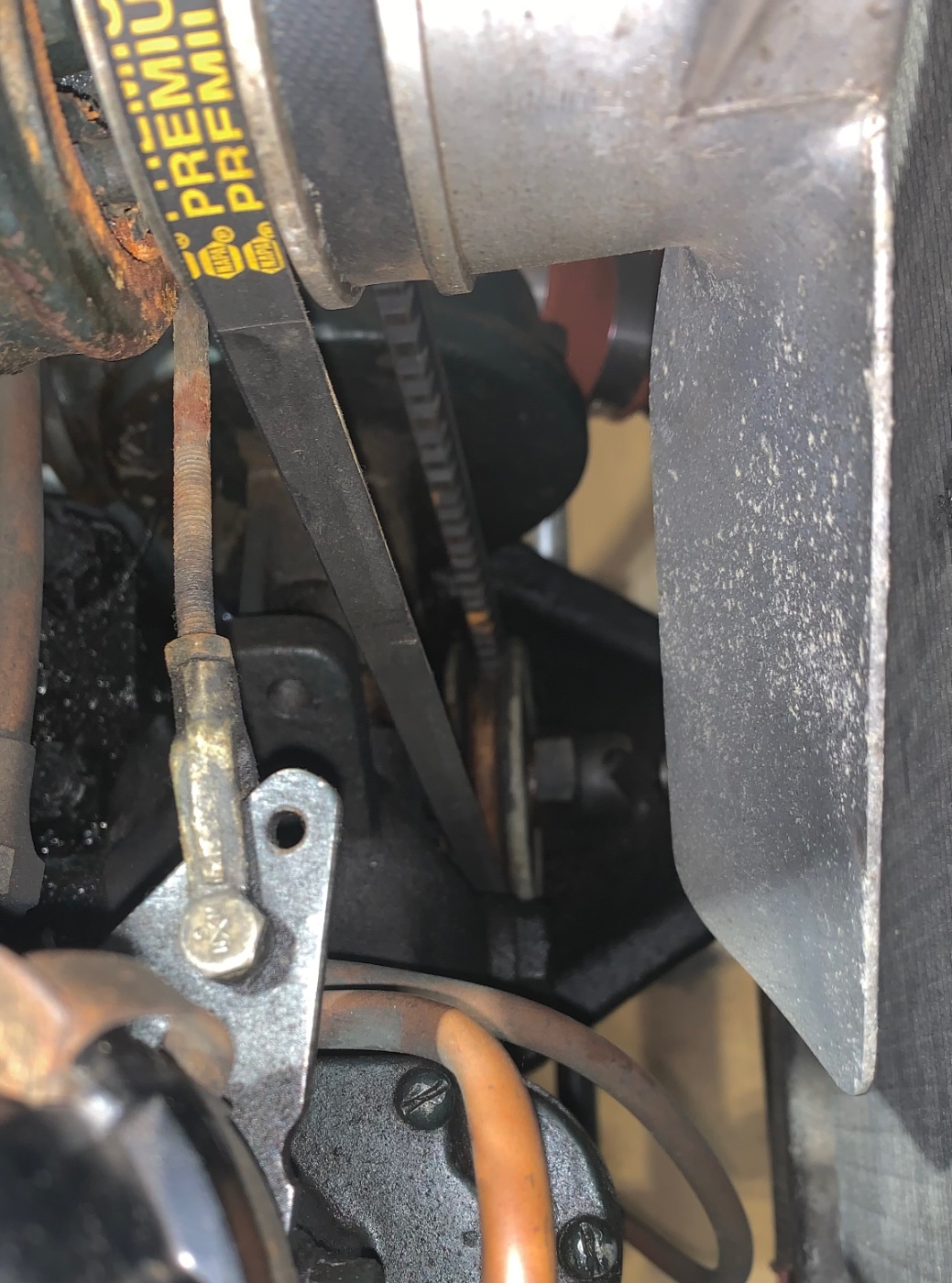

With no hole for a “T” pulley for a wide belt. My ‘27 runabout with a Rajo and A crank, the pulley is for a V-belt. Do most A crank T engines use a regular A crank pulley like this?
‘27 runabout, front of engine
Posts: 5598
First Name: Henry
Last Name: Lee
Location: South Pittsburg, TN
Re: Model-A Crankshaft Conversion Machinist
Post by Henry K. Lee » Sun May 04, 2025 2:48 pm
I always drill mine to accommodate a T pulley. Normally I build my own set of pulleys to either a 4L or 3L size depending on accessories.
