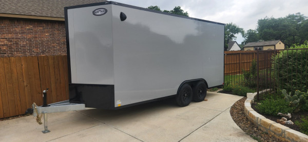

Enclosed Trailer Construction:
Size: 8.5 ft by 18’ (box) Enclosed Car Hauler, Ceiling Height = 8 foot
Coffin Front or V Nose?
5200 Pound Torsion Tandem Spread Axles
16-inch ST Radial Tires rated at 12 Ply with Highway tread
Four Wheel Brakes
Roof, sidewall and floor all 16” on center
¼” minimum thick x 6-inch minimum full tube construction full perimeter frame with sidewalls built on the frame.
Full welds
One piece roof with no roof vents or skylights
Adjustable sidewall vents at front and rear of trailer, Four minimum
Minimum 0.30-inch aluminum exterior siding attached at every side structural member with screws.
Center tube from tip of extended minimum 36-inch trailer tongue to first axle
Removable adjustable bulldog coupler in 4” channel rated at 12K minimum. 2 5/16” ball
¾ inch treated plywood floor screwed to each floor crossmember at 12” minimum intervals
No D Rings- Install surface mount Etrac at custom intervals
Minimum 88-inch door clearance at rear door (this will accommodate an early car with
36” wide x 72” tall flush mount door, hinge n the front side of trailer and lock side on the rear placed at least one foot in front of the interior trailer wheel well box.
Fold out steps centered under door with grab handle on the inside and outside.
Junction box at tongue separate from batter box for 12 VDC breakaway battery at tongue.
30-amp 12VDC charge line ran to inside front of trailer to charge12VDC battery at front of trailer (for winch)
Floor mounted Winch at center front of trailer
12 VDC LED trailer lights at interior of side walls to adequately light the interior at night, feed from 12VDC battery at front of trailer.
Trailer light switch at rear & front door.
Exterior LED combination clearance and hazard and turn signal lights at fender wells
Rear adjustable 12 VDC flood lights installed on either side of rear door controlled by switch at doors.

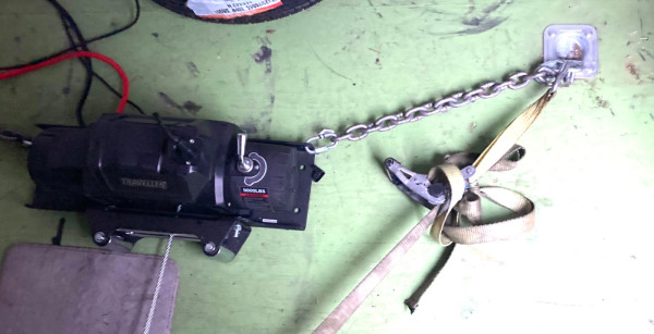

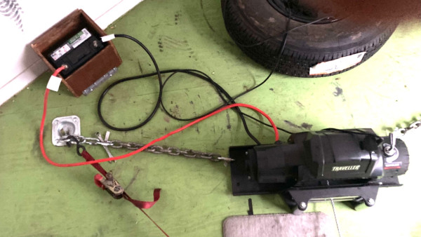

Hi George. Thanks for the comments. I was thinking of having a winch installed by the manufacturer of the trailer, that way they could control the way it mounted to the floor from the get-go. What do you think of the coffin front verses the v-nose? Do you think an 18 is plenty big enough and that a 20 might be too much?

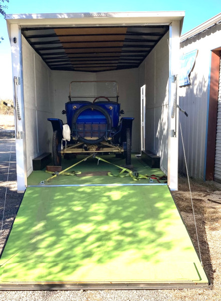

Well, I have an 18’ box with a V nose. That’ll give you an extra 2’ to build a shelf or storage. I don’t know if fuel consumption is less but it makes me feel like it :lol:
Your length, height and width is like mine so you can carry a TT or a ‘09 touring with top up.

I have one V nose trailer and one coffin nose trailer and if there is any difference in mileage I don’t see it. If you go with the V nose make sure the tongue length allows enough clearance to drop the tailgate or hatch back on your tow vehicle. The extra space you get in the V extends over the tongue reducing the space between the front of the trailer and the coupler . The hatch on my Suburban cleared it but the hatch on my Expedition did not.

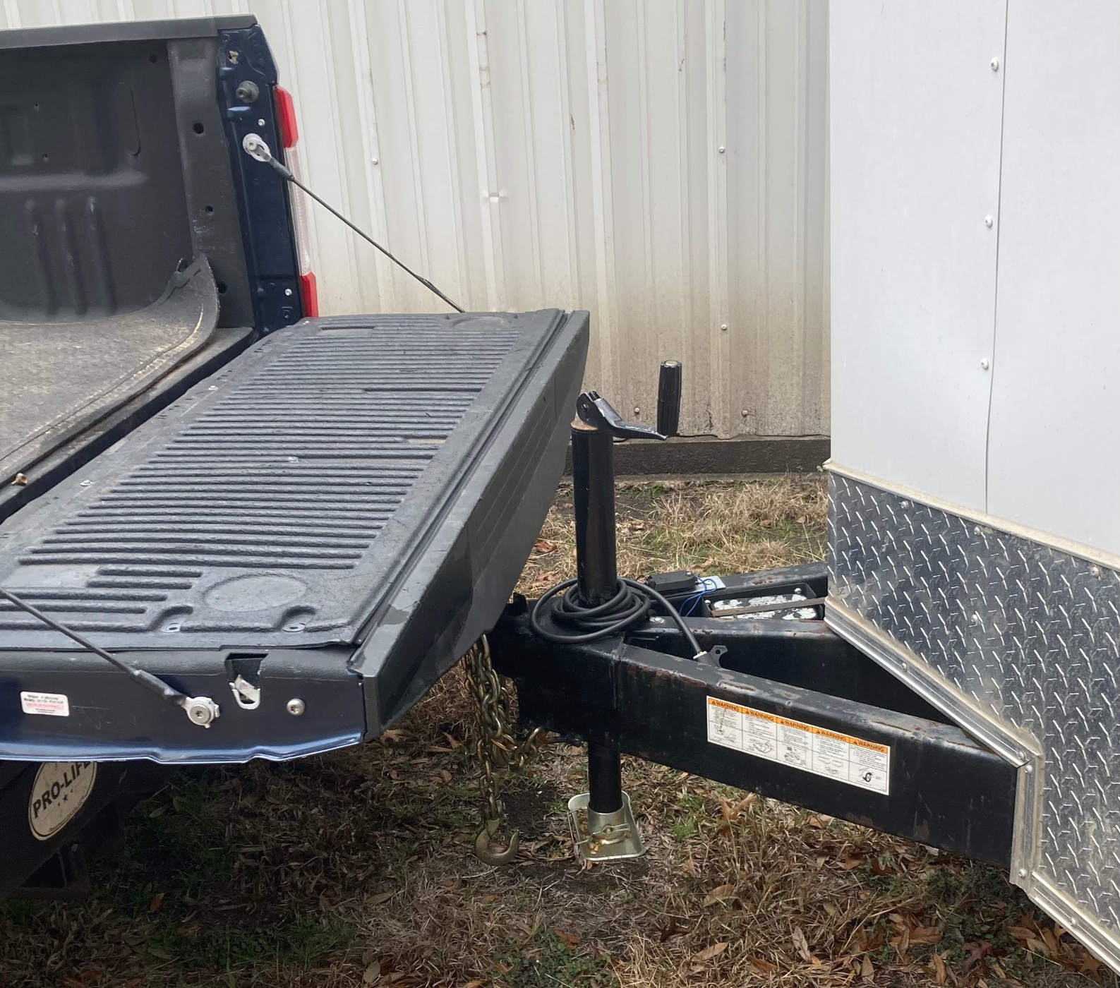

Thank you Russ for pointing out about the tailgate clearance. That is very important and may have saved a lot of trouble.

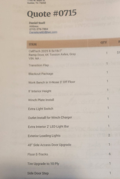

Thanks but I was looking for George’s to see what he purchased for about $10k. I’m thinking of a trailer for occasional use but not looking to spend $20k. Just for personal, occasional use to take my T places for rides.
Would also like to see what your spec and quote is.

Jim, I bought my T Rex trailer from Lone Star trailers in Lacy-Lakeview north of Waco, TX. I’ll go get the specs for you and post later, but want to say something about John Codman’s trailer description. DO NOT buy a 7’ wide trailer if you want to haul a ‘26-‘27 T ! I had a 7 X 14 V nose and enjoyed hauling my ‘19 centerdoor and ‘14 runabout in it with the top up. But when I drove my ‘26 Tudor in….. I was trapped in the sedan!!….my research revealed trailers came in 14,16 and 20’ + lengths. I rightly figured the shortest that would also allow a TT is 18’ so that became part of my specs…. more later…

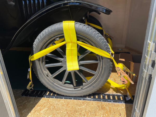

Daniel, I would seriously consider NOT using a bolt on tongue hitch of any kind.
IF YOU can take it off, So CAN THIEVES. It might be OK if you use some type of unique nuts and bolts to mount the hitch that thieves would not have a tool for.
GET A QUALITY TONGUE LOCK AND QUALITY LOCKS. Get a tongue lock that completely encases the tongue and it's mounting hardware.
I have and like PAC Locks. If you purchase one special model line, YOU can re-pin the locks so they all use the SAME key. I did and I'm so happy I have just one key for all my locks.

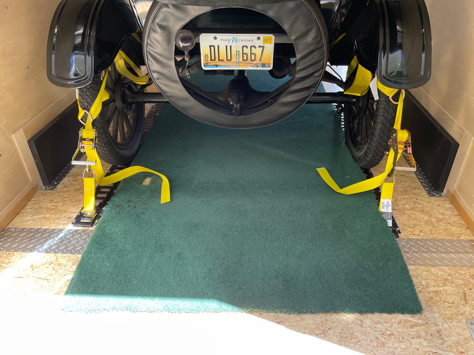

Just one comment, Stiffer springs is not necessarily a good idea. Put a light car in the trailer with >10,000 total spring rate will bounce the car badly. Add the trailer weight + the heaviest car that you plan to transport and size the spring rate with that info. I had a friend with an enclosed 20" trailer with 6000# axles that damaged a fully restored 1904 Stanley Steamer transporting it to Hershey Pa from New England. He asked his father in law to go 3 miles down the road with him riding in the Stanley. It scared the crap out of him. He changed out the springs to 3500# springs
SurfCityGene
Posts: 681
First Name: Gene
Last Name: Carrothers
Re: Enclosed Trailer Options
Post by SurfCityGene » Mon Jan 13, 2025 6:15 pm
I bought my tall trailer used and already built so no choices to start. Have done several long hauls with the Torpedo and others and have these couple of comments to add.
I will never have another 7' wide trailer! I would certainly recommend very strongly that you consider an access door on Each side. For just a few bucks more you'll be very happy and thankful when you travel and end up in tight locations and parking spots.
I second the tip about over weight springs..

mtntee20 wrote:
Mon Jan 13, 2025 1:51 pm
I have a 2" receiver on one car and another on my pickup truck. They both bolt to their respective vehicles, but I doubt seriously that potential thieves would go to the time and trouble to remove the receivers. Even if they did unbolt them (a major PITA on either vehicle), they still can't tow the trailer because the hitch receiver would still be hanging on to the ball on the trailer. The removable part of the receiver (the ball) is clipped to the main part of the receiver with a serious locking pin and of course the trailer hitch is secured by a Heavy duty padlock.
I realize that the locks are there to keep honest people honest - you can't stop a professional unless you guard the trailer 24/7 with a shotgun. If I'm on the road overnight, I always back the rear door up against something solid and as unremovable as possible.

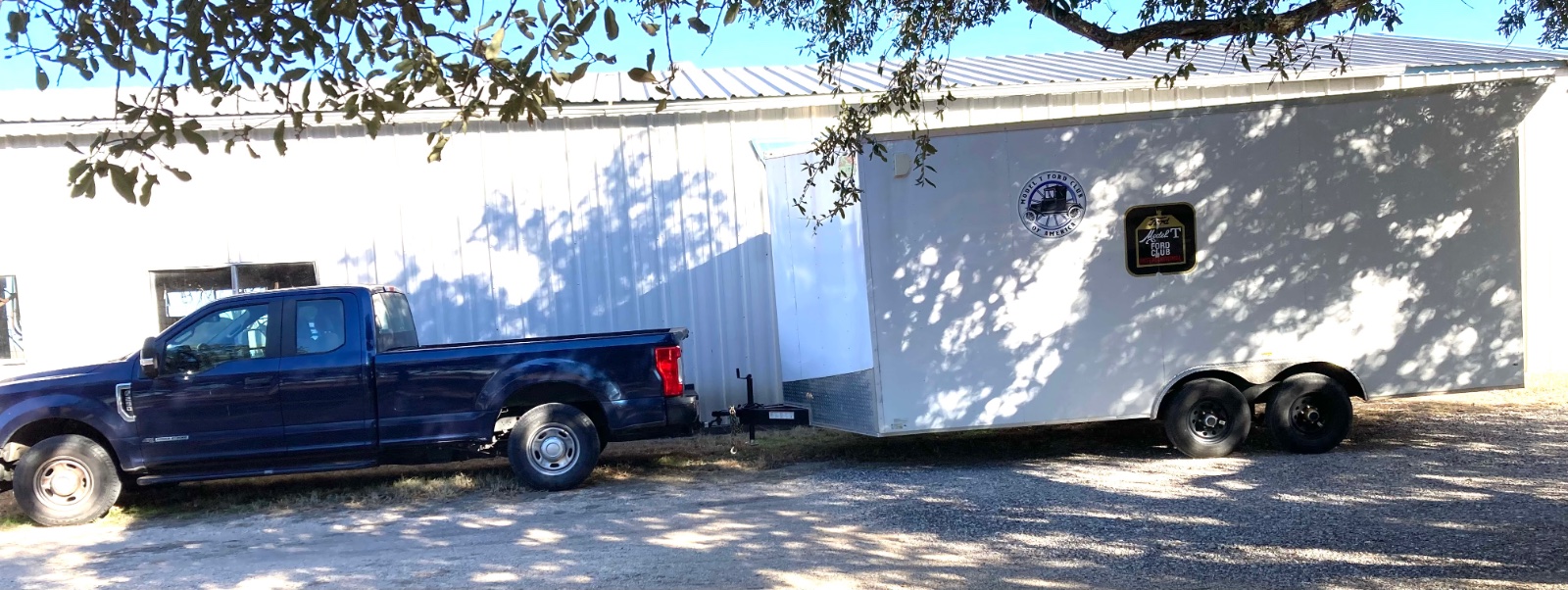

Sorry for the delay. Trailer box is 18’ long w/ 2’ V nose. Interior box is 8’ X 8’. Two 3500 lb axles w/ 15” trailer tires ( they’ll add free spare ), 7’10” inside door. Walk in door on the right side locks from w/in or outside. 4 D rings fastens everything I carry. 1 tiny light center ceiling I’ve never used. Trailer is loaded to transport to Hupp 20 mechanic. Centerdoor is 6’6” tall and TT C Cab is 6’10”.
And it has tail lights, brake lights, turn signals, running lights all around top and bottom. Lastly, 2 wheel brakes
Want a photo of TSC winch fastened to trailer that cost $24 ?

Post by SurveyKing » Sun Jan 26, 2025 10:21 am
Thanks for posting that photo and info on your trailer. That is about what I am looking for. Who is the manufacturer. Does the trailer hitch crank get in the way of the tailgate when dropped?

Post by George House » Sun Jan 26, 2025 4:36 pm
T Rex Trailers out of Corsicana. Tailgate clears crank handle but don’t turn truck with tailgate down
I have a good understanding from your previous post, but when you get a chance a picture would be appreciated. Thanks.
Posts: 2900
Last Name: House
Post by George House » Mon Jan 27, 2025 8:58 am
Sure Jim,
I’ve attached 2’ length of chain to both ends of the winch and fastened the other ends to the frame-grounded Forward D rings. The winch cable is currently taut to a Hupp front axle along with 2 nylon straps.

Some of you have recommended that when installing E-Tracs in the floor that they be placed inside the wheels to allow straps to hold the front and rear axles down close to the wheels. In measuring, I come up with 40 inches between the e-tracs. Does anyone have any input upon the position of E-Tracs in the floor of enclosed trailers? It would be great if you could reply here for the sake of anyone considering this,
Posts: 5347
Post by RajoRacer » Tue Feb 04, 2025 1:29 pm
I have my E-Trak located in the tire/wheel tracking & use wheel nets.
mbowen
Posts: 440
First Name: Miles
Last Name: Bowen
Location: Brighton, MI
Post by mbowen » Wed Feb 05, 2025 11:27 am
Same here.
Miles
1924 Touring “Bonnie”
1925 Express Wagon “Clyde”
SurveyKing
Posts: 504
Joined: Thu Jan 10, 2019 8:36 am
First Name: Daniel
Last Name: Snell
* REQUIRED* Type and Year of Model Ts owned: 1909 Touring, 1924 Touring, 1925 Roadster Pickup, 1921 Touring
Location: Boerne, Texas
Board Member Since: 2014
Post by SurveyKing » Tue Feb 11, 2025 11:40 am
Thanks Miles for those pics. If anyone else has any ideas that are different please post here. I would like to see the wheel nets or anything else.

Post by SurveyKing » Sat Apr 19, 2025 12:43 pm
Ok guys, I wanted to let those that responded to this post, and anyone else interested about Enclosed Trailer Options of my decision thanks to the tons of advice you provided together with my personal research into Trailer options. I ended up purchasing a Celltech Trailer built to the attached specs in Waco, Texas. It was a bit expensive but very well built and should hold its value. It does not use wood of any kind. The walls are all molded, check out their website to know more about the construction. Size I chose was 18 foot by 8.5 foot by 8 foot interior height. The e-tracs on the floor are 58 inches apart to accommodate the tire tracks.
