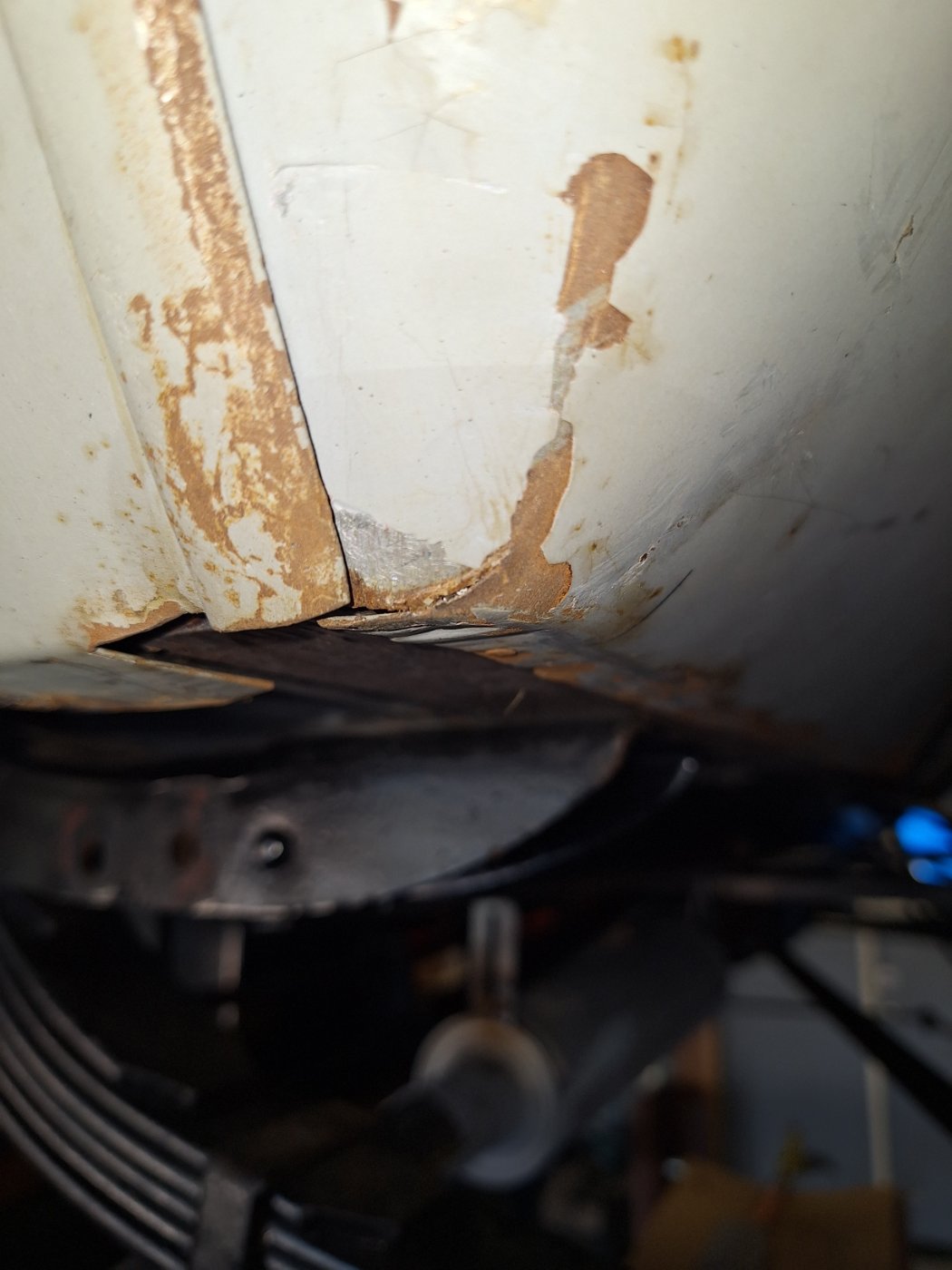

What is the latest and greatest method to weld up a Crack on this 100year old 20 gauge? Might, Tig, Gas...?

Jeff, post a pic of the crack.

TIG welding using a copper back plate with multiple cool cycles and doing pearls instead of a continuous weld.

Thank you. I have the copper, and a Tig guy.
