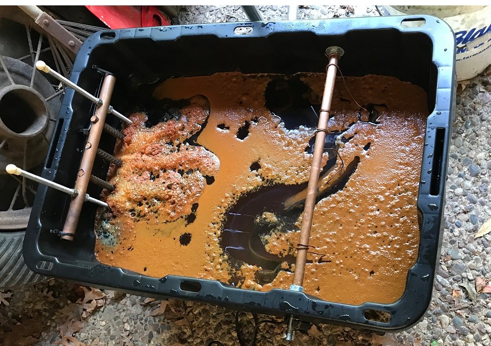

- Posts: 6588
Re: Rust removal solution
One other method not mentioned is electrolysis. Claimed to get at the internal rust. Made one to free up a frozen door latch & it freed it up!
Good instructions at this site https://www.instructables.com/Electroly ... aka-Magic/

I will try washing soda, I used sodium bicarbonate used to lower the pH in swimming pools and it eats at brass.
One trick I used was to take a piece of plastic pipe and drill a lot of 1/4 to 3/8's holes in it. Then put your rebar inside it with the wire you are going to connect to the positive terminal of your battery charger coming out the top. By doing this you have eliminated the chance of your your item you are cleaning coming in contact with your sacrificial piece.
